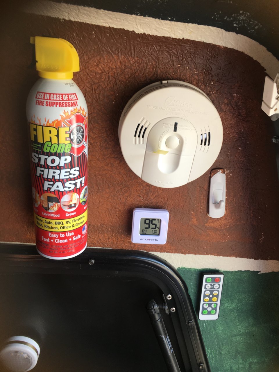

    C2354A2D-20B7-4099-A19A-1AFC15B16C99.jpg I greased up my whole driveshaft & velcro my light remote in my camper oh and I washed it and polished it:)
