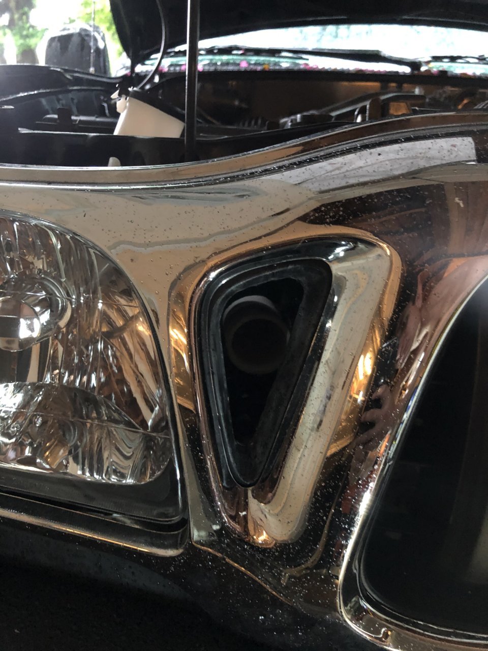

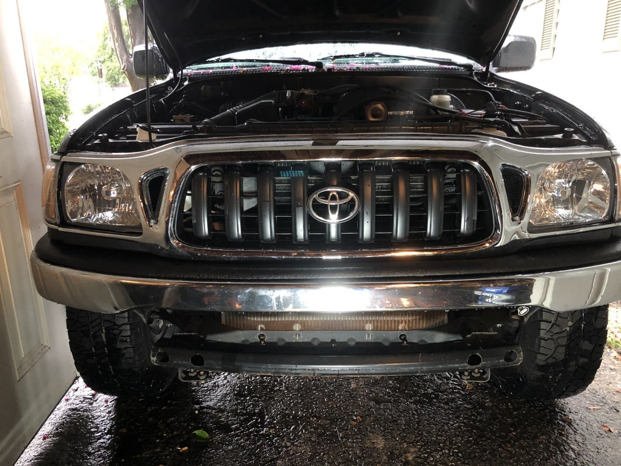

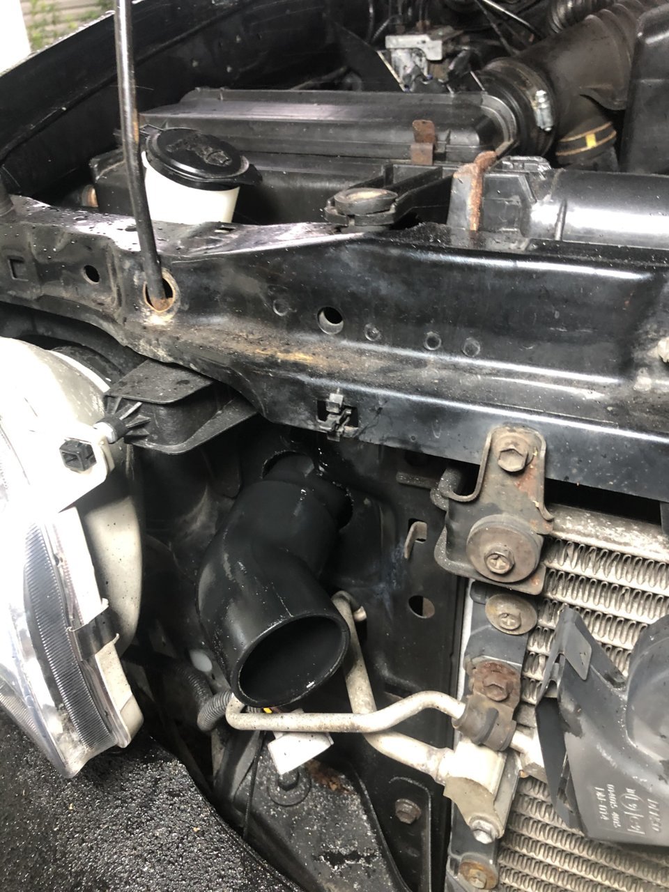

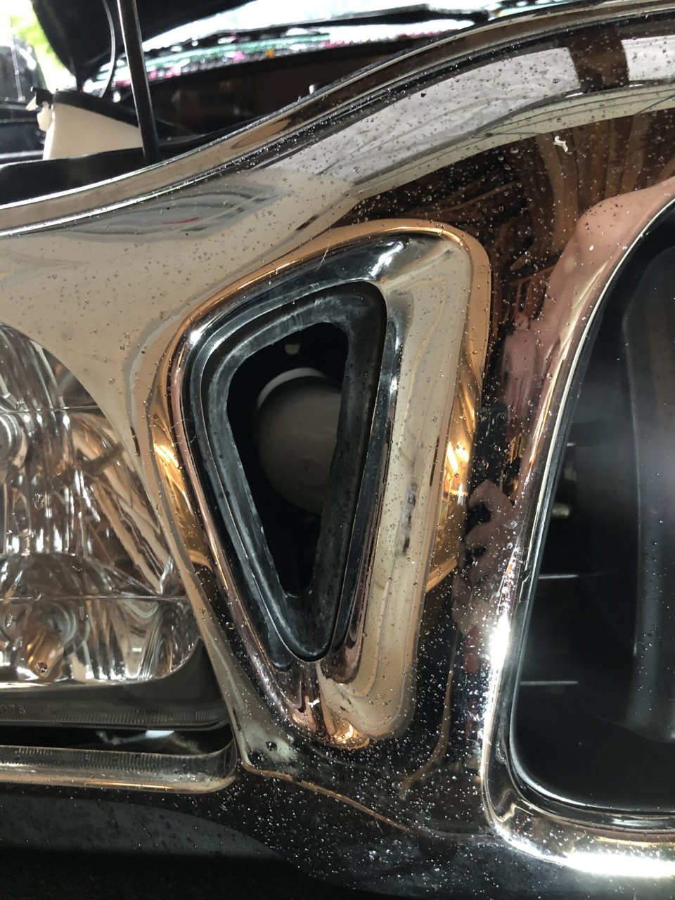

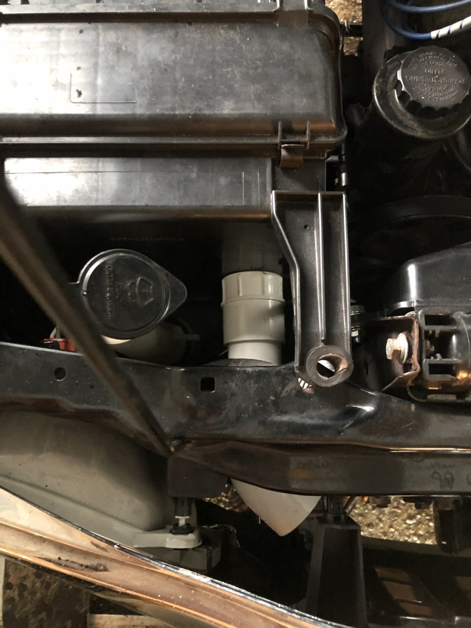

    So fun little project today. I’ve never been a fan of the deck plate mod. Given it opens up the box to engine heat. But I’ve been contemplating a way to make “stealth ram air” for the truck. I finished a “rough draft” so to speak today. Cost maybe $10. Though completely reversible, it is capable of being blocked off to go back to stock. Originally intended to glass in an opening to the grill cutout, which may still happen, but I think I like this better. Planning on incorporating a pvc ball valve to easily close off for heavy rain. But honestly not too worried about moisture. Planning on going to a water/meth system in the fall anyway. After test driving if I like this I’ll paint it black and add a mesh screen over the opening. If it leans the truck out no big deal. Like I said, lots of things I have planned for the SC this fall.
    Edit: pic painted.

    kind of cool.
    Not much different than what the stock air box already does, I guess maybe you'll get a little air pushed in but can't imagine it's a lot.

    Even if it doesn’t do anything but a little, fine with me. Hell, it could do nothing, for $10 not much of a loss.

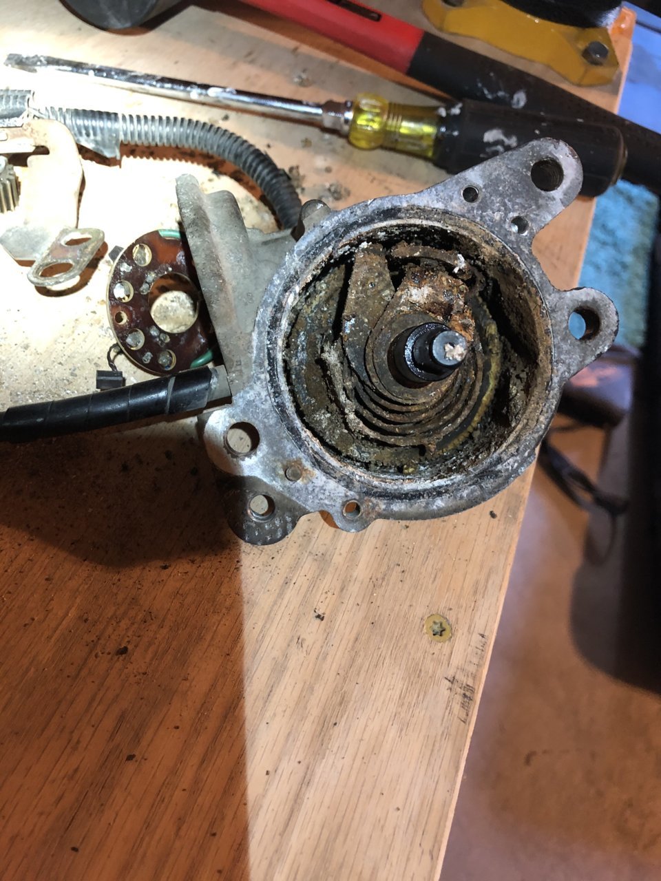

    Wondered why my locker wasn't working...found out why my locker wasn't working.
    Don't have a good post-op photo but suffice to say I cleaned it up, used some expensive Toyota body grease on it, and now it's working great again!
    Also greased drive line and other components, and changed the oil in the diffs, transmission and t-case. I didn't think the oil in the trans was that old (changed by PO some time ago) but wow the truck shifts so much more nicely now.
    Timing belt is on the menu for next weekend.

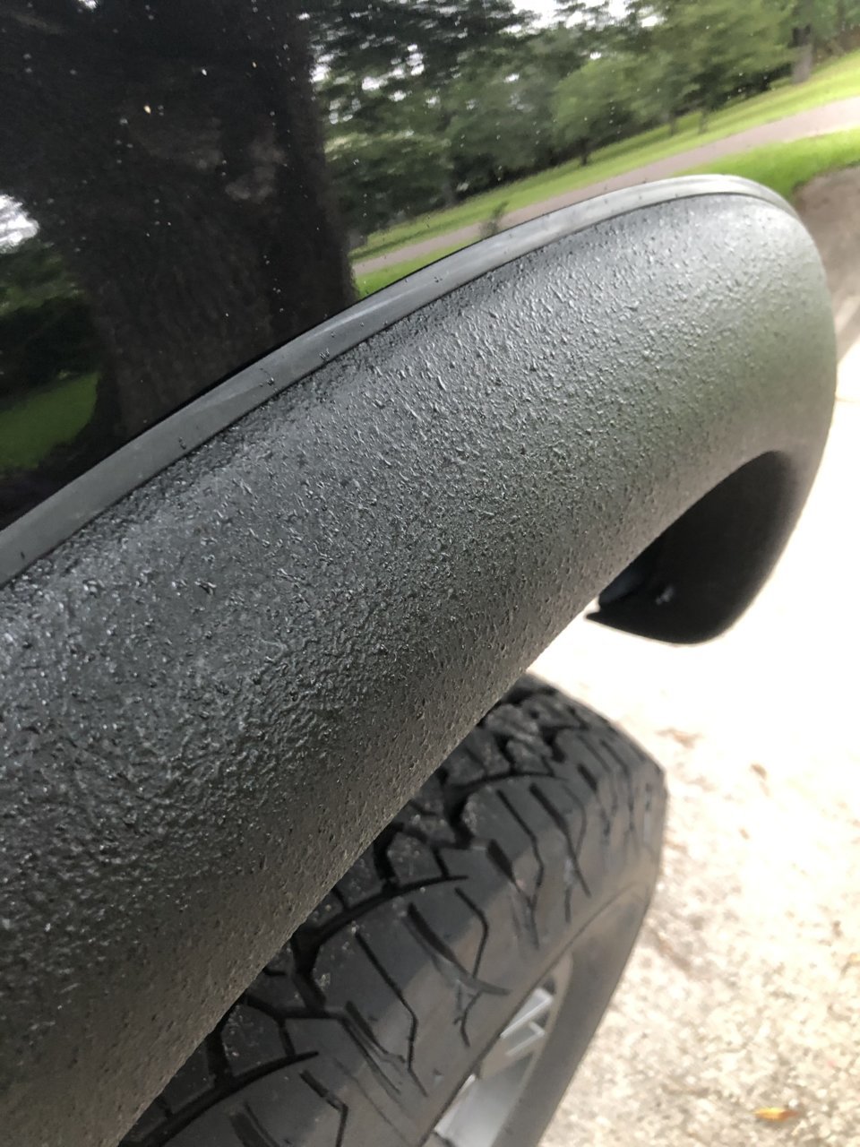

    I'm pleased with my flares that I lined. Hope they hold up well.

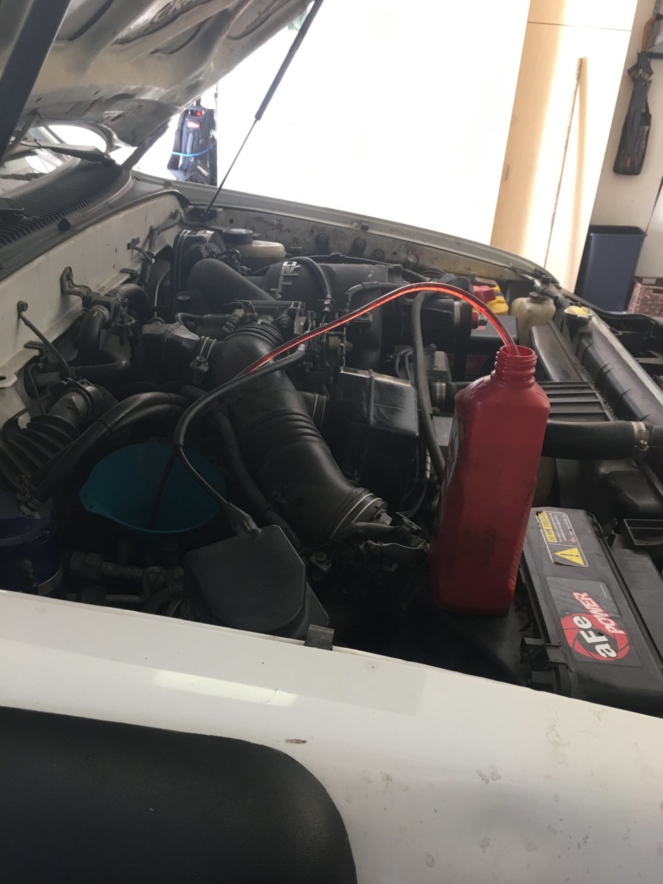

    Lazy mans transmission fill method. Gravity is friend.

    Thanks bud. Hope yours does as well. I almost used Raptor myself .

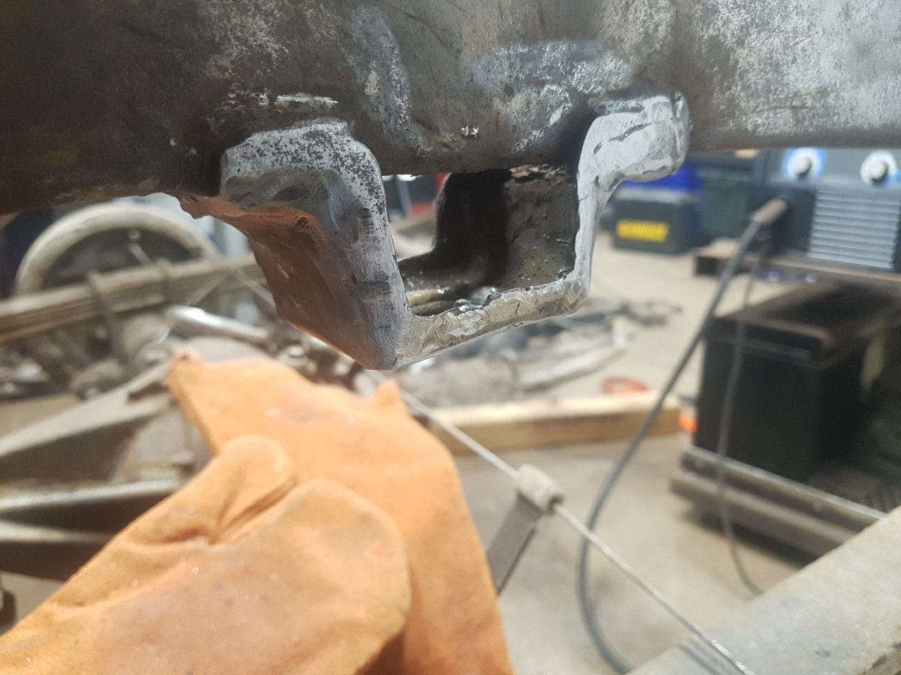

    It's not pretty, but I have more bumpstop now. :welder:
