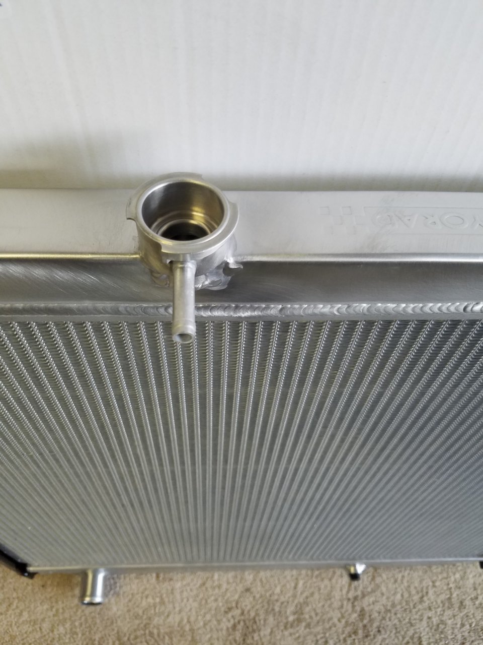

    They probably have pre made tanks and one size top tank works for all the Tacoma and 4Runners with
    the newer hood for the 1st gens

    I think i figured out why. To get cap height down lower. If it came out sideways the neck would be taller.

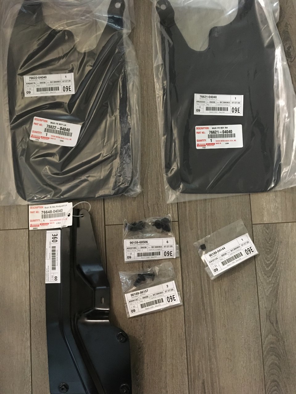

    New mud flaps all the way around... thanks to TW I was able to get all 4 OEM mud guards w/ brackets for $250 out the door shipped...

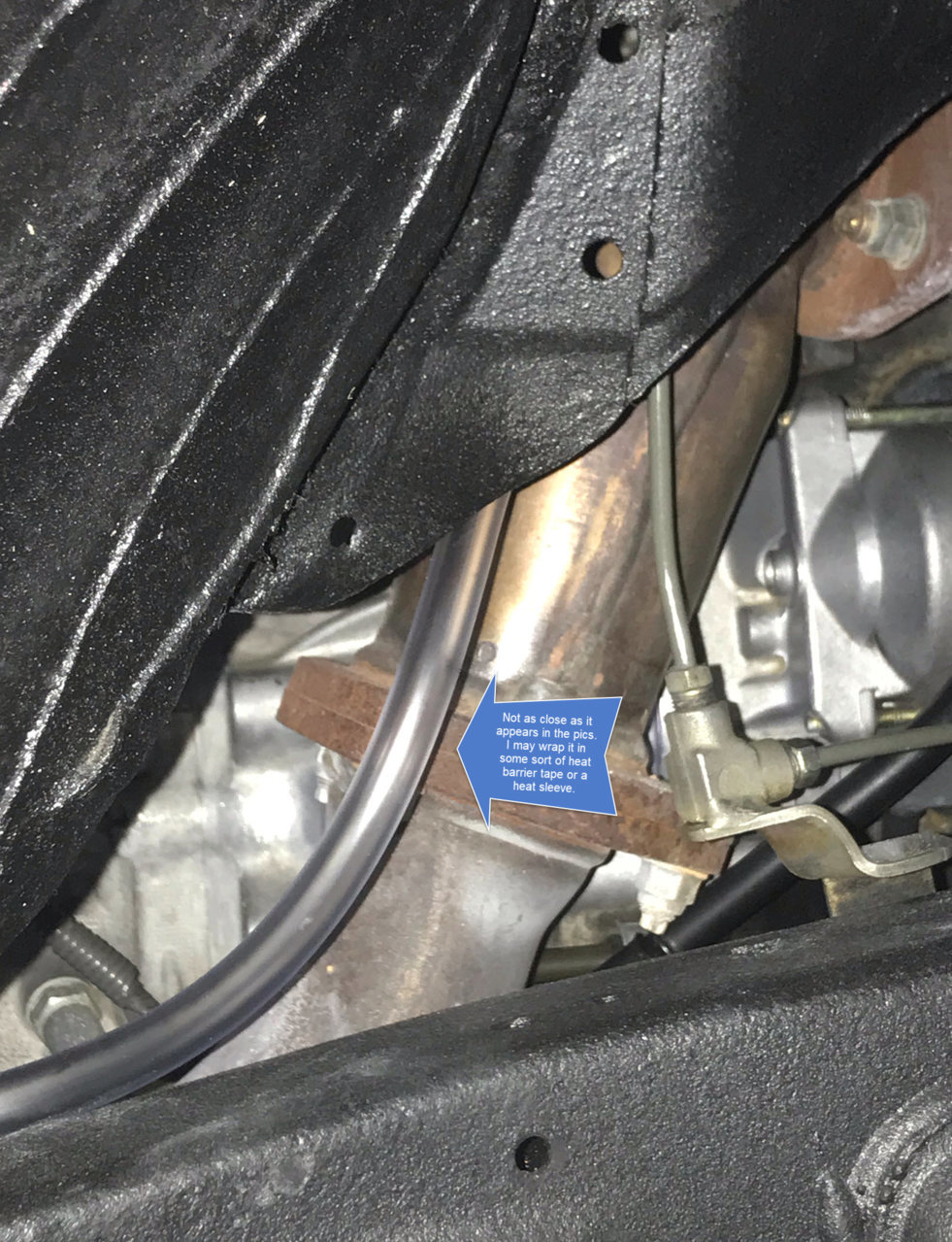

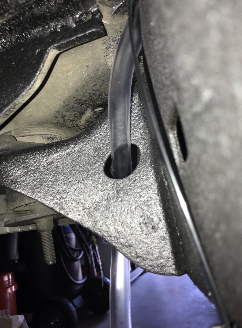

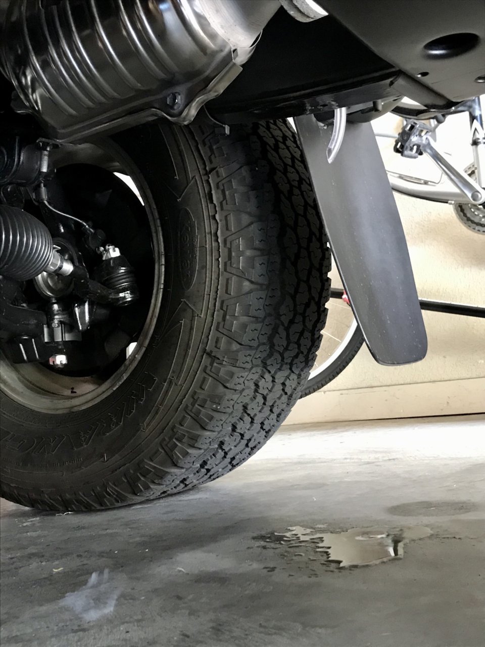

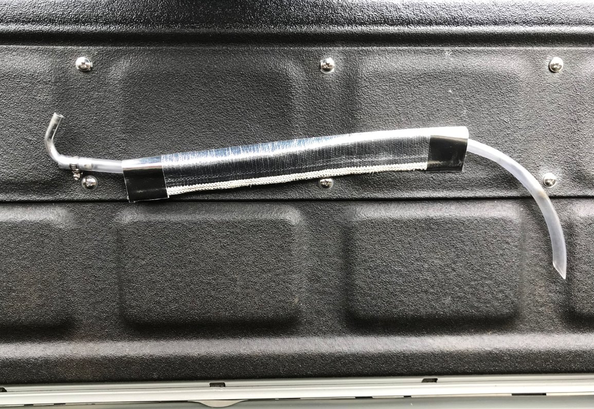

    Installed clear tubing from the ac drain to come out under the frame.
    Follow up...why didn’t I do this a long time ago?? Works like a champ. I don’t think I ever noticed water coming from the evaporator because it was draining on the frame and pooling on the back skid plate. Now, everywhere I go, I see where it’s marking its territory.

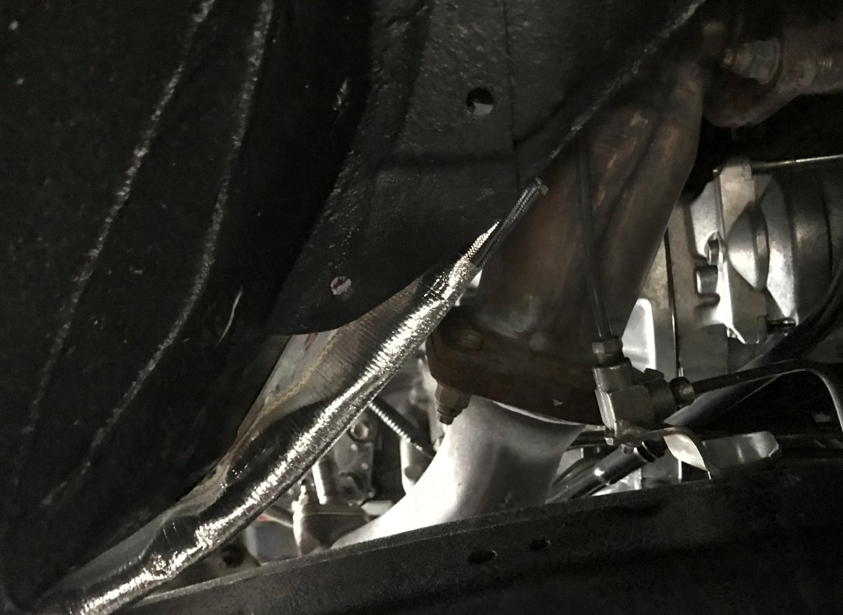

    Was getting concerned about the hose being so close to the exhaust so I ordered a roll of heat shield sleeving and heat reflective tape.
    The sleeving can be cut to length and is very flexible.
    https://www.amazon.com/gp/product/B088FMFKJ2/ref=ppx_yo_dt_b_asin_title_o04_s00?ie=UTF8&psc=1
    https://www.amazon.com/gp/product/B000E283S0/ref=ppx_yo_dt_b_asin_title_o01_s00?ie=UTF8&psc=1

    This is pretty genius

    Cut it at an angle on the back. That way it will draw water out better.
