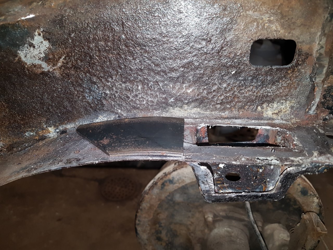

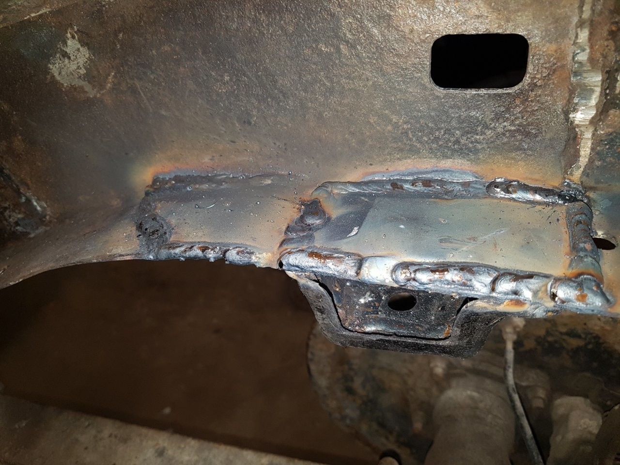

    My welds are about as pretty as my handwriting. :anonymous:
    Fewer holes in the frame now though.
