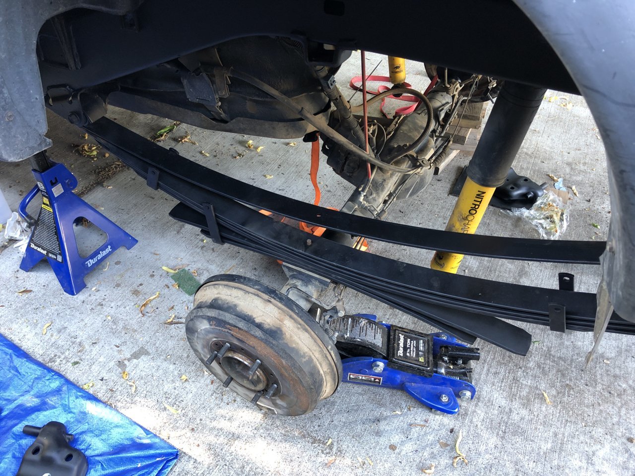

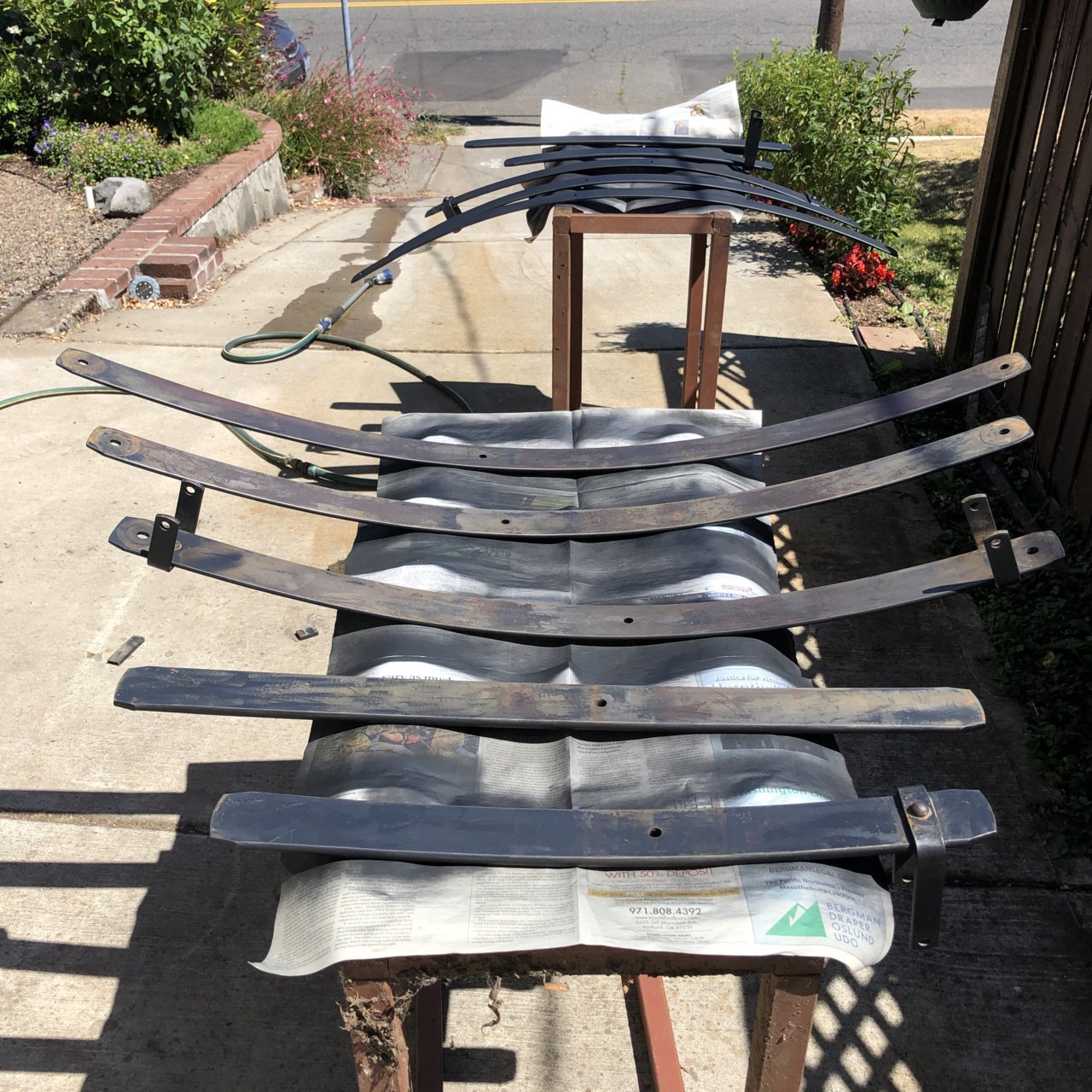

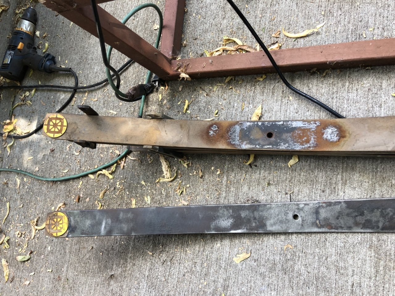

    Technically what I did yesterday:
    • Removed plastic wrap from frame areas with surface rust after grinding and sanding as much off as possible and covering with magic rust gel
    • Painted said frame areas with Eastwood rust encapsulator and EXTREME chassis paint
    • Decided I was sick of my Dakar’s rusting away (why so fast OME???) and with the new camper being a few hundred pounds less than the Wildernest, removes the AAL, hit ‘em with a wire wheel and painted them with Rustoleum (Chevy 63” swap planned for the winter)
    • Noticed my god damn rear axle seals are leaking...
    Got everything buttoned back up at 10p. Went to bed to get ready to...work on Landcruisers... hopefully I can knock the seal/bearing nonsense out before the weekend, because so help me whomever, I’m playing trucks this weekend, not working on them.

    sucks that your Dakars are rusting so quick. i remember reading in the Oregonian a few years back (i think) that whoever handles roads in Portland was going to start salting the roads in wintertime:annoyed:. Suprised that they started showing it that quickly but given that the rust is still just surface rust, that could be the culprit:confused:. either way, hope mine last longer than that...

    Mine starting showing surface rust about two weeks after install.
    And I installed them in late summer. In a desert-like climate.

    Yeah and these lived most of their life in Colorado too, I’ve heard it’s fairly common. And another reason to go 63s and avoid really expensive expedition springs! F whoever decided to use salt in Oregon, heard the same thing...
