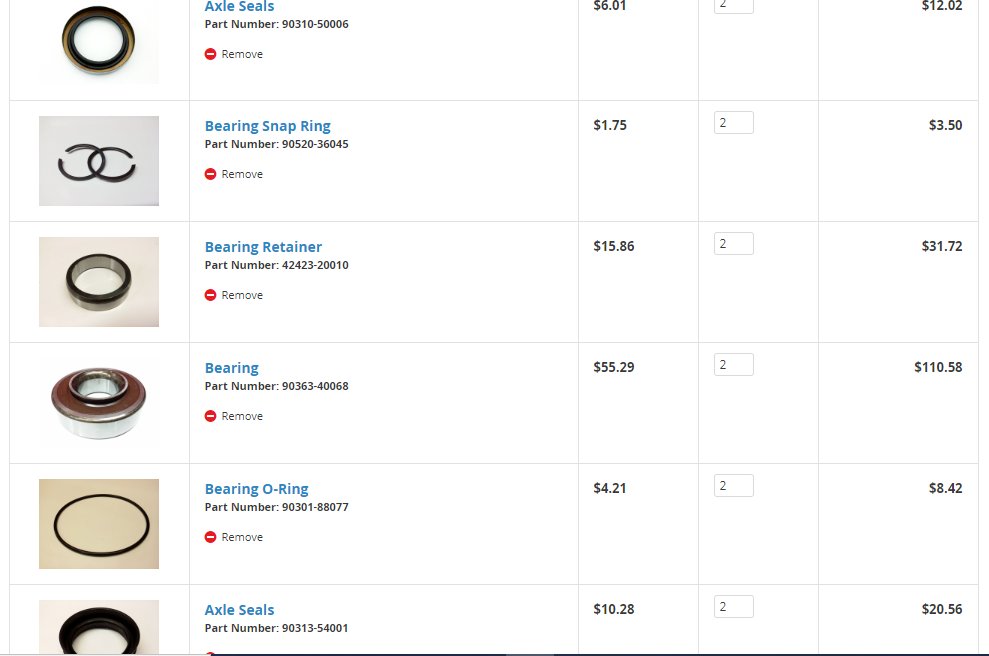

  11. Aug 11, 2020 at 8:33 AM
    El Taco Diablo
    El Taco Diablo Professional Pinstriper
    Nov 6, 2017
    #235223
    13,971
    Matt - KN6DZP
    Hughson, CA
    Impulse Red DC, 5vz-fe, 4wd swap, LT, dual case, F/R locked
    Just 3 tons of fun!!!
    So... I emailed McGeorge Toyota for some clarification.
    From what I am gathering, from their response, the 8.4 (non e-lock) axle and the 8.0 (e-lock) axle have a different parts list. I think both the ABS and non-ABS axles @Timmah! did in his video may have been 8.4 (non e-lock) axles, and that is why both of his parts list were essentially the same (except for the ABS cog).
    Here is what the conversation looks like with McGeorge Toyota.Hopefully this clears some things up for others. And doesn't just further muddy the water. I know @lightnfast was curious about this.
    FROM ME:
    Good morning
    I need to order the parts neccesary to replace my rear axle bearing and seals. I have a list of part numbers, but they are not matching the part numbers listed for my vehicle.
    The vehicle is a 2002 Toyota Tacoma
    VIN # 5TEGN92N42Z053932
    My truck is equipped with a rear e-locker. I am not sure if the e-locker was a factory option or a dealer option (I think this may be the reason for the different part numbers)
    I need the following parts and these are the part numbers I have.
    X2 - Type K oil. 90313-48001
    X2 - Bearing. 90363-40020-77
    X2 - Type S oil. 90310-50006
    X2 - Ring O. 90301-88077
    X4 - Spacer Bearing. 42423-20010
    X2 - Ring Snap Shaft. 90520-36045
    I would like to order these parts (or the correct similar parts for my application) as soon as possible.
    Thank you for your time and consideration.
    FROM MCGEORGE TOYOTA:
    Hi,
    Some of those parts in your list are not correct for your vehicle. Here is a comprehensive list of the correct part numbers for your vehicle, starting from the inner seal and working outward:
    --90310-50006--inner seal
    --90520-36045--c-clip
    --42423-20010--bearing retainer (if you have ABS brakes, you will need two per side...if you do not have ABS brakes, you'll need one per side)
    --90363-40068--bearing
    --90301-88077--rubber o-ring
    --90313-54001--outer seal
    --43517-35010--ABS tone ring (one per side, only applicable if your vehicle has ABS brakes)
    I Bold/Italic the part numbers that stayed the same. It appears the outer seal and the bearing are different between the 8.0 and 8.4 axles.

  12. Aug 11, 2020 at 8:38 AM
    Squeaky Penguin
    Squeaky Penguin Nothing Ventured, Nothing Gained
    Apr 5, 2012
    #76340
    10,068
    Brett
    Steamboat Springs, Colorado
    '01 4WD, SR5, TRD & '13 TRDOR AC
    Lots of dust and custom dents, Check Build
    No. I think your first part numbers were for 95-00 axles. Which most definitely do not use the same bearings and outer seals as the 01-04s.

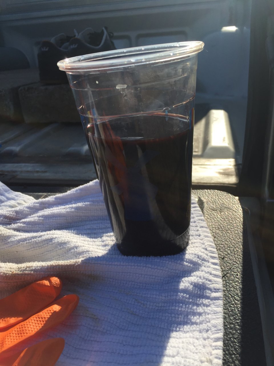

  14. Aug 11, 2020 at 8:44 AM
    Sicyota04
    Sicyota04 Slowly but surely.
    Jan 9, 2015
    #145940
    3,558
    Morgan
    California
    04 DC 4x4
    Did a drain & refill.
    I think it was time. :anonymous:

  15. Aug 11, 2020 at 9:00 AM
    El Taco Diablo
    Nov 6, 2017
    #235223
    13,971
    Matt - KN6DZP
    Hughson, CA
    So here's the list. Hopefully it's right.
    jammer likes this.
  16. Aug 11, 2020 at 9:15 AM
    Squeaky Penguin
    Apr 5, 2012
    #76340
    10,068
    Brett
    You're still two retainers shy unless you want to reuse two.
    Madjik_Man likes this.

  18. Aug 11, 2020 at 9:20 AM
    El Taco Diablo
    Nov 6, 2017
    #235223
    13,971
    Matt - KN6DZP
    Hughson, CA
    Planning on reusing 2 of them. Ordering 2 so if any of them are damaged I have them to replace.
