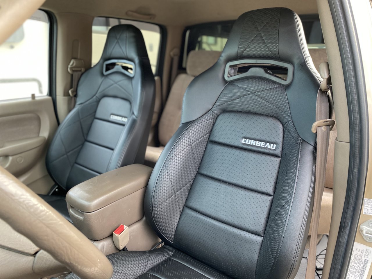

    @Ace115 I ordered through Corbeau, and I got them optioned with lumbar and heat, and brackets.. it wasn’t cheap, I think it was like 1400ish.. but if you just want the seats without any extras or brackets I think they’re like 900ish.
    They’re sweet though, I have a more detailed post in my build thread (on page 9), if you want more details.

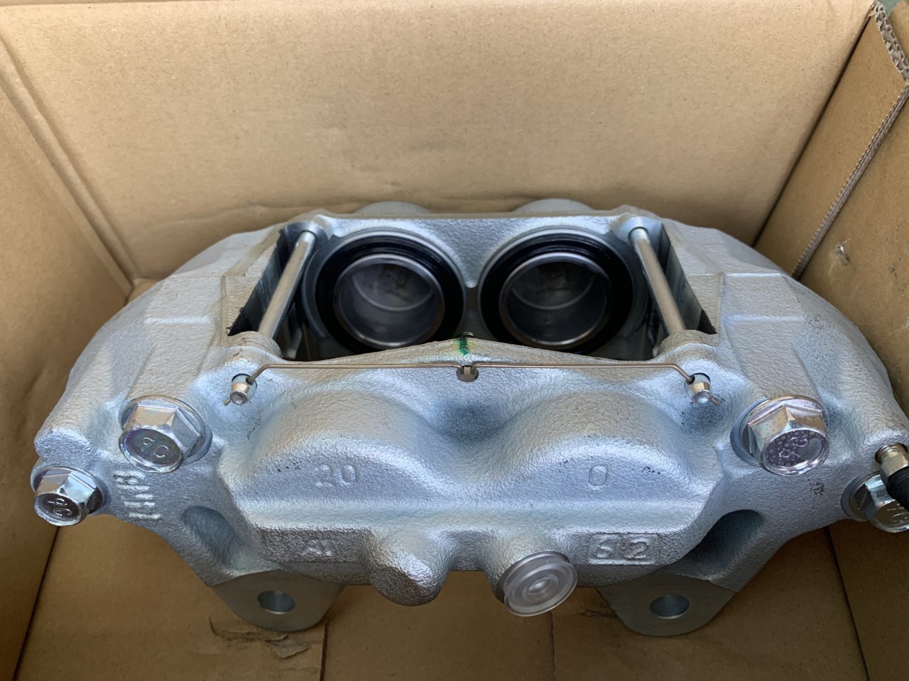

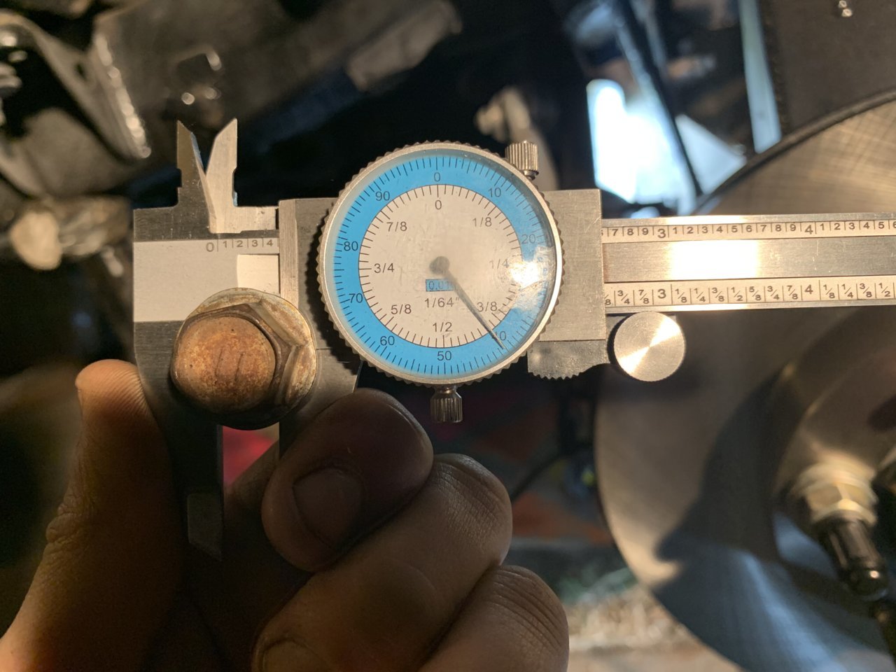

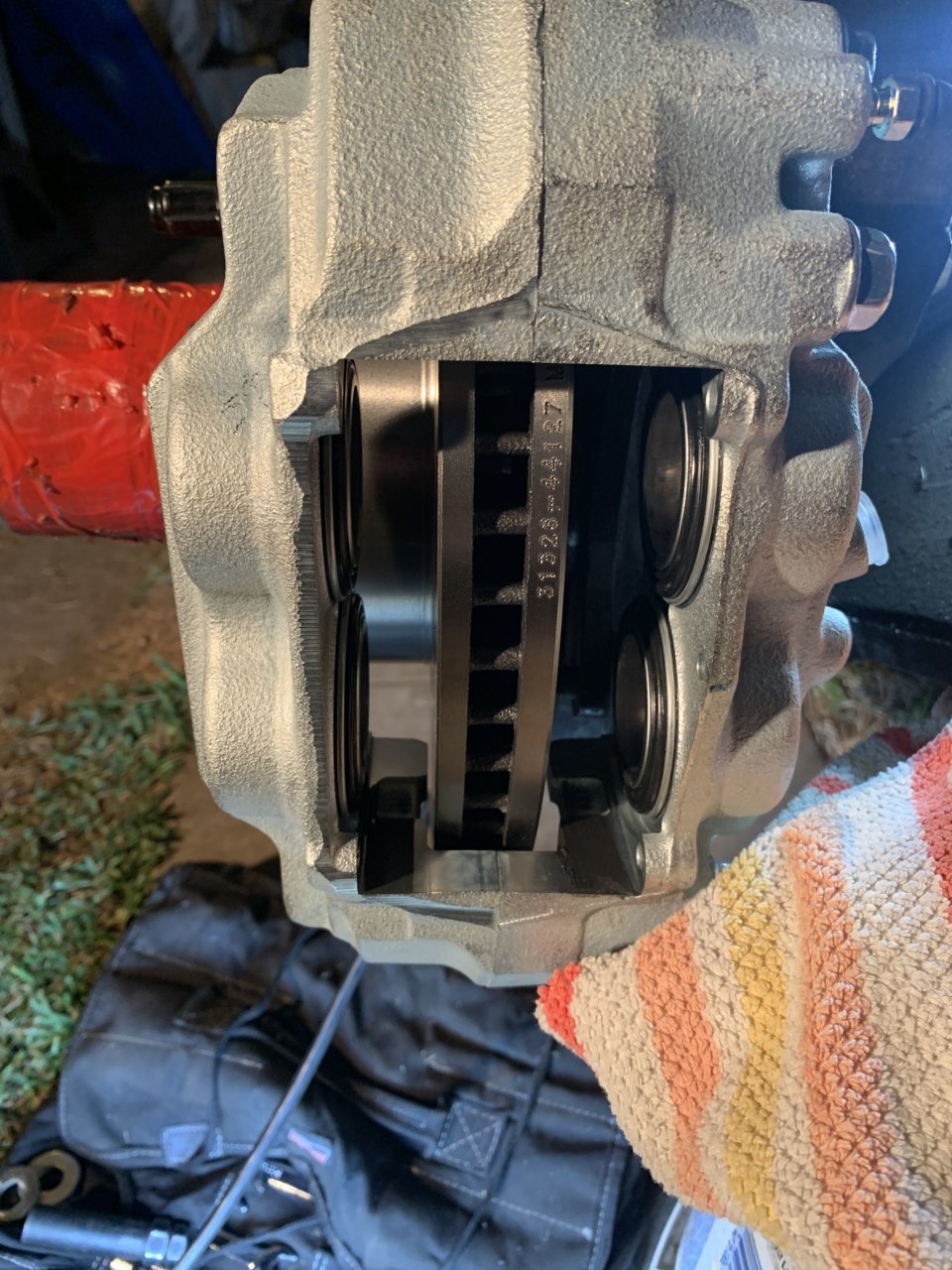

    Went to 2010-2015 4Runner front calipers and pre-2010 Lexus GX470 rotors today. Initial test fit shows they favor the outboard face of the rotor so I ordered some shims to take up inboard slack room. Calipers are OEM $156 online and rotors are $68. Not much more (sometimes less than) parts store prices. Calipers are stamped 14WB but have a 12mm bolt hole like 14WA that used be be cast into calipers 2010-2015. They have a machined face that looks like it could accept a banjo bolt but I’m going to get some extended lines made with a 10x1mm 90* fitting from an aircraft line store instead.

    haha I didn’t do anything just read this:
    https://www.tacomaworld.com/threads/tacoma-brakes-swaps-and-tech.468271/page-5#post-20254498
    I did get a little worried when I showed up to the dealer and opened the box and saw the 14WB casting in the caliper but the mounting holes didn’t look bigger than 12mm like our mounting bolts and the 14WA calipers instead of 14mm 14WB calipers which came on 2015+ 4runners and GX460’s. Not a deal breaker if you got the 14mm hole 14WB’s you could make sheathes with 12mm ID 14mm OD aluminum tube which is cheap off of Amazon. Luckily ordering part numbers for earlier 2010-2015 calipers have the 12mm bolt holes despite not coming with the 14WB casting.

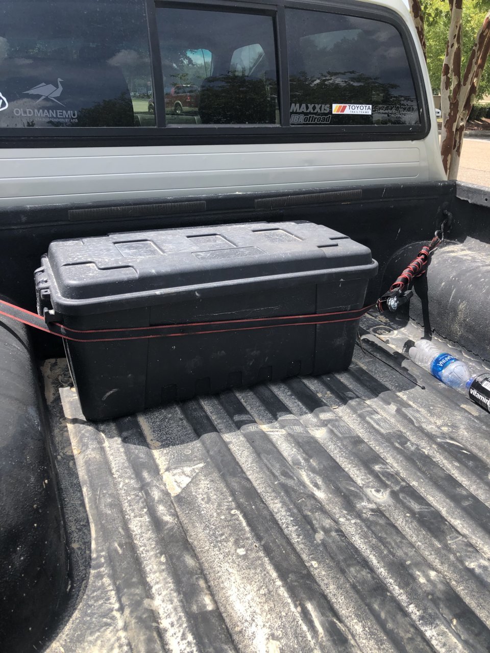

    I have the 56qt plano case
    ignore the messy setup right now, but I the 56qt Plano bin, can definitely slide it over and fit a gas can beside it. Fits in the back seat nicely as well if I need the whole bed
