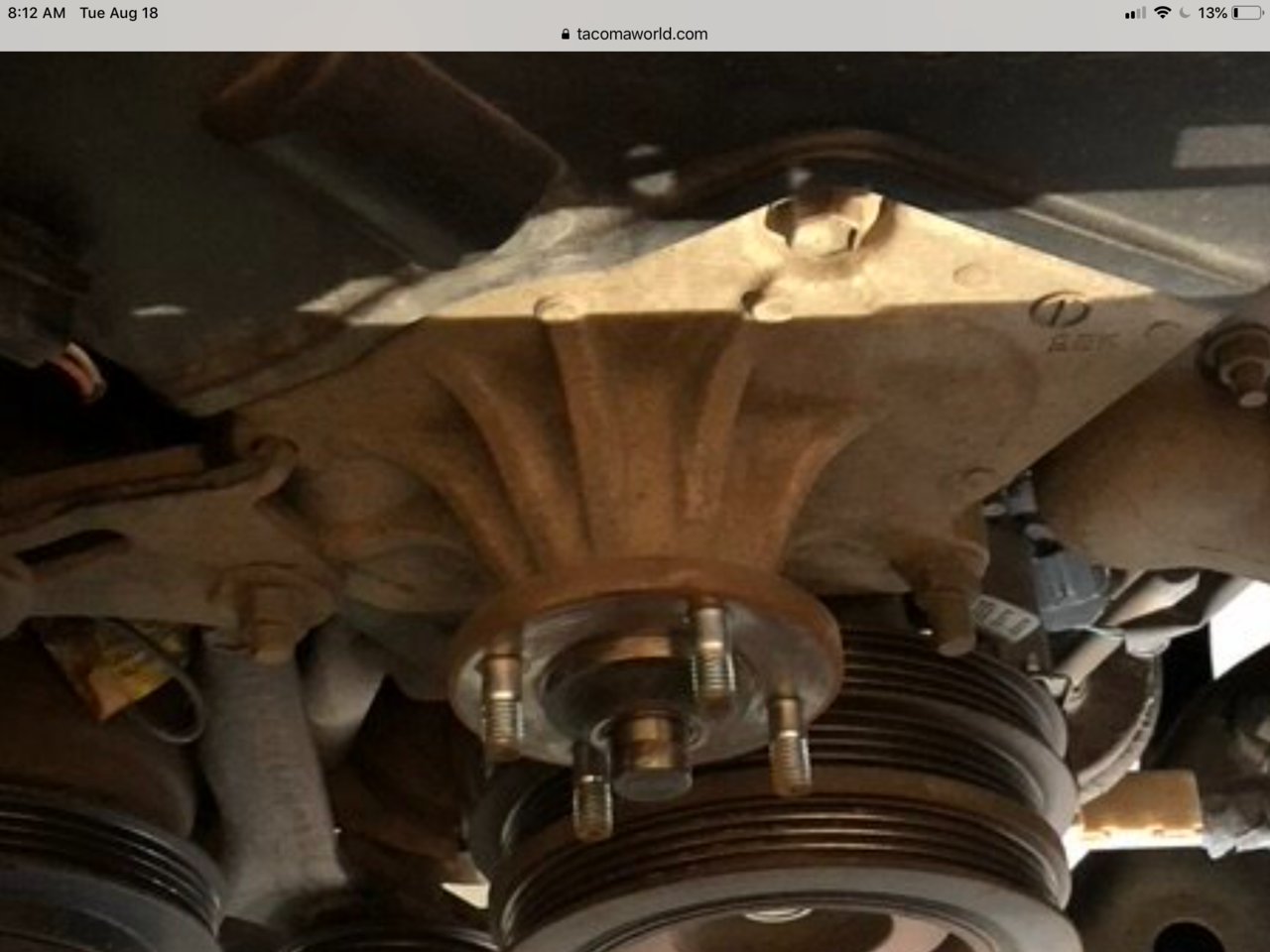

    It’s like the AC idler bearing, it just craps out. It might start to squeak or scream or lock up on you
    going down the highway which it did once to me and left me dead on the side of the road.

    Part number of said bearing ? Is it pressed? Gonna be doing a fan clutch, fan replacement soon

    You have to buy the complete unit,
    Rockauto Asian it’s around 100.00

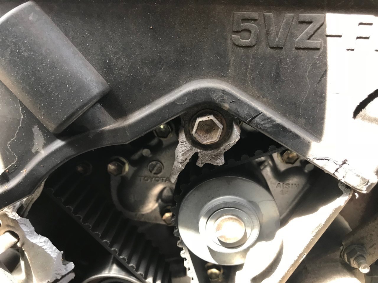

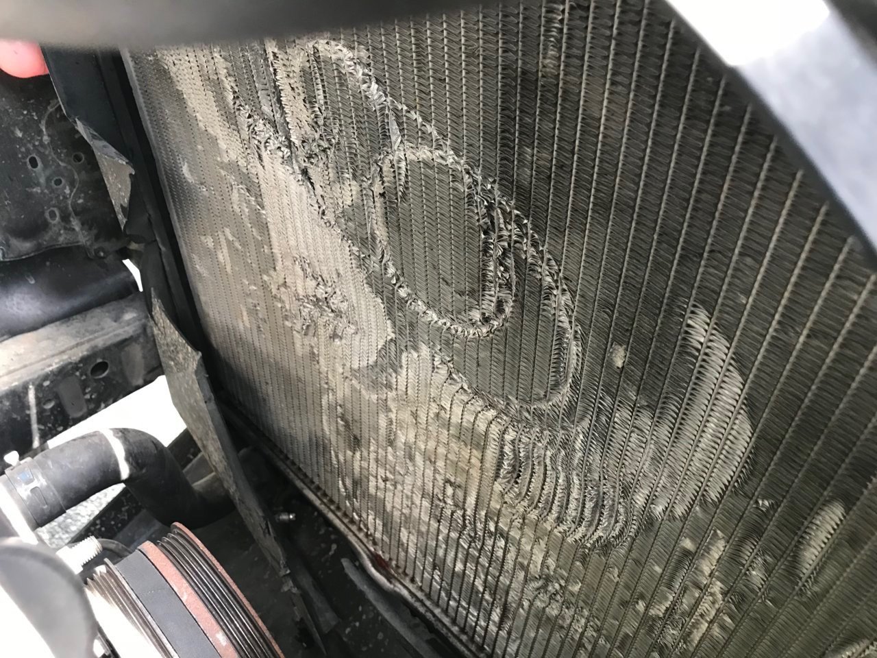

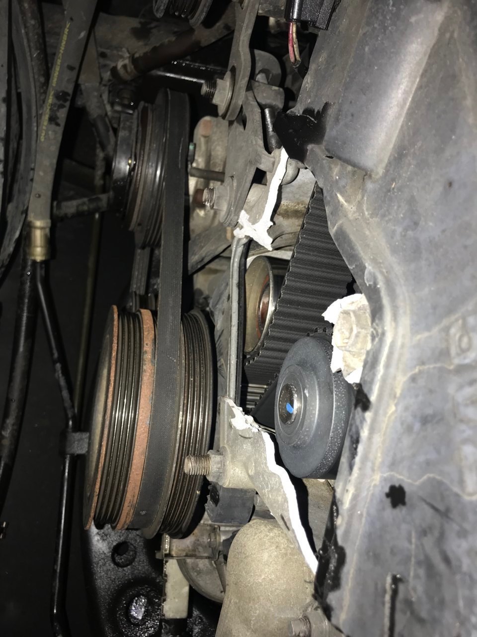

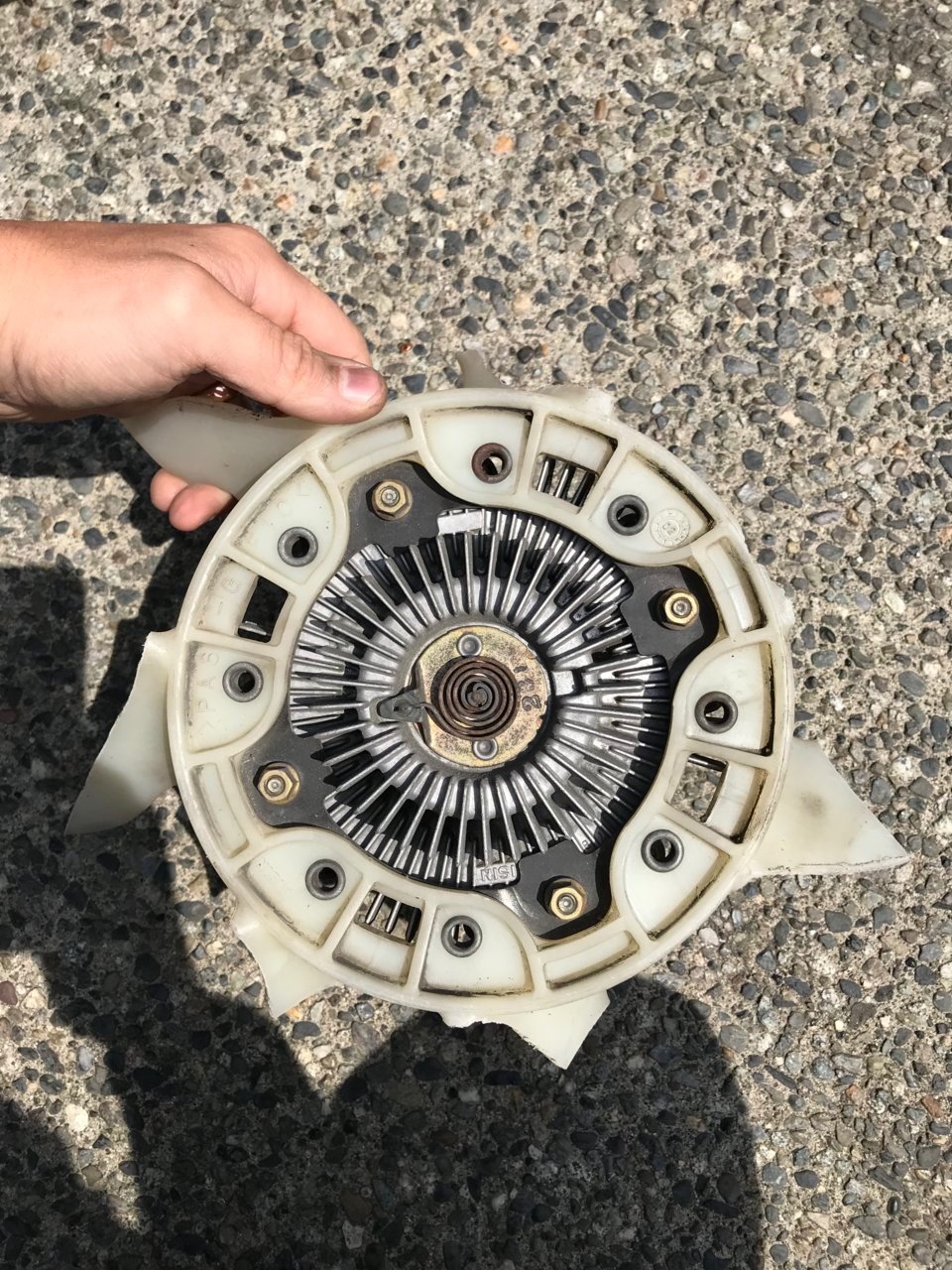

    Here is a photo of a locked up fan bracket bearing that took out every thing in the fan area.
    The bracket took out the radiator, the fan blade, the fan shroud, fan clutch, timing cover all at once And possibly even the timing belt with metal getting in the belt area

    100.00 So just replace it!

    Btw timing belt was only thing that wasn't damaged in this mixer

    Finally, Mystery Solved! Thanks man. Love your truck!
