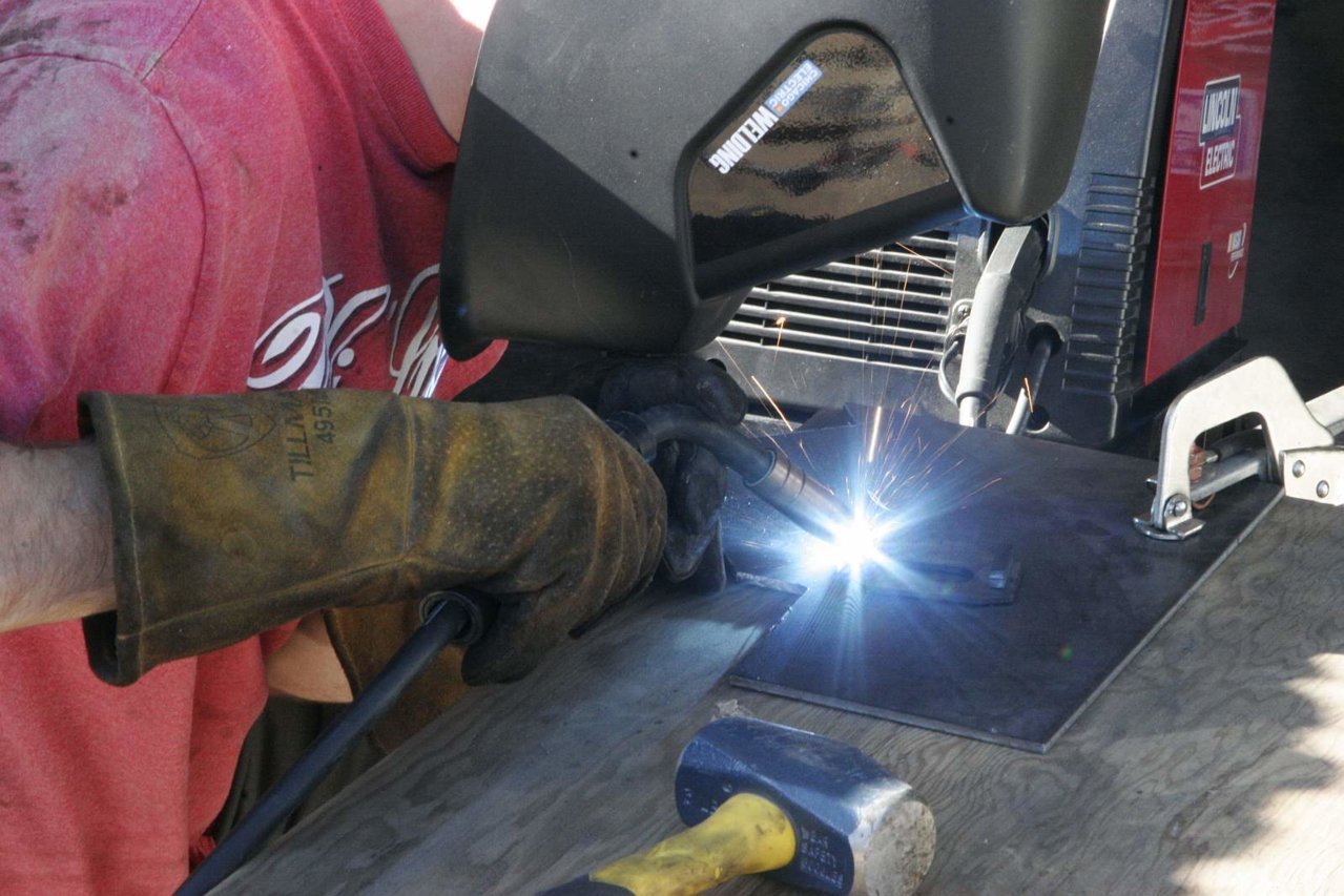

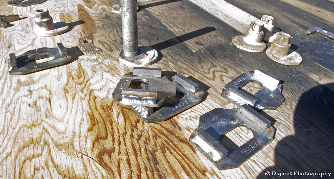

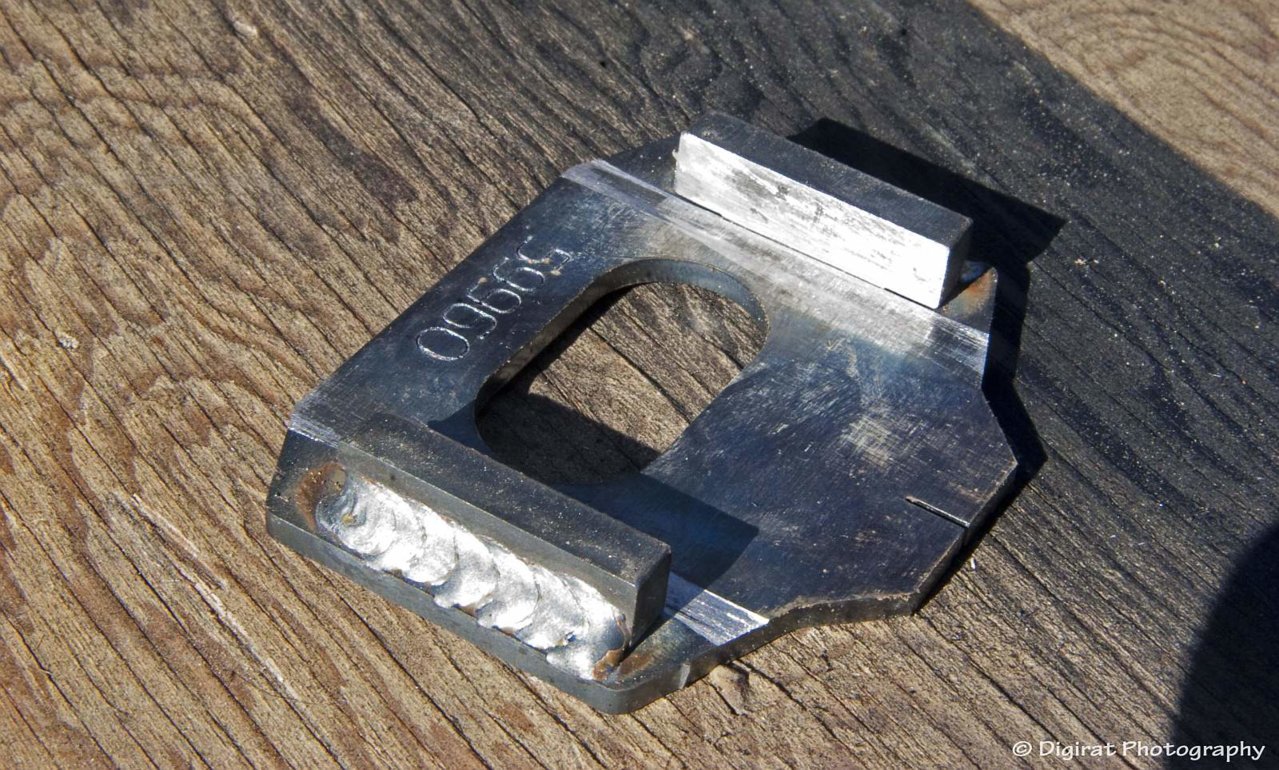

    Anyone had to replace their brake booster yet? I just did this past weekend. 205K on the truck. Used a reman unit from RockAuto. Worked out pretty good. No pics.

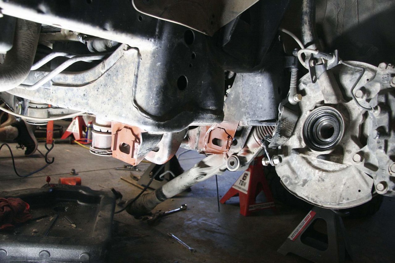

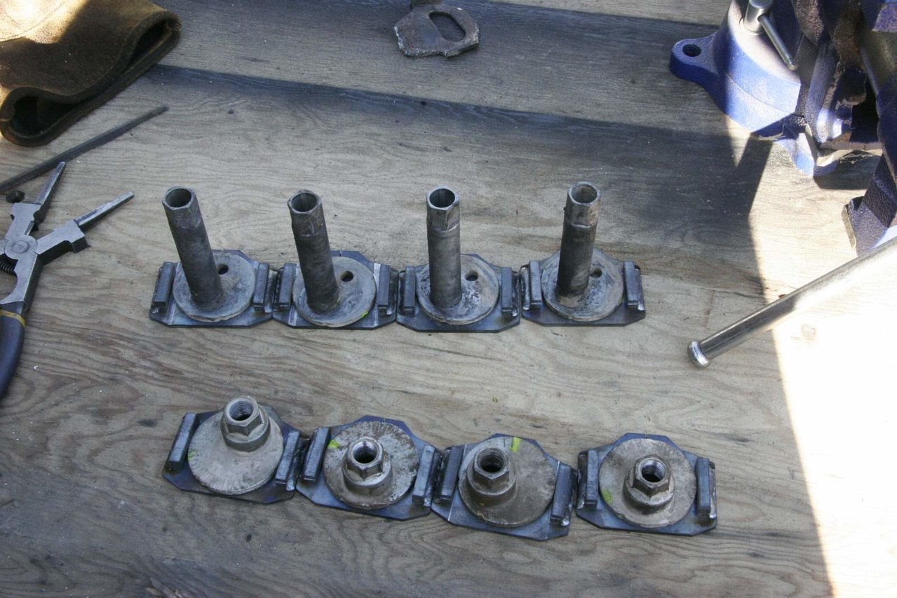

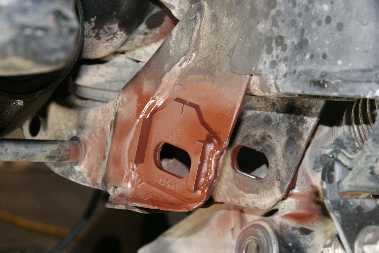

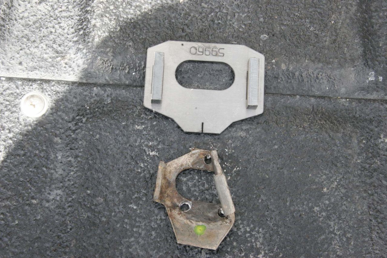

    Also installed an alignment tab kit from TC for the LCAs.

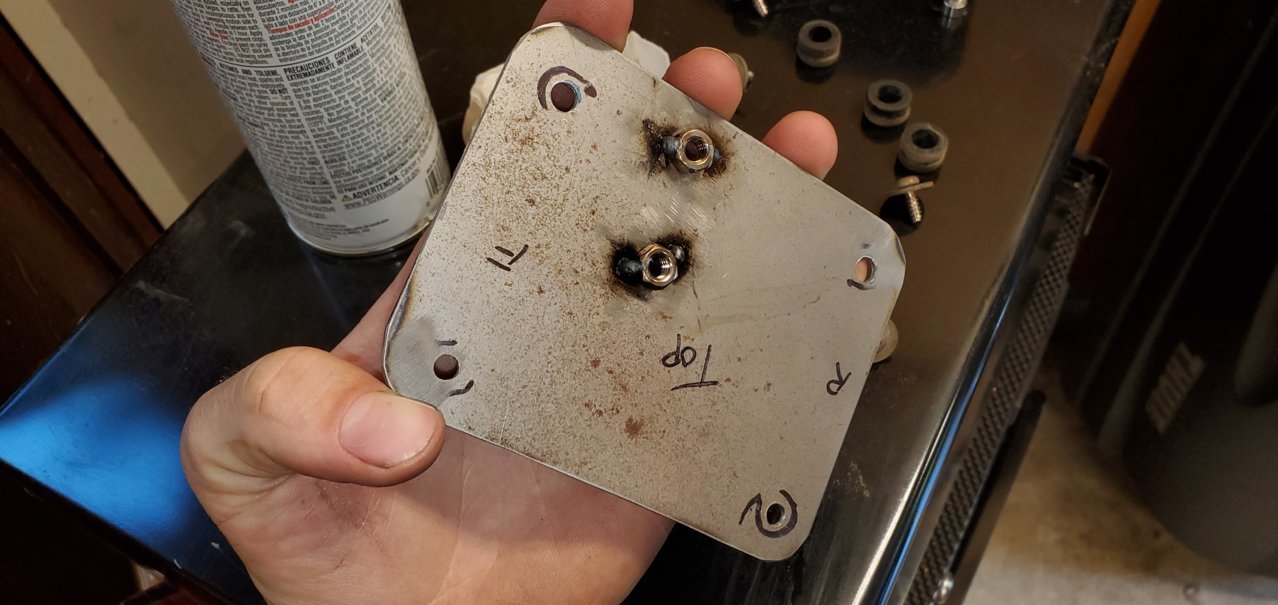

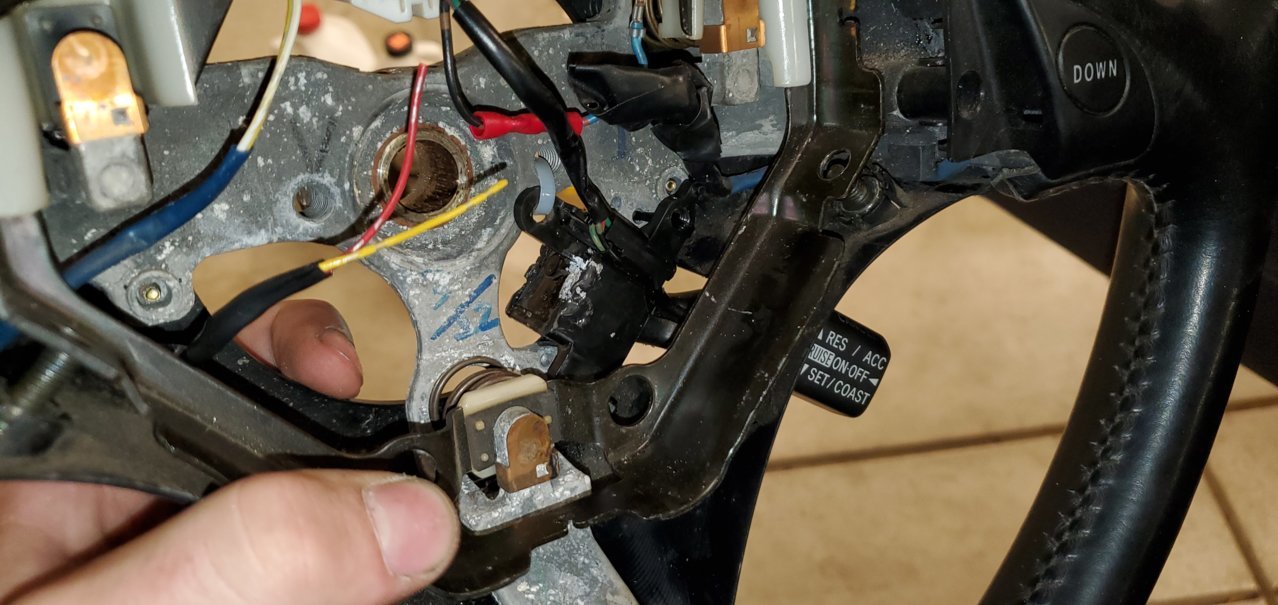

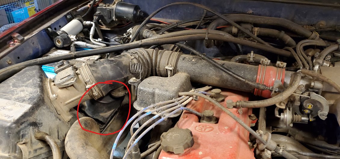

    Reinstalled my cruise control. Before I had removed the module to fit my air compressor under the hood. I had also swapped to a lexus steering wheel before, so the control stick on the new steering wheel wouldn't work with my system.
    Made a bracket to mount it under the intake mounted to the fender. Had to extend the wiring so the plug would reach too. It's tucked up in there real good now.
    Modified part of the steering wheel to fit my OEM CC control stick. Didn't have time/didn't wanna buy resistors to make the lexus one work with my setup, so had to get creative.
    Zip ties worked out really well actually for mounting. The casting of the center steering wheel structure had some weird contours so I wasn't gonna be able to drill and tap holes. It's solid though and it's going anywhere.
    Stoked to have cruise control again. Definitely will need it on this long ass road trip I have coming up.
