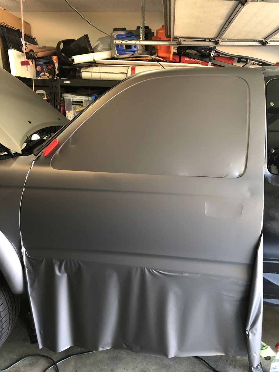

    Other than being a job that takes alot of time, how hard is it to wrap the vehicle and how much is it costing you?

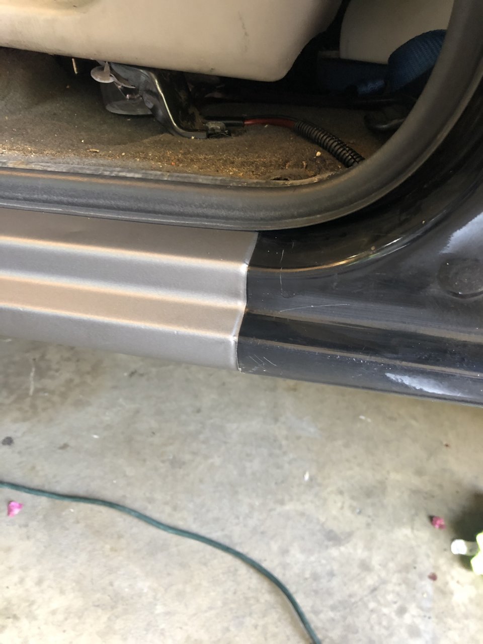

    I was fortunate to get the wrap at no cost. But the roll was about $600. I bought a heat gun and some wrapping tools. the flat parts are easy and the doors and front fender took about 30 min each. The first couple panels took longer. I completely taught myself how to do this as I went along. There are lots of parts I wish I was able to do over but it is still better than the paint was. All In was about $700 (including the cost of my free roll of wrap)

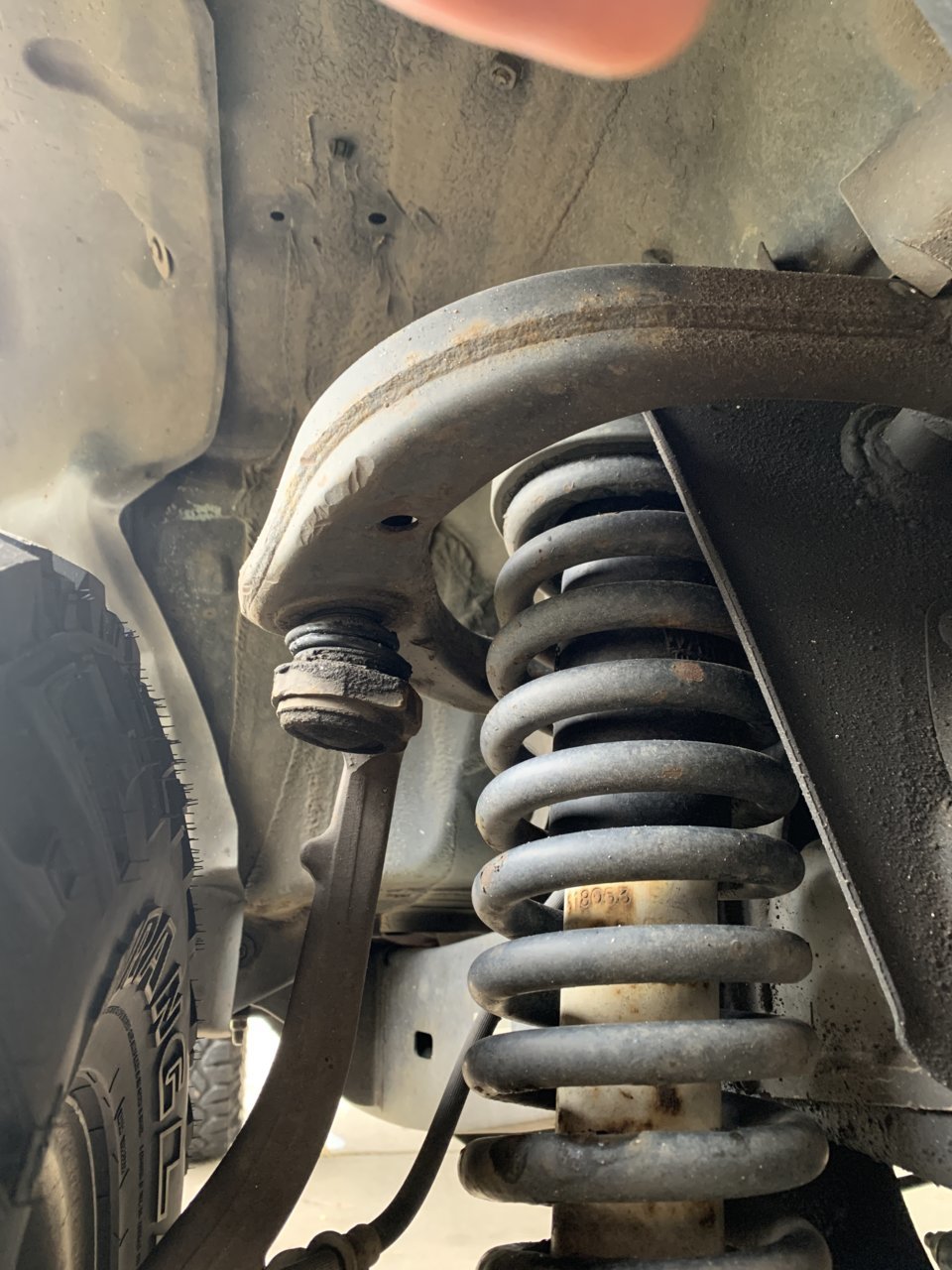

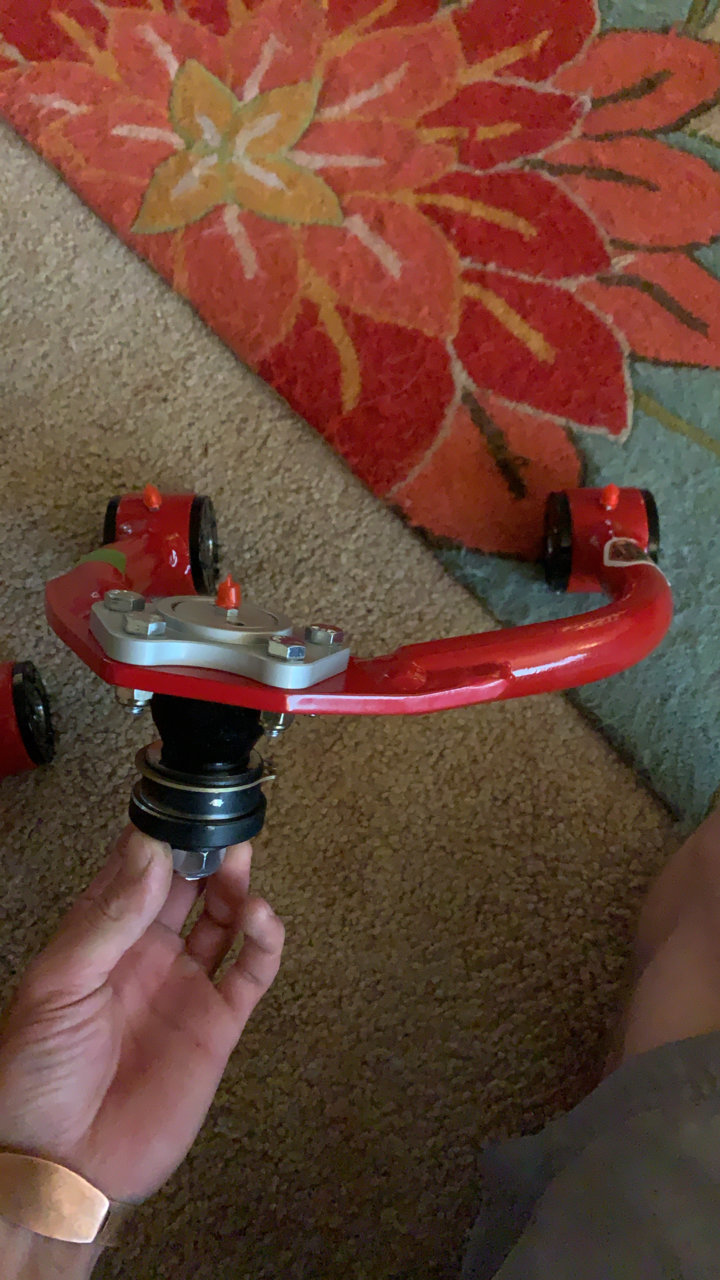

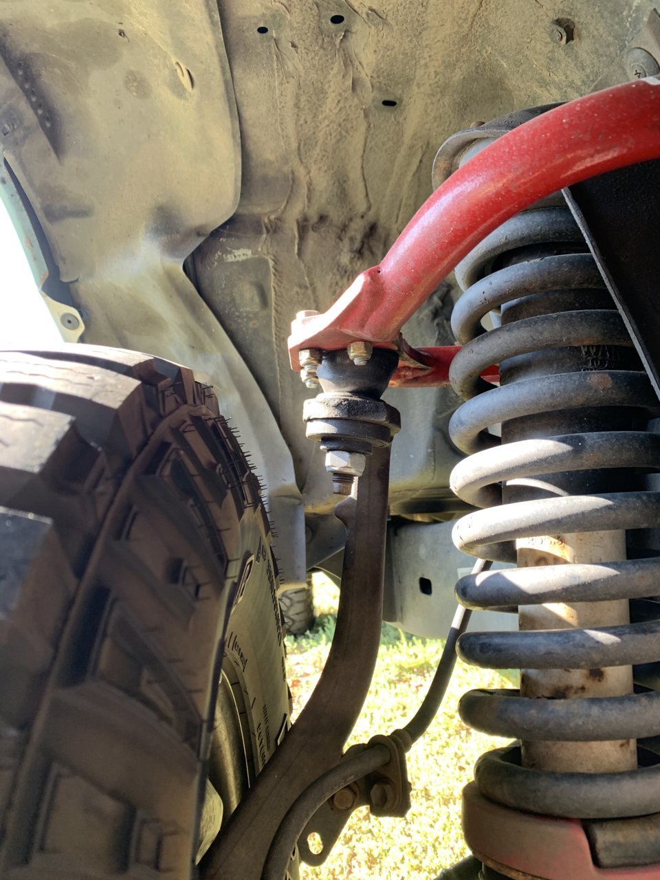

    I think it was a couple of factors. First off, being the stock control arms on 364,000miles, the bushings were not in the greatest shape, So I assume there was a little bit of sloppy-ness coming from worn bushings.
    Next, with a level kit on my truck, you can see how the steering knuckle arm, which connects to the upper ball joint with the stock UCAs, is at significantly more dramatic of an angle with the stock UCAs. Now with the JBAs, that arm sits more “straight” up and down. Taking highway curves through the mountains, I feel like my trucks body does less ‘dipping’ or has less body roll. Now I need to upgrade suspension all around and Hopefully be rid of any and all weebles and wobbles at 70mph
