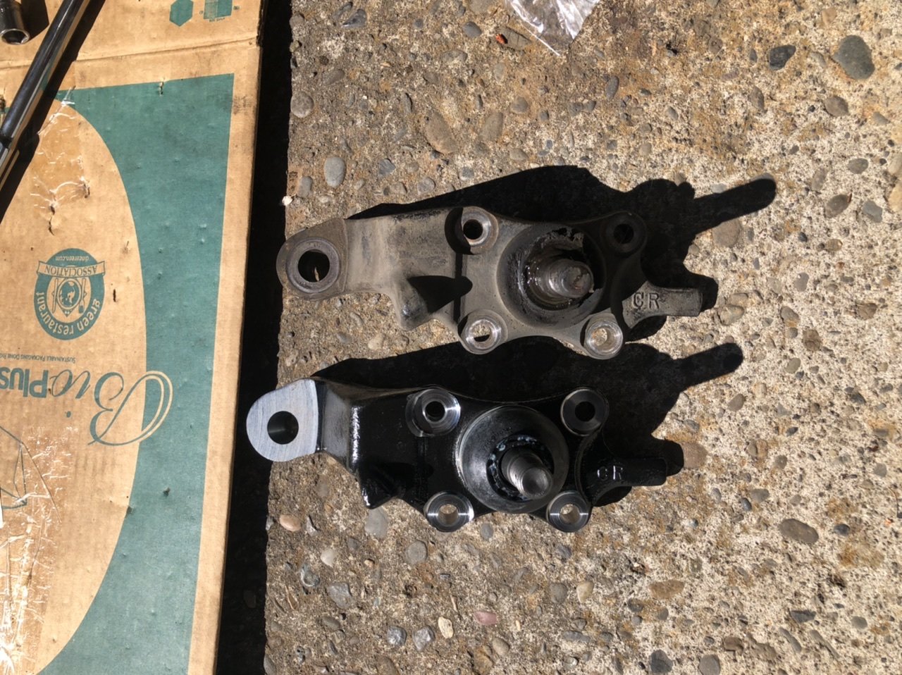

    Swapped in new lower ball joints. Got a good deal on the OEM parts from McGeorge Toyota online ordering. Tried to get a price match from my local, but they never called back.
    The job is straight forward. The only snag I hit was that the tie rods have been replaced and had a 27mm nut on it. So that was a couple trips to the closest store to get the right socket.
    Used a tie rod puller and every joint popped out easy.
    And the old ones looked pretty beat up. Torn boots and some play.

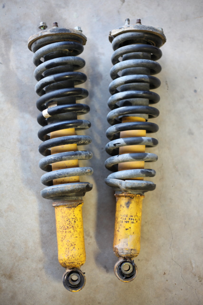

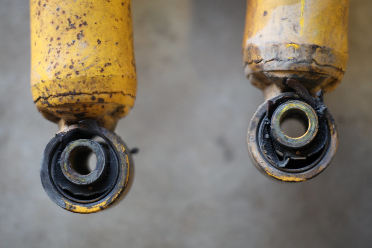

    Heres the old suspension, OME 882 at 4 Yrs of service.
    Check out them bushings.:eek:

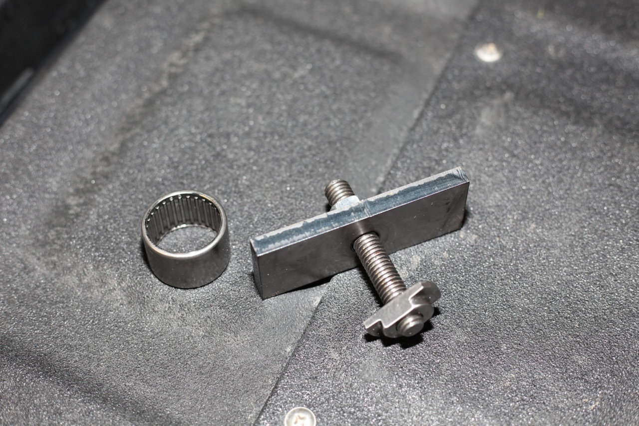

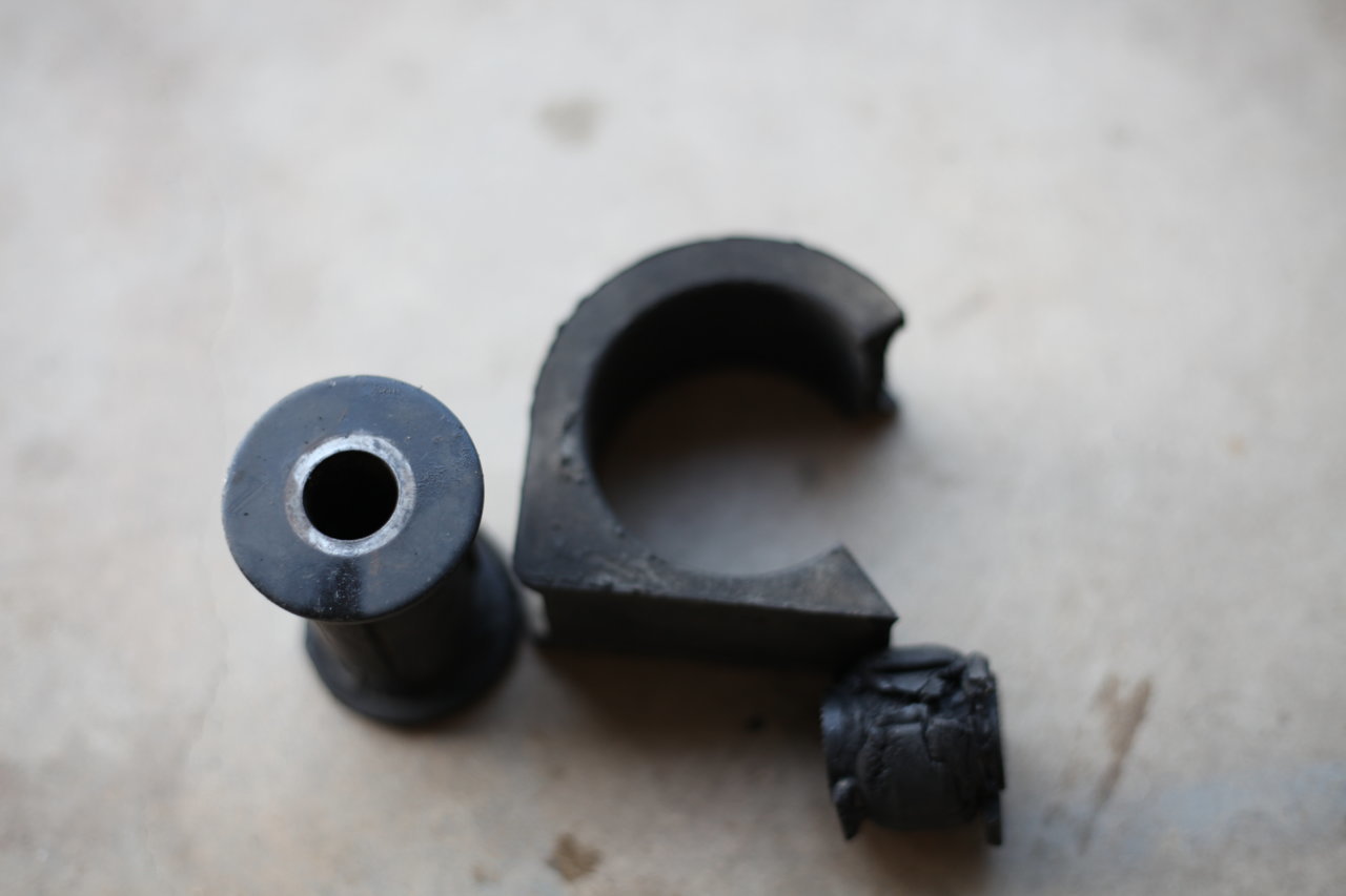

    Also pulled out old Drivers Needle bearing and steering rack bushings.IMG_9086.jpg IMG_9083.jpg

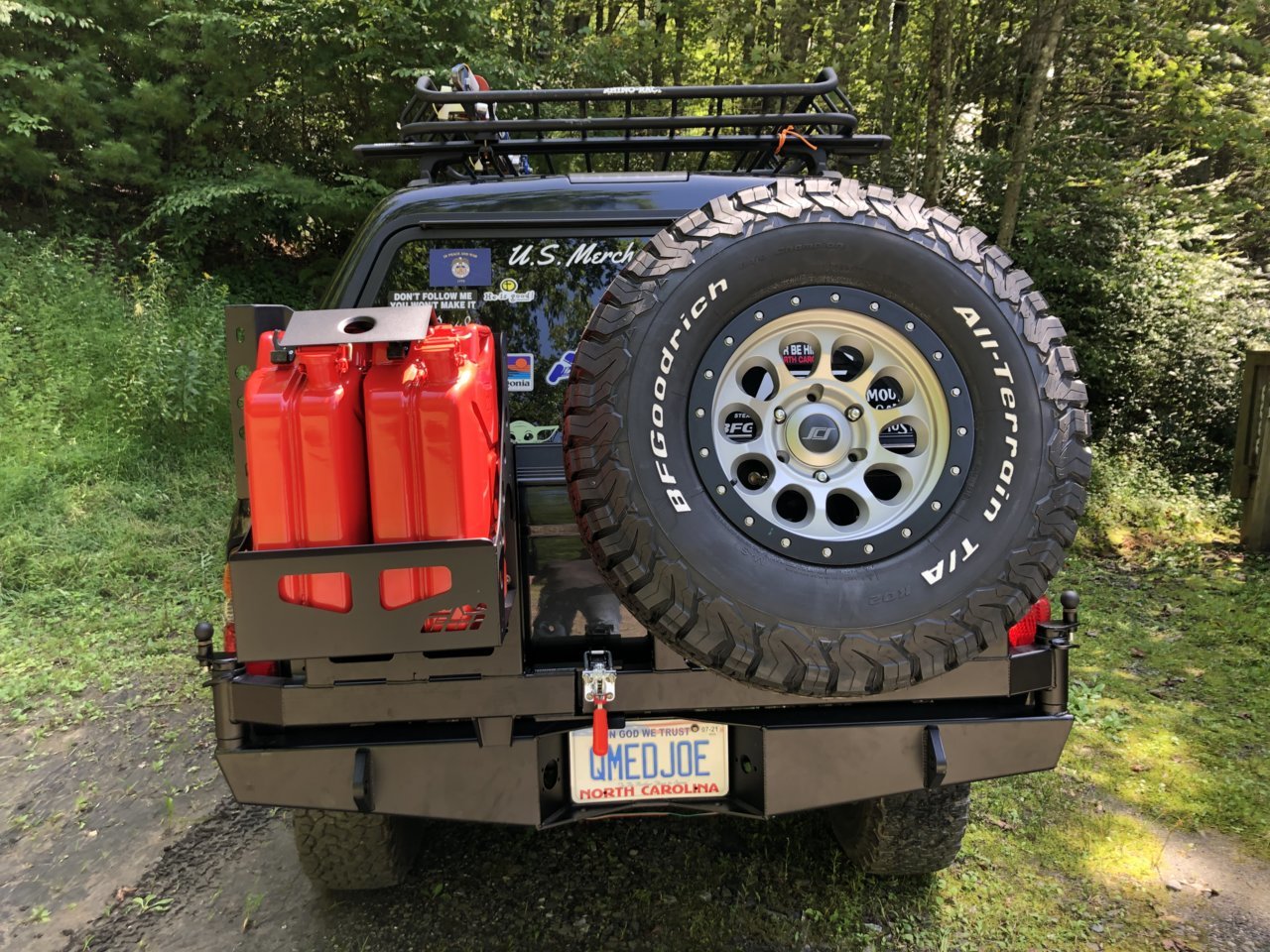

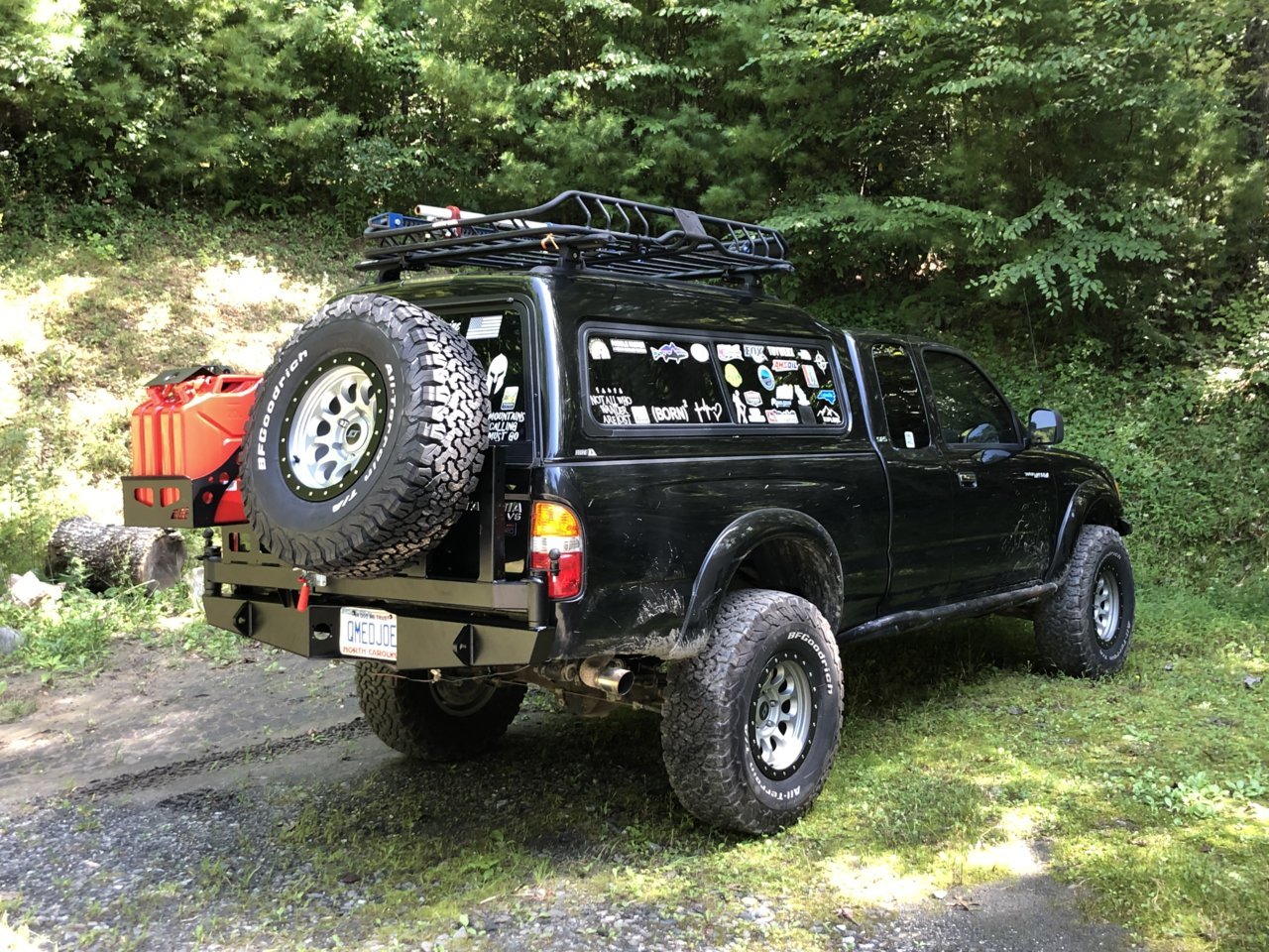

    Installed my CBI dual swing out.

    Looks awesome! :thumbsup: did you have to do any frame reinforcements to prep for it?

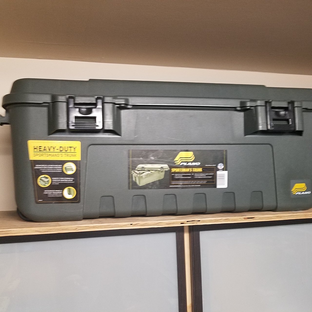

    Plano heavy duty sportsman trunk. got em on Amazon.
    Plano heavy duty sportsman trunk. I bought 4 on Amazon.

    Negative. It’s their Trail Rider 1.0. it just bolts on to the frame.

    He’s referring to welding on frame reinforcements, adding all that weight in the rear can cause frame damage.
