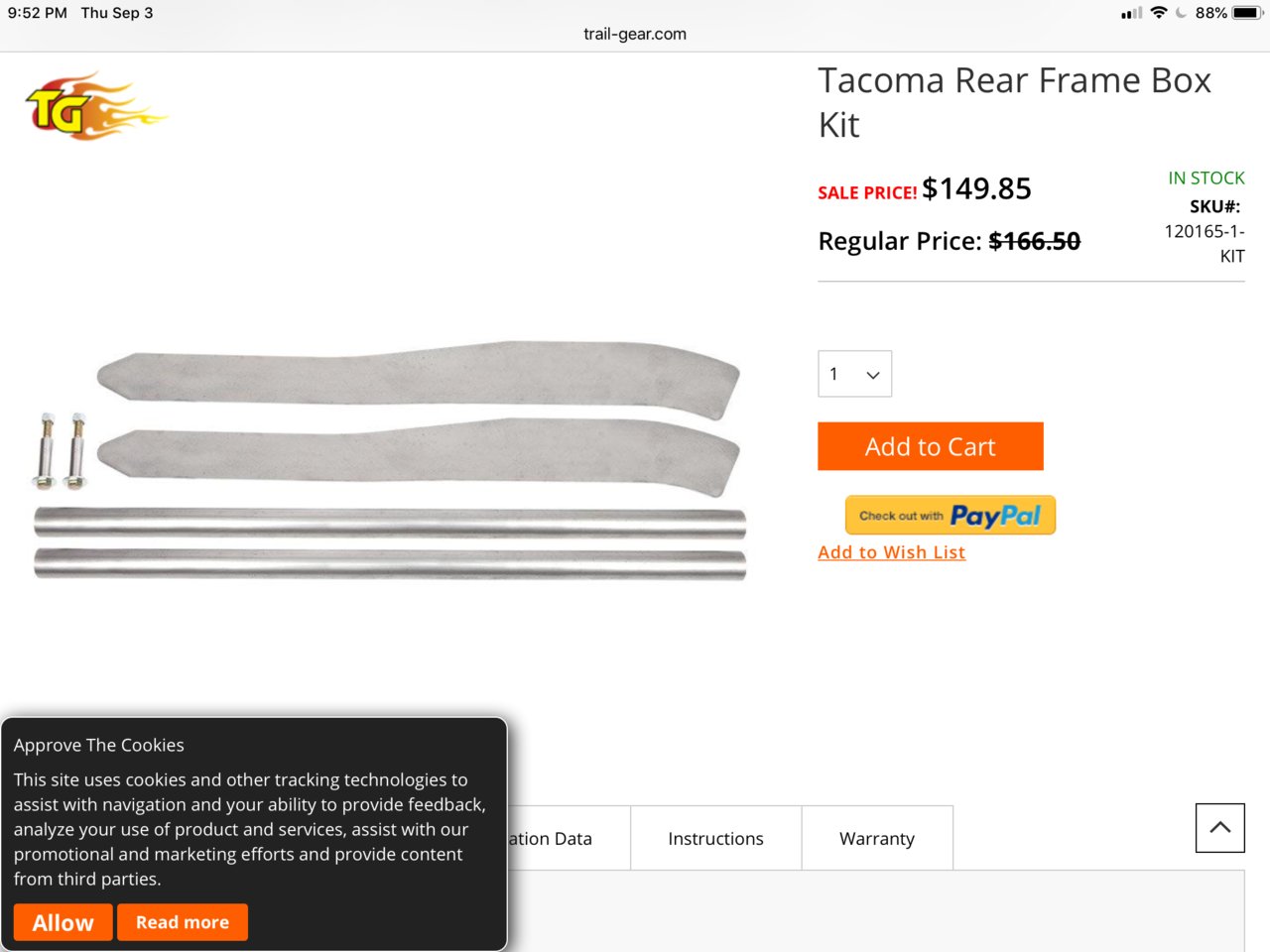

    Did you make your own inner frame section to box the frame? Or do they sell them somewhere

    Trail gear. They fit pretty good... You have to fill in the gaps, as they don't fit exact. I'm pretty sure it would be hard to make them fit exact on every truck though.

    Just what I need to order, I already have the outside frame supports,
    Did you use the shock DOM tubing that is included?
    “two pieces of DOM tubing. One tube is used for reinforcement and the other tube is used as an upper shock mount. The upper shock mount tube comes with metal sleeves“

    Yes, I used one of the DOM tubes for my upper shock mounts. The spare tire mount is eliminated when you box the inside of the frame.

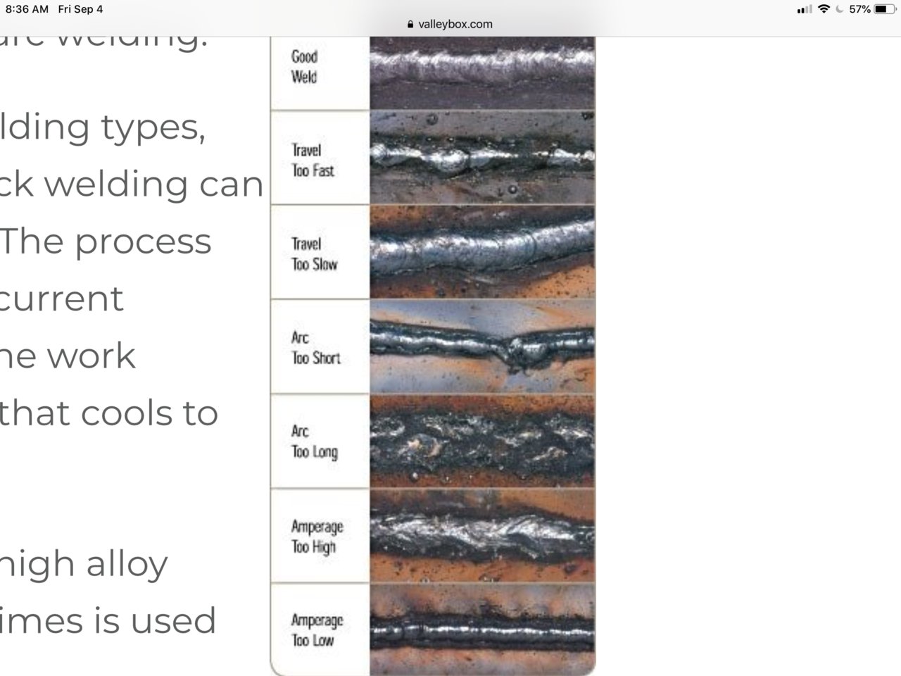

    It’s not that hard with some practice,
    But I might just have a shop do mine because it’s the frame and need some rust cut out and done before winter,
    I’m a stickler for a clean correct welding bead.
