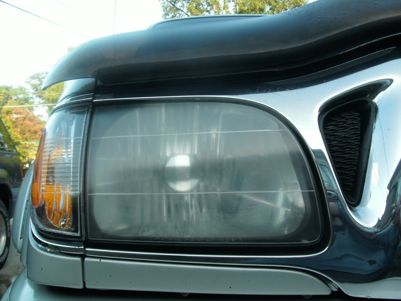

    you can get a new set of headlights on Amazon or ebay for like $50 bucks. if you are not happy with them get a new set.

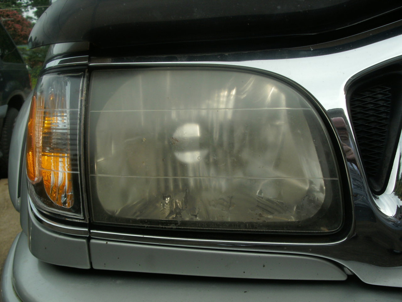

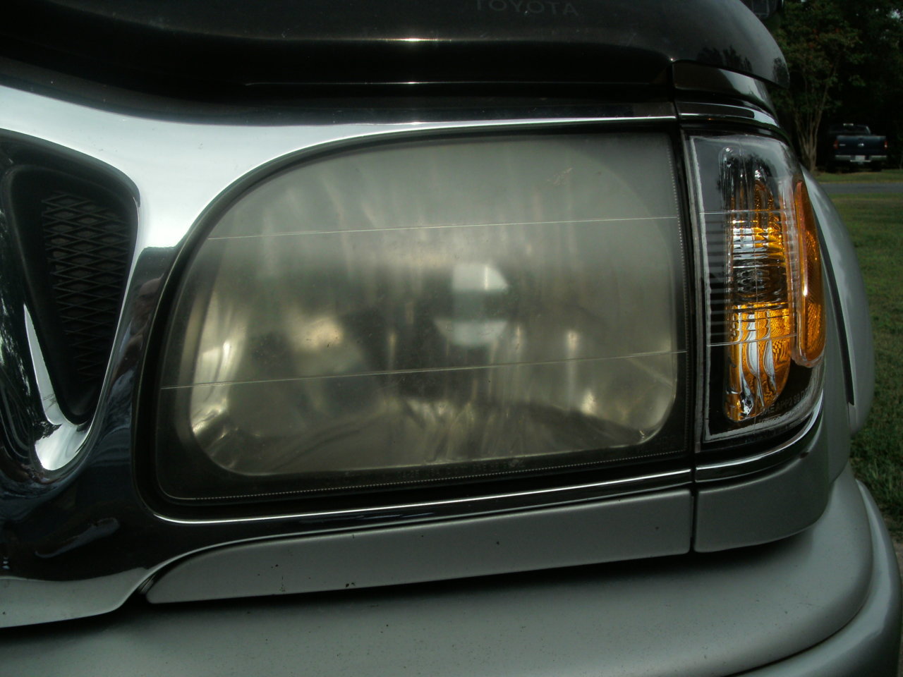

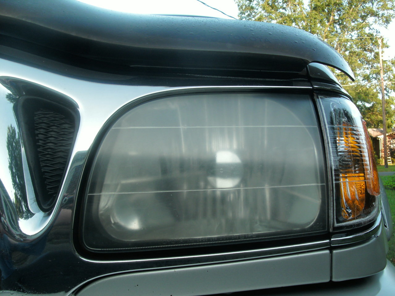

    glad to hear it. Now I know I didn't waste my money. I've heard that cleaning them by different weights of sand paper and then clear coating them in the end is the way to go.

    I used the Meguiars Heavy Duty kit a few months ago and it worked great.

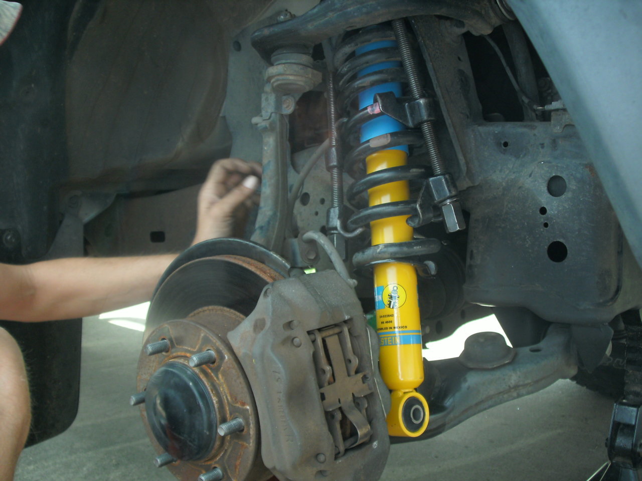

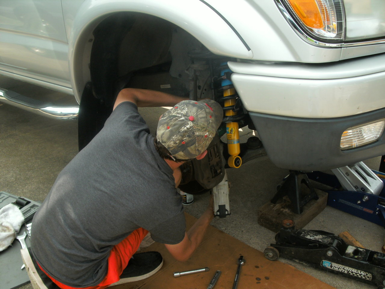

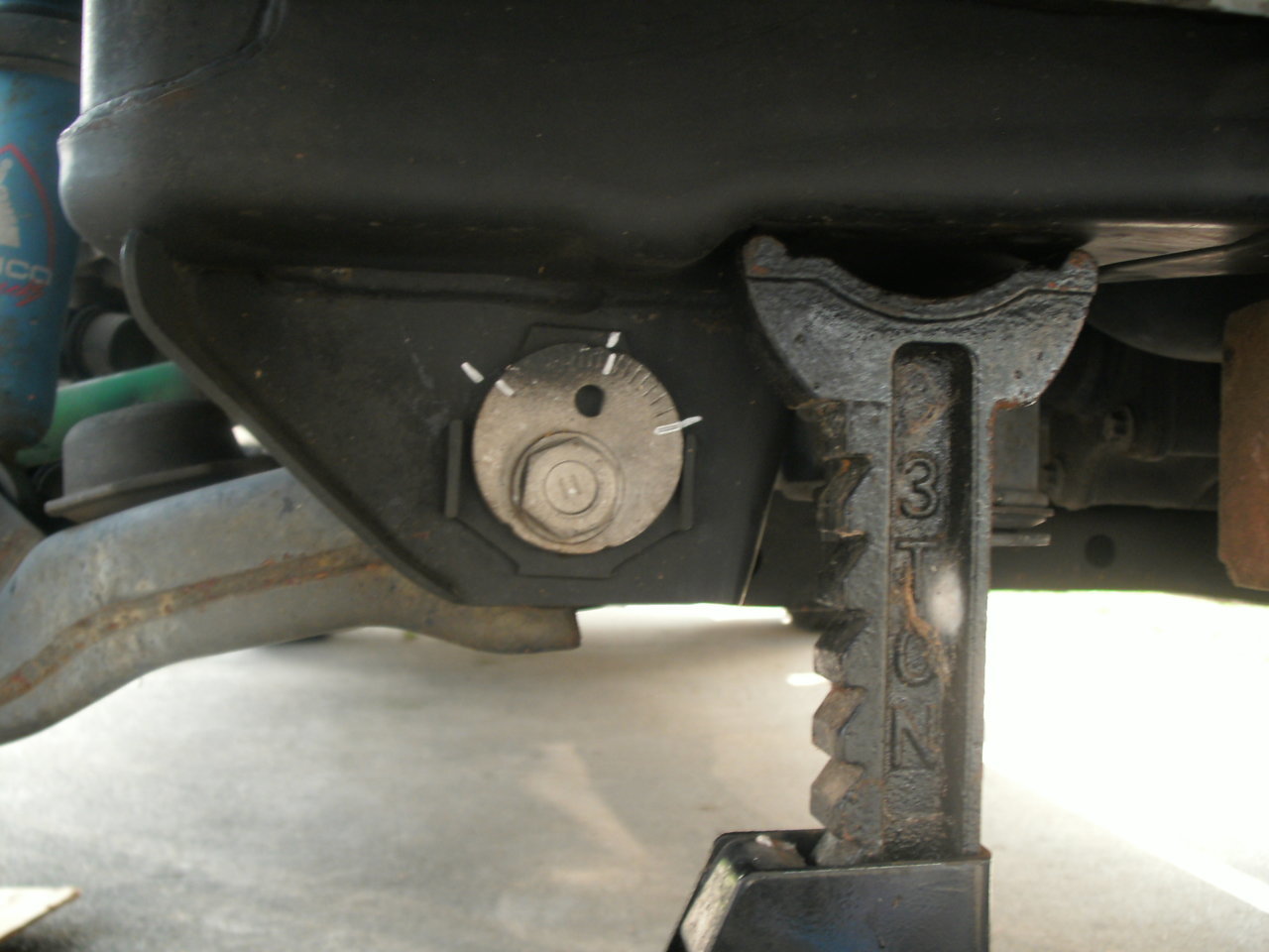

    well I got the passenger shock replaced today. What fucking nightmare that turned out to be. I was just getting started and was going to drop the 4 bolts from the ball joint , disconnect the sway bar end link, mark the camber bolts, and drop the lower control arm. Then my neighbor showed up. Don't get me wrong he's a great neighbor, and always willing to lend a hand. but he wanted to use his spring compressors, and do it his way.I even had my brother stand on the brake rotor to push the control are down, but that dam hole didn't want to line up. 3 hours later w finally got the bottom shock bolt in, but it's buggered up and will have to replaced. I can't believe that dam shock was that fucking hard to push up, so the bolt would go in. Now I'm so dam sore and wore out, that the drivers side is going to have to wait until tomorrow morning, unless I decide to get started on it later today, NOT.
    I'll edit this post later with some pics. too dam tired to do anything right now.
    shock job is complete. Truck rides so much better. Did the drivers side without cold spring compressors. dropped the four bolts from the ball joint to the Spindle, used a small floor jack under the control arm, worked like a charm.Hands are sore as hell today, Arthritis really sucks.
    Here's a few pics, so glad this job is done

    Why did you remove the LCA to get the shock out?

    Or use the floor jack to push up? Unless im misunderstanding?

    When you mark the cam bolts for loosening the Lower Control Arm, do you mark the front and the back or just the one side. Thanks in advance.

    Theyre "x-axis" bushings, weird, but not vulcanized and pivot like spherical bearings but are ?rubber?

    I didn't. I watched a video where you change out the shocks without using a spring compressor. you remove the 4 lower ball joint bolts, remove the sway bar end link. Mark the cam bolts, and loosen them up. Remove the top bolt of the shock, and use a jack to release the coil spring pressure. If needed the Lower control arm can swing free. remove the lower shock bolt, and then just install the new shock in reverse order. Looked pretty simple to me, especially after fighting that dam thing today.

    tried that didn't work worth a shit. tomorrow I'm doing the video version of not using coil spring compressors.

    oh interesting. Haven't heard of anyone doing it like that with loosening the cam bolts
