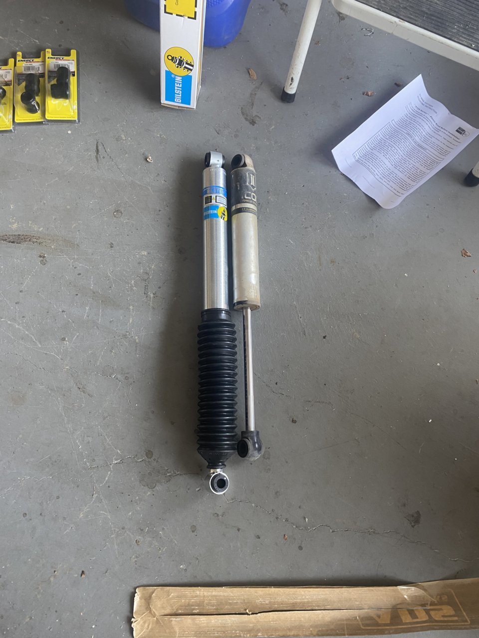

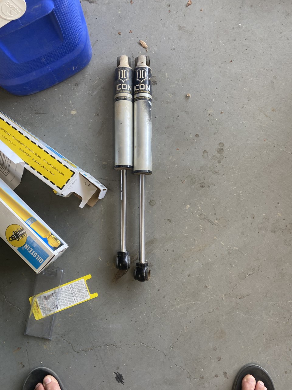

    Passenger side is the longer one, you'll notice the difference isn't about lean it's about the physical placement of the shock mounts on the frame, passenger side is longer because it has to be above the frame for the bolts to clear the exhaust.

    That makes sense, it’s also the side it was on. I really don’t remember doing that haha and there’s no indication on the shock it self. However with that being said I put them on almost 4 years ago and I forget what I had for dinner the night before sometimes.

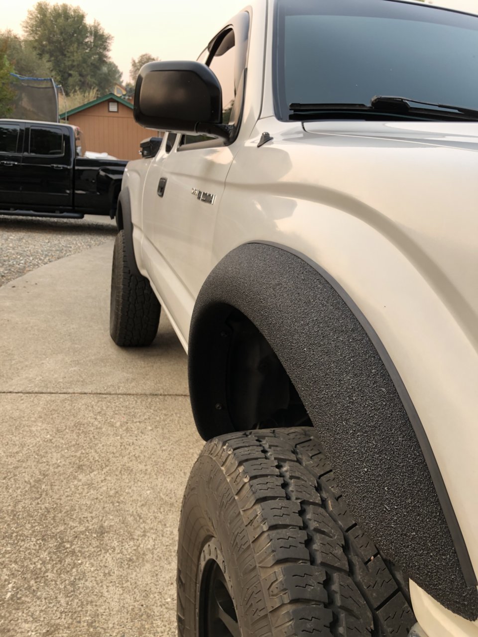

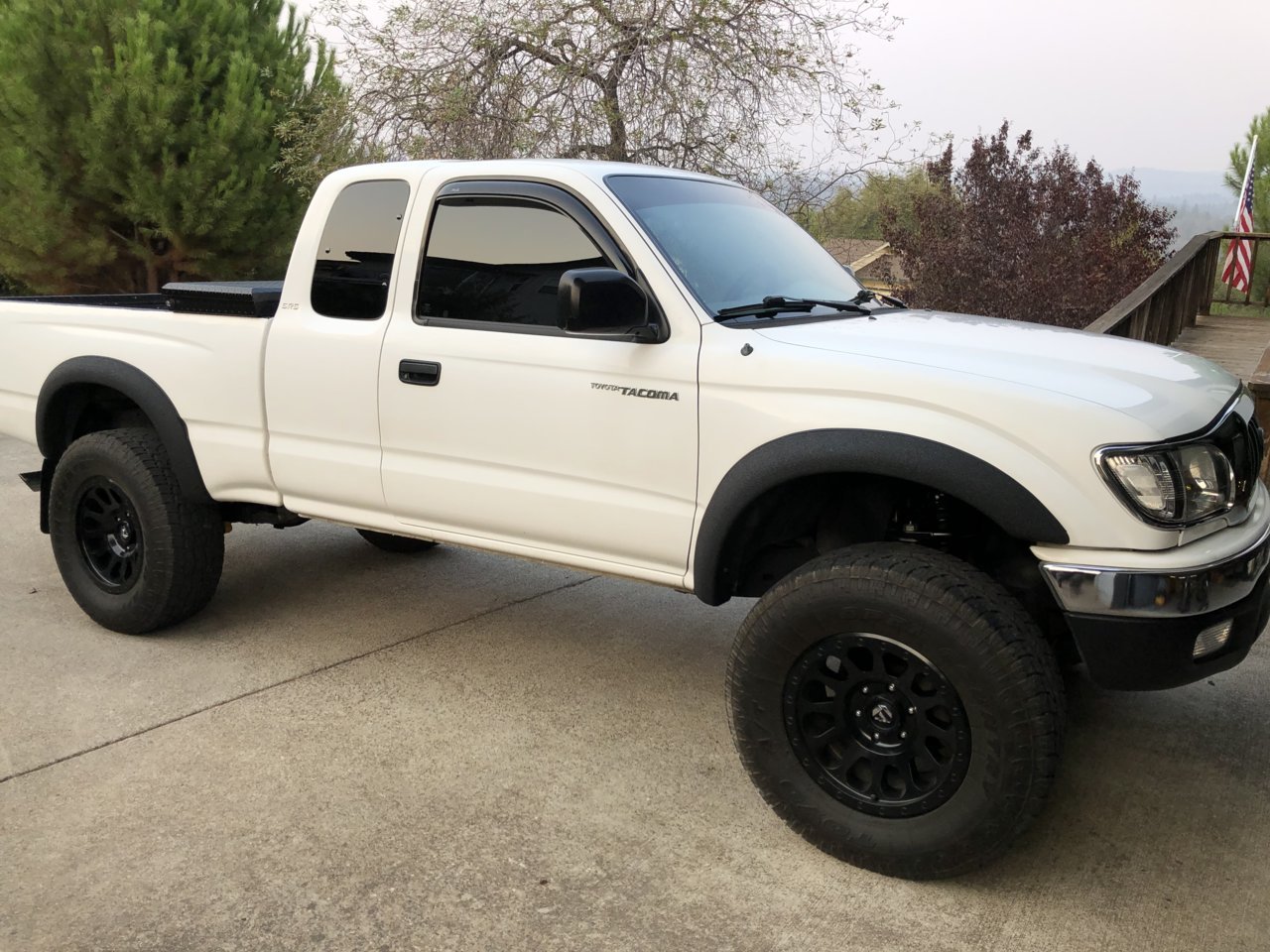

    Finished product. Raptored flares. I give it a 9/10 :D

    10/10 for sure!!

    nice job taping off the rubber. I neglected to do that when I bed-lined the flares on my '99 and it bugged the crap out of me. wish I had just sucked it up and taken the extra hour to do the job properly. looks sweet!:thumbsup:

    I actually removed and replaced the rubber completely so those are actually new as well. Thanks!

    Where did you get the new rubber striping

    From Toyota. I would’ve bought off Amazon which is what I was going to do but I’m moving soon and wanted this done before hand and then would’ve delivered later than I’d like, basically would’ve been inconvenient so I bit the bullet and bought oem.

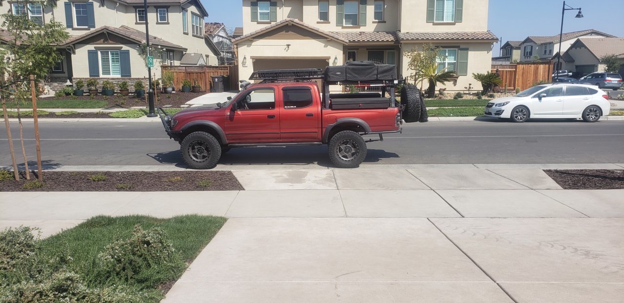

    Installed and ready to gooooooo! I’m very excited about this upgrade! 0202B85C-7B87-428F-AD57-D8CFE5FCE763.jpg 73E28806-1C05-42D3-8DE0-E193A4C414EF.jpg

    i'll be excited to hear how you like them. I'm considering ADS when I upgrade my suspension. what spring rate did you go with?

    650#. I had 700# spring on my icons and they were way too stiff.

    i'm running 620s right now and they are pretty stiff but not unbearable. I'd perfer something a bit softer, but I can live with it as is. Was thinking that on my next shocks I would try and go with a slightly longer spring that was only 600 lbs. all depends on how it is once I have a winch and all the other crap I plan to add to the front end added.

    My trucks pretty heavy. But I think 650s are going to be great. Especially since I can adjust the compression some as well to fine tune.

    I have a plate bumper, winch and 3/16 skids. If that’s your route, don’t go 600s
