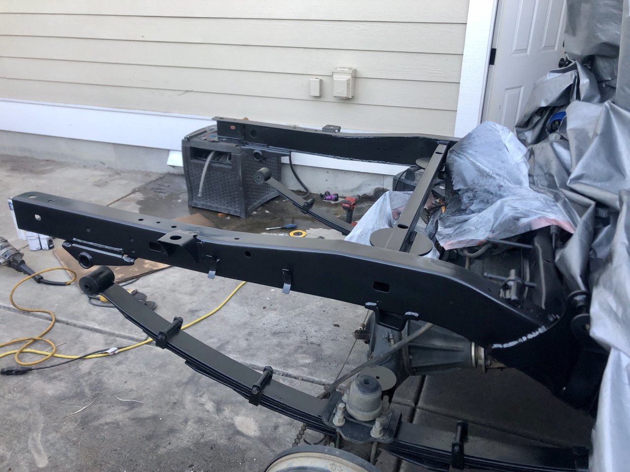

    Does the frame bracket-spare tire bracket just unbolt? To remove? Welded?
    With bed on? Or need to remove the bed to remove this bracket?

    Yeah that rear crossmember unbolts, the tire carrier winch thing also unbolts separately as well.

    Can that long frame bracket be removed, unbolted and removed with the bed on?

    If I remember right, the bolts are on top of the rails, so no.

    Possibly, the top bolts are close to the bed. I'm not sure if you'd be able to or not.

    I'd imagine you can do it by unbolting the bed and just cribbing it. I did a lot of work recently cribbing it instead of pulling it off completely.

    I bet you're right. Usually just takes some really good whacks with a mallet to get it loose if it has never been moved before. It's easy to bang it where it would be hard to retrieve though.
