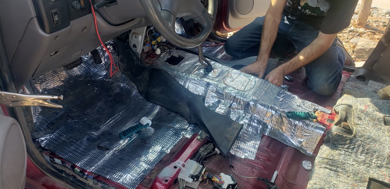

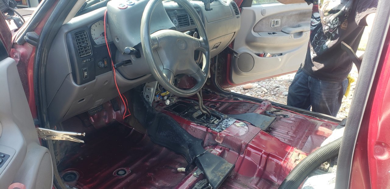

    Sound proofing?

    You mean "sound proofing"?

    Yes, but more for heat proofing the trans tunnel. I also ran it up as far up the firewall as I could.

    Your t-case runs alot hotter than the transmission?
    I remember seeing this with my 5 speed.
    The temp different on the shift levels are very noticeable different.
    T case runs MUCH hotter for me

    The t-case makes heat a foot farther back than the transmission. I wouldn't say the t-case is hotter than the transmission. I'd say the heat from the t-case is in a more noticable spot that the transmission.
    And when you swap from 2wd to 4wd you have to cut out the knock out in the floor board that is a 5 inch diameter hole. With the twin sticks, I couldn't use the thick rubber boot that is on the J-shift shifter... so there was a 5 inch diameter open hole in the floor board, with the t-case directly under it, (and the t-case beather in that spot as well) and the catalytic converter about 8-10 inches away from it. Heat rises, so the heat would catch in the trans tunnel and blow straight in the big hole in the floor board.

    My transfer case shifter is a lot hotter than my transmission shifter. I thought it was just mine that did this.
