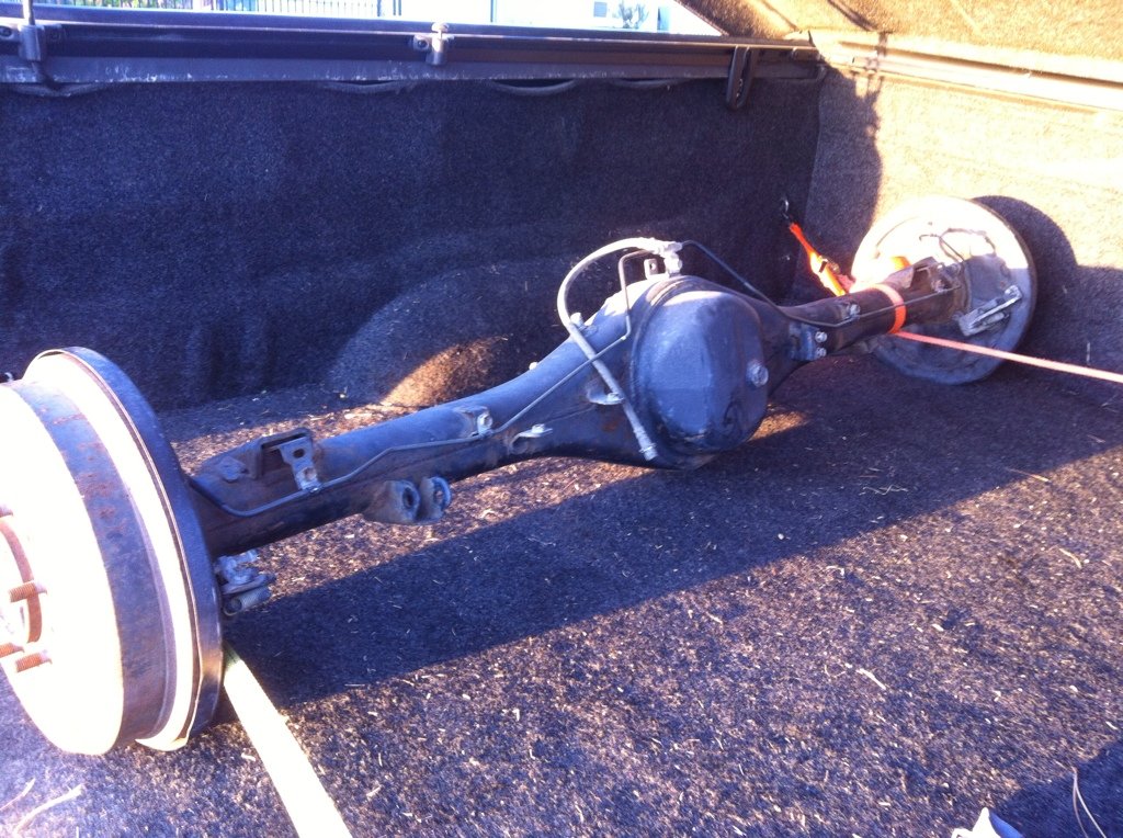

    Time for a 6" wider rearend :cool:

    oooo tundra or T100 axle??

    Factory first gen is 60" WMS-WMS
    T100 is 63"
    Second gen is 65"
    Tundra is 66"
    I went with the Tundra. I got a stupid good deal on it. God Bless retards on craigslists. :D
    The kit I have up front is +7" Having the rear slightly narrower will help on turns and trails.

    Yea i knew that the front was super wide. Have read this helps even the look back out.
    Were you planning on it? or just happened? lol seems with the narrow idea a T100 or Taco axle would be best..
    can you put a 2nd gen axle in a 1st??

    My truck is fucking front wheel drive right now. I needed an axle. I was planning on a Ford 9". If I can make that fucker fit, I can make anything fit. And yes, you can make a 2nd gen work. You just have to convert the 2 separate brake lines to a single drop with a T.
    Since I'm so wide up front (67"), I wanted to ditch the wheel spacers on the rear and have something closer to the same WMS. The Tundra axle fits the bill perfectly.

    yea i like the tundra idea..can't remember who i saw first do that..Mikesdouble cab i think?..what i want to run when i get LT up front just so that the rear won't be so narrow. Hopefully the glass bedsides can hold my rack :eek:
