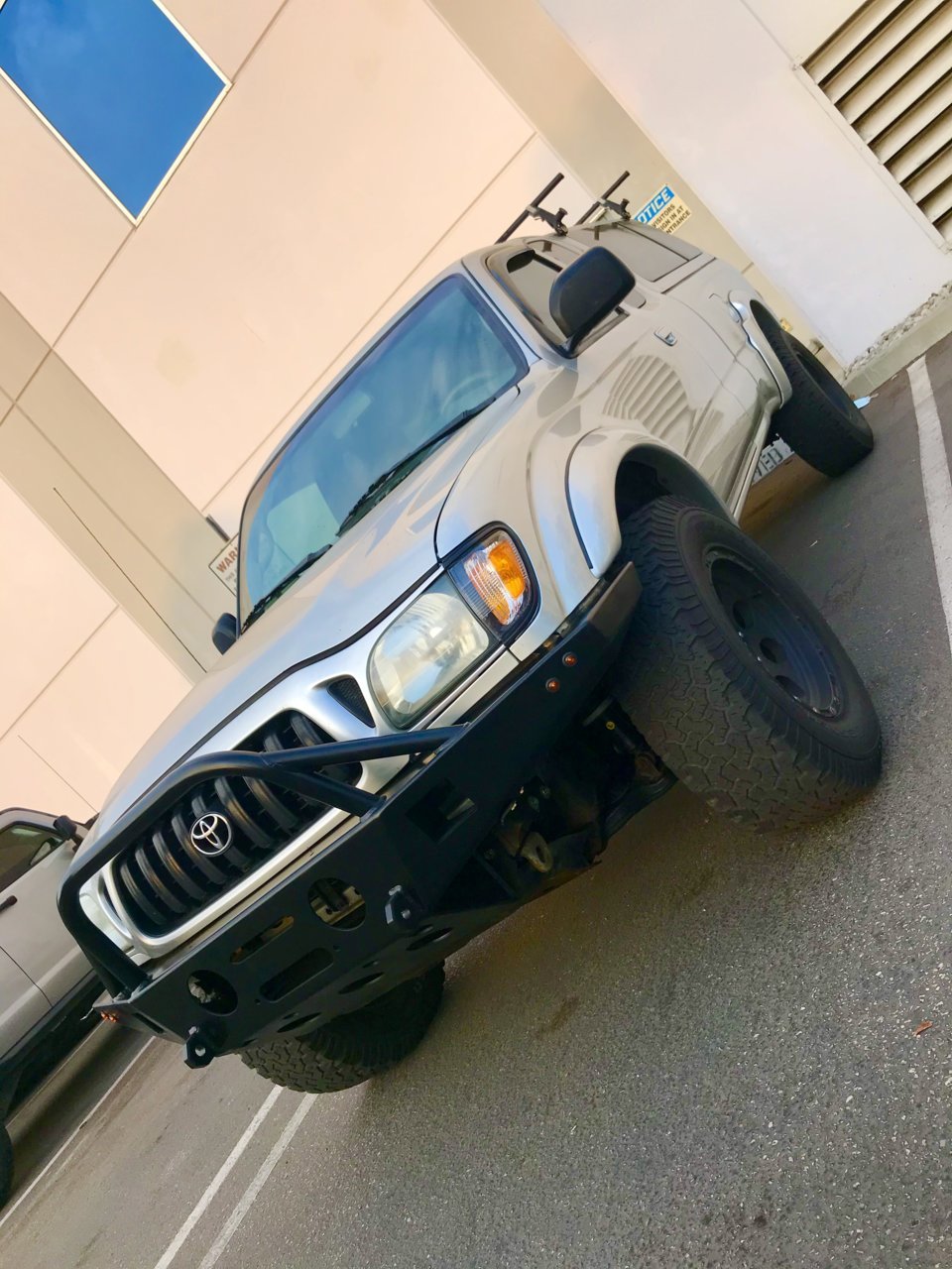

    Bumper looks great!

    Thanks! Its making the front sag a little and creating a some rubbing with the 265/75/16's so I guess I have to pull those Kings out of the garage sooner than later.

    Yeah I bet, that’s a bit more weight for some stock coilovers.

    They actually are aftermarket ones that previous owner had.
    I can't tell what they are but they are indeed very soft. Didn't handle the front end weight in turns before the bumper, yet alone with the steelie.

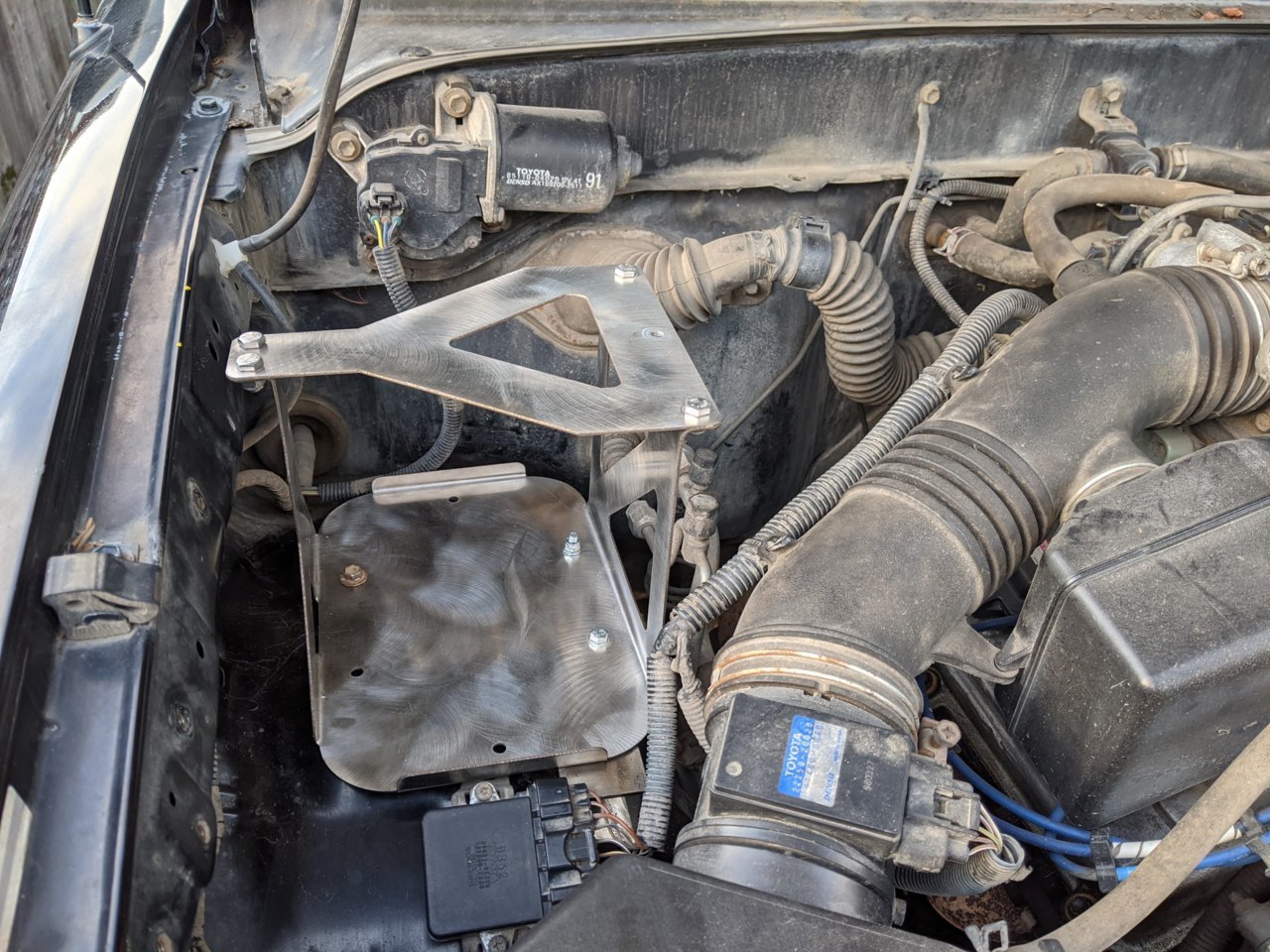

    Battery is in. Very snug fit.
    Turns out with some minor adjusting :)smash:) you can put a Northstar 34/78 into a tray designed for an Optima 34/78 and still have the hood lock closed.
    Although, no more dropping the hood the last 3 inches for me - just to be safe!
    Wrapped some Reflectix around the outside and is so far keeping the battery noticeably cooler

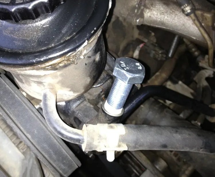

    Does anyone know what the thread size is of the power steering air valve is on a 3rz 2.7L?
    (this thing)
    The doorman one I had on there broke the top off, so i'm just going to plug it with a bolt until I can get the replacement one in that I ordered online.
    Haven't been able to find what the thread pitch and size is anywhere online.
    I think M14?
    Stole the pics from ttora forum
    @0xDEADBEEF @Abeyancer @Speedytech7 @Dalandser @BartMaster1234

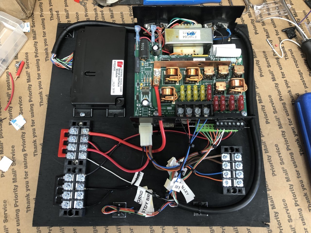

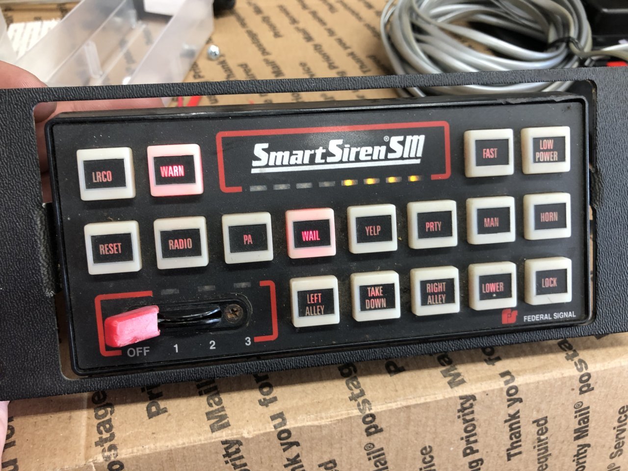

    I’m building a cable tray that sits under the driver’s seat. I’m mounting a Federal Signal Legend lightbar and SS2000SM controller and this is where all the brains and modules live. Was hoping to have extra room for a HAM box for a remote control head, but will probably have to put it elsewhere.

    Nice.
    Clean wiring is an art.

    Thanks, could be better haha. Don’t have much room though.

    Nah man zipties and wire labels are far more than most people would do.
    And those are good labels. Not these stupid things.

    It was really fun labeling all of them. I’m running a 20 year old light and siren controller - but a brand new lightbar which uses a serial interface system. That’s what the black module on the left is for. Older lightbars had a ton of wires running to them for each function, but the newer ones only use power and a CAT5 cable to communicate with the onboard controller.
    Have to disable all of the siren functions, I have two extra relays to play with. I’m probably going to hook it up to my spot lights and maybe some bed lights.
    They used to control the gun lock and lower flashers, which I obviously don’t need.
