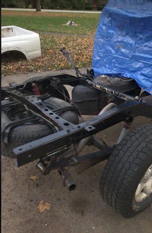

    Sandblasted and primed the back. Gonna shoot it with chassis black

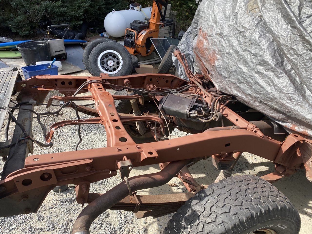

    There’s no going back now.

    My '04 xtracab needs that too. Let us know how it ends up!

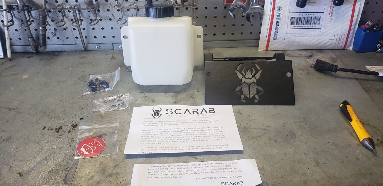

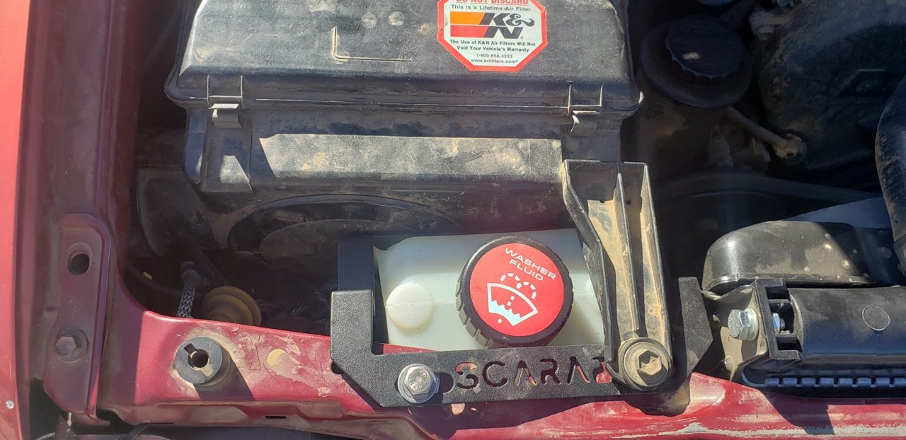

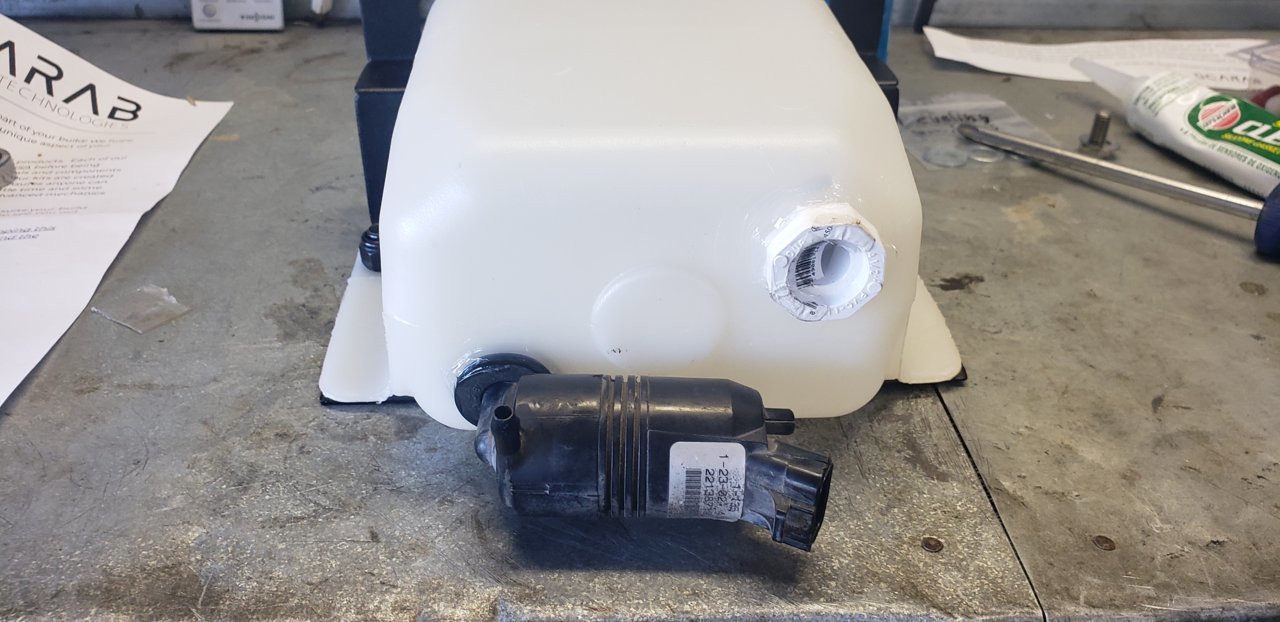

    Finally found a solution I actually like.
    It's made for a 3rd Gen 4runner (2 washer fluid pumps). Only mod needed was to plug 1 of the holes with a 1/2 PVC plug.

    A blind clumsy bear with Parkinson’s would probably do a better job than me haha

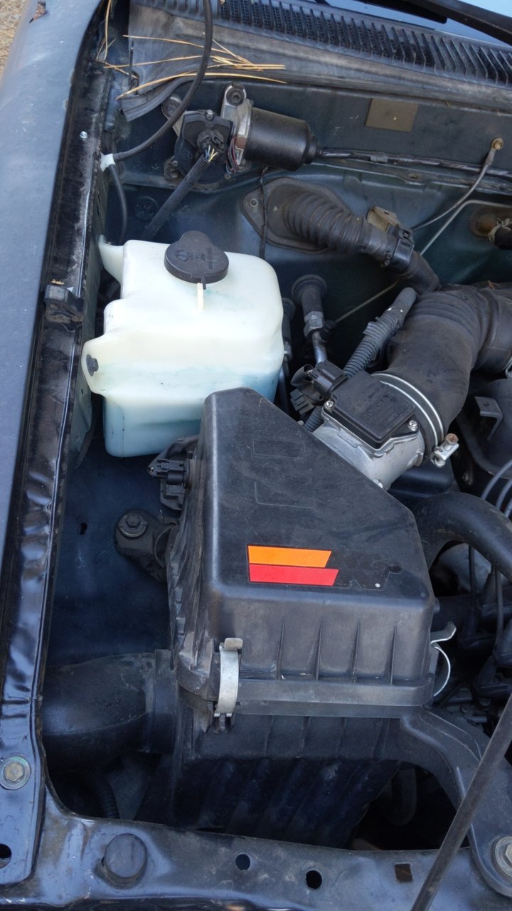

    I was surprised when I saw that this was such an issue on the 6lug trucks. On all the 5 lugs this is how the washer tank is set up.

    how much of a PIA was it to remove the bed? Six bolts, tail lights, fuel filler neck...then off?

    think that will fit my 04? there's room there under the hood. Should be the same plug for the pump...and the tanks are cheap on Amazon.

    This is an OEM tank. I did notice on my part outs if the truck had cruse control that is where it was mounted

    yeah, just walked out to the truck. Thats where the ABS is mounted as well.

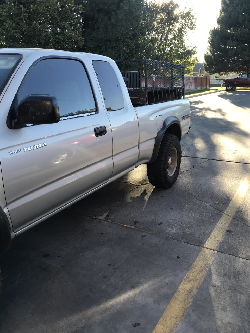

    Bought a dog box, needs little work but not much

    Ya... that location really wouldn't have worked for me.
