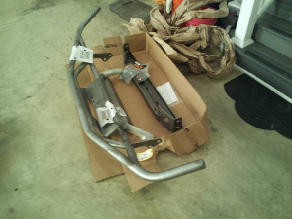

    got this in today. taking it to the shop tomorrow for welding the hoop on and powder coating.
    thought about painting it myself but had second thoughts.

    4,551

    got a double tube roll bar black for the truck! tool box fits and still opens all the way!! ill post pictures tomorrow when i get some sunlightt:D
