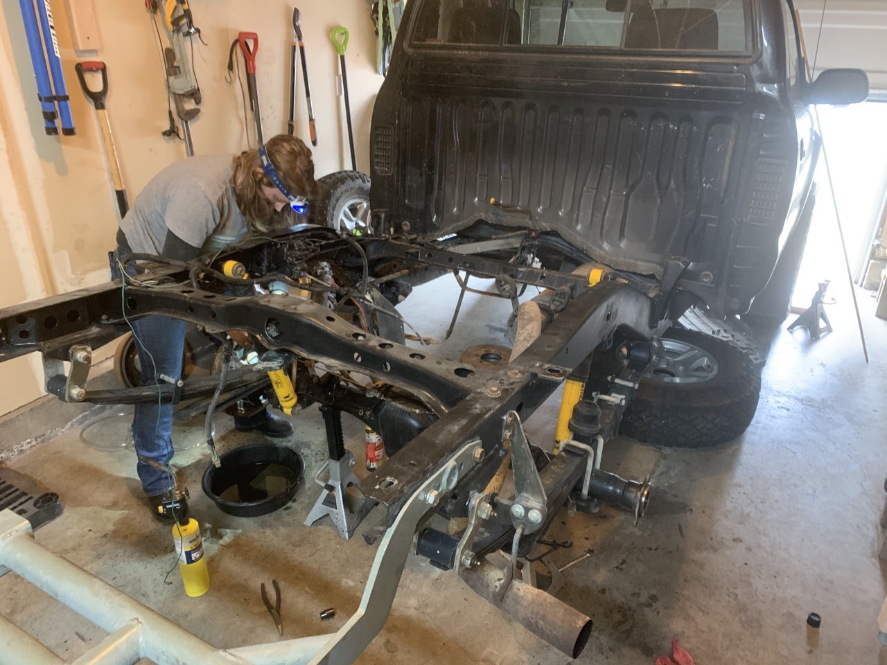

    Swapped in a new scrapyard gas tank since mine had a rusted out fuel sending unit gasket surface. Put in a 4.56 3rd from the same donor truck, replaced rear brake lines and wheel cylinders while I was in there. Decided to leave well enough alone with the axle seals and wheel bearings. Cleaned up and painted the drive shaft and axle, rear bumper, and axle backing plates. Re-greased slip yolk.
    Such an improvement going to 4.56 from 3.91's. No more leaking gas. Didn't break any bolts. Had a friend over to help out and teach her some wrenching. Good weekend!

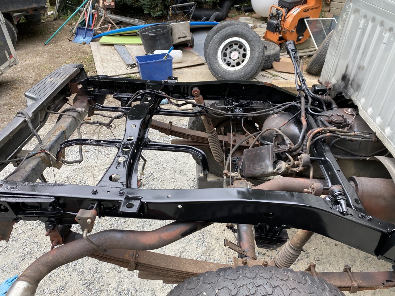

    Some of this Some of that

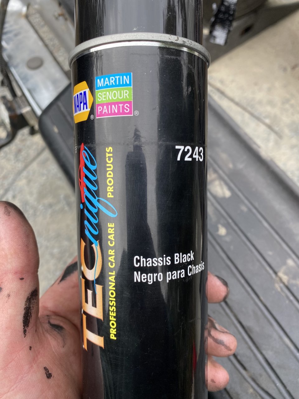

    Used this chassis black from Napa pretty good stuff

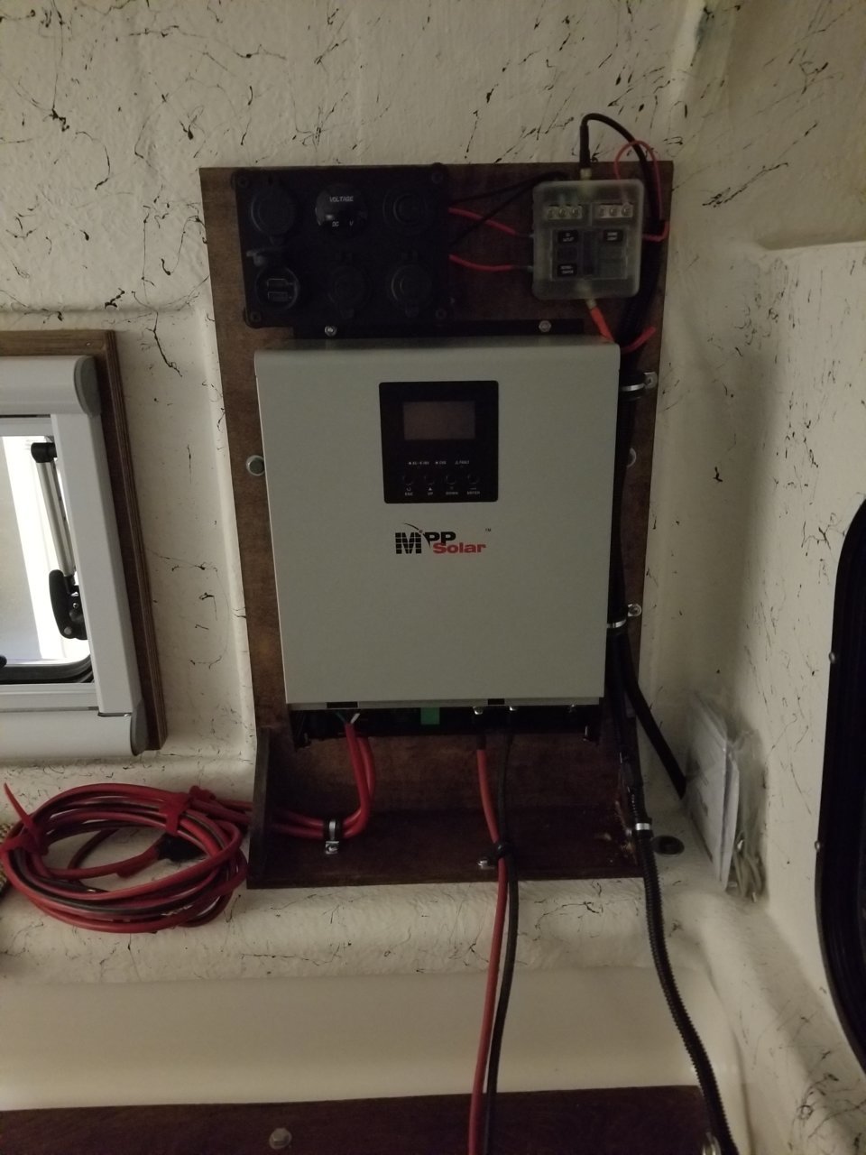

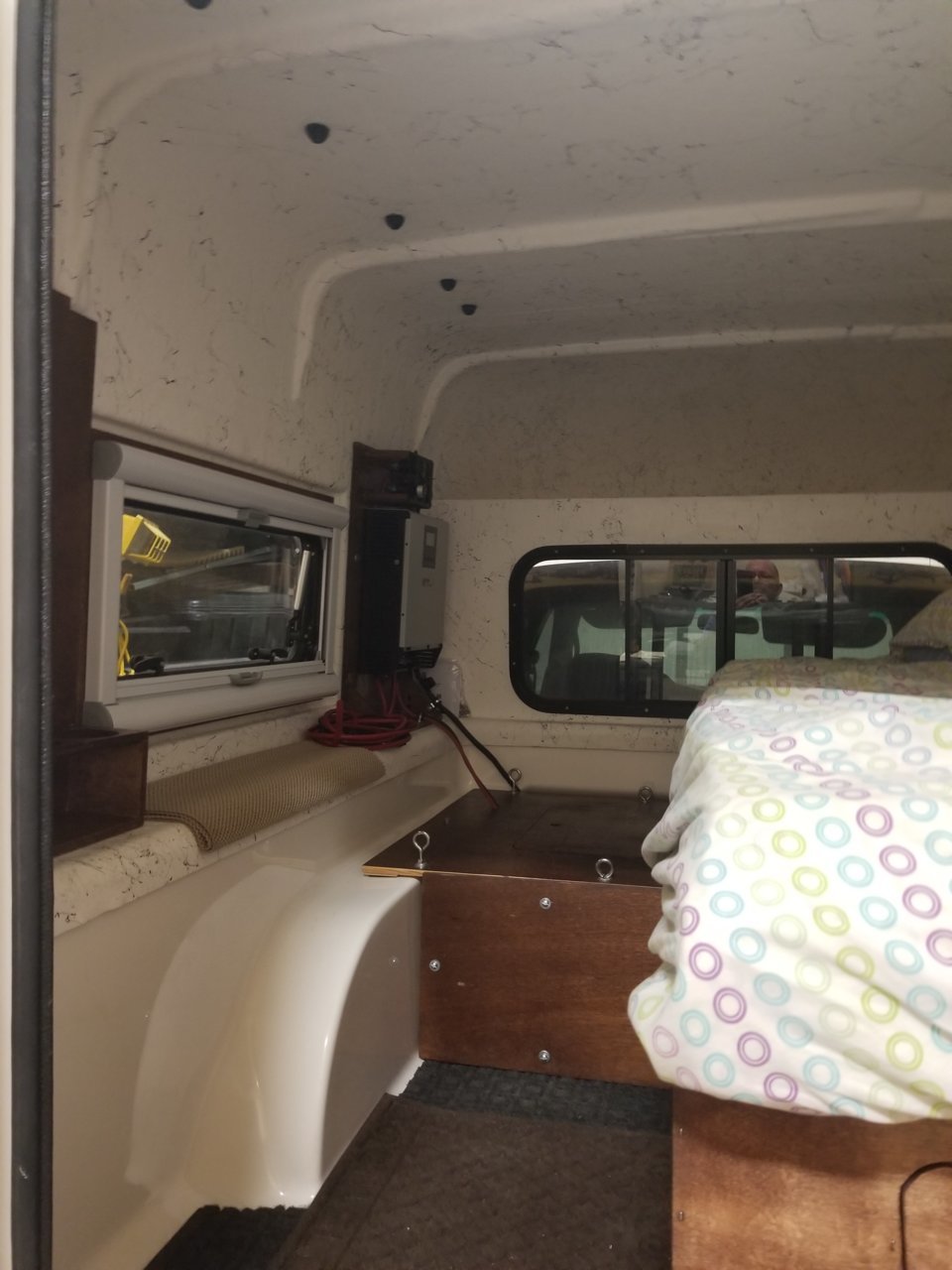

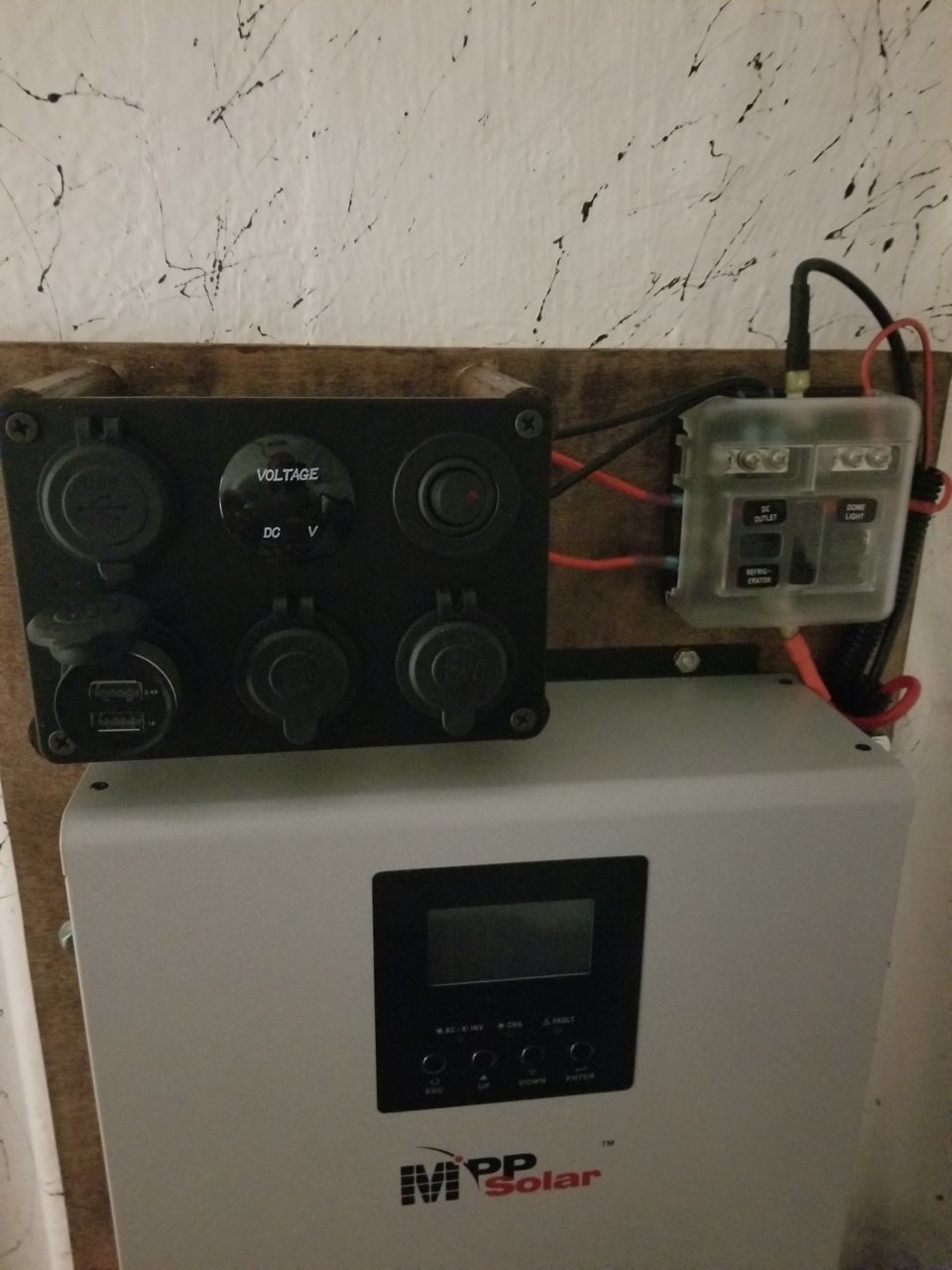

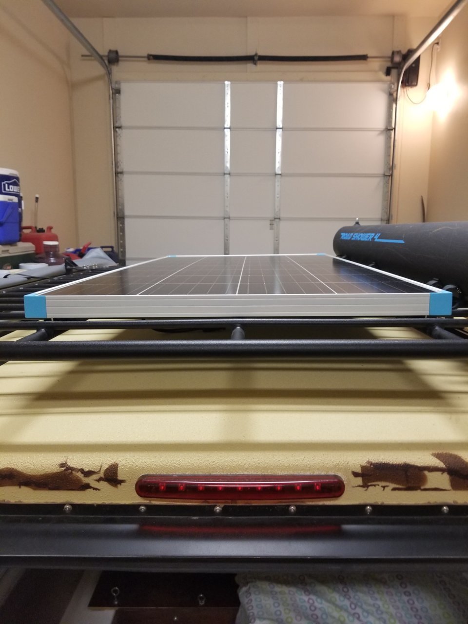

    Installed a mini powerplant in my camper.
    20201012_121802.jpg 20201012_123830.jpg 20201012_121952.jpg 20201012_121847.jpg

    Very nice
