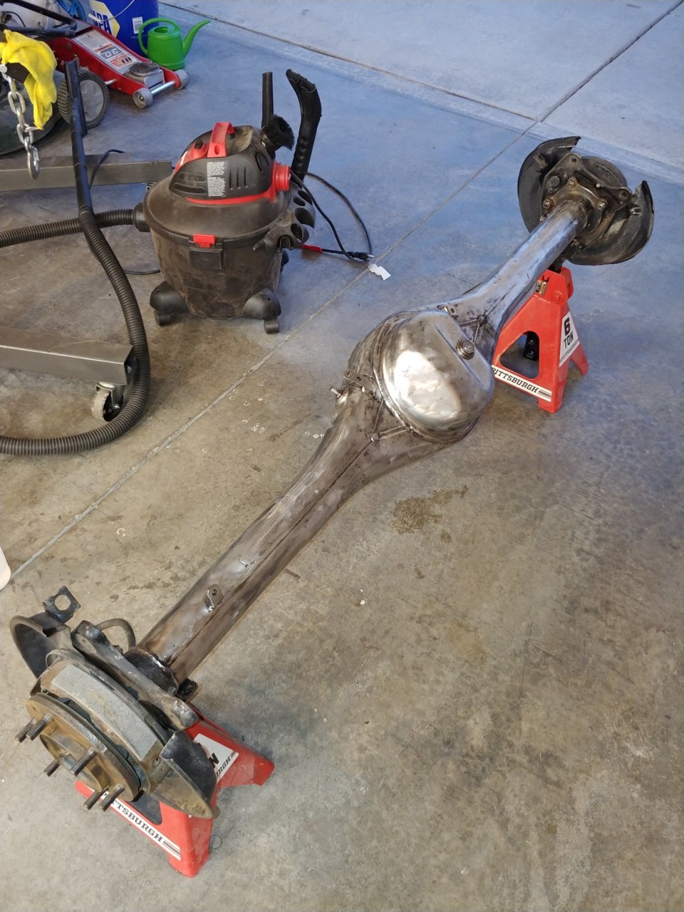

    Sequoia axle is prepped for paint. Denatured alcohol is just amazing. Buying a gallon of that and shoving it in a spray bottle really helped get everything dry and free of particles.

    wheres the truss?

    Can't find one that fits this housing and the decently close universal one I did find kinda gets in the way of mounting for the leafs, sooner it bends sooner I get something that isn't a shitty semifloat

    Relentless has one. Works well. Probably have to ask Eric directly though.

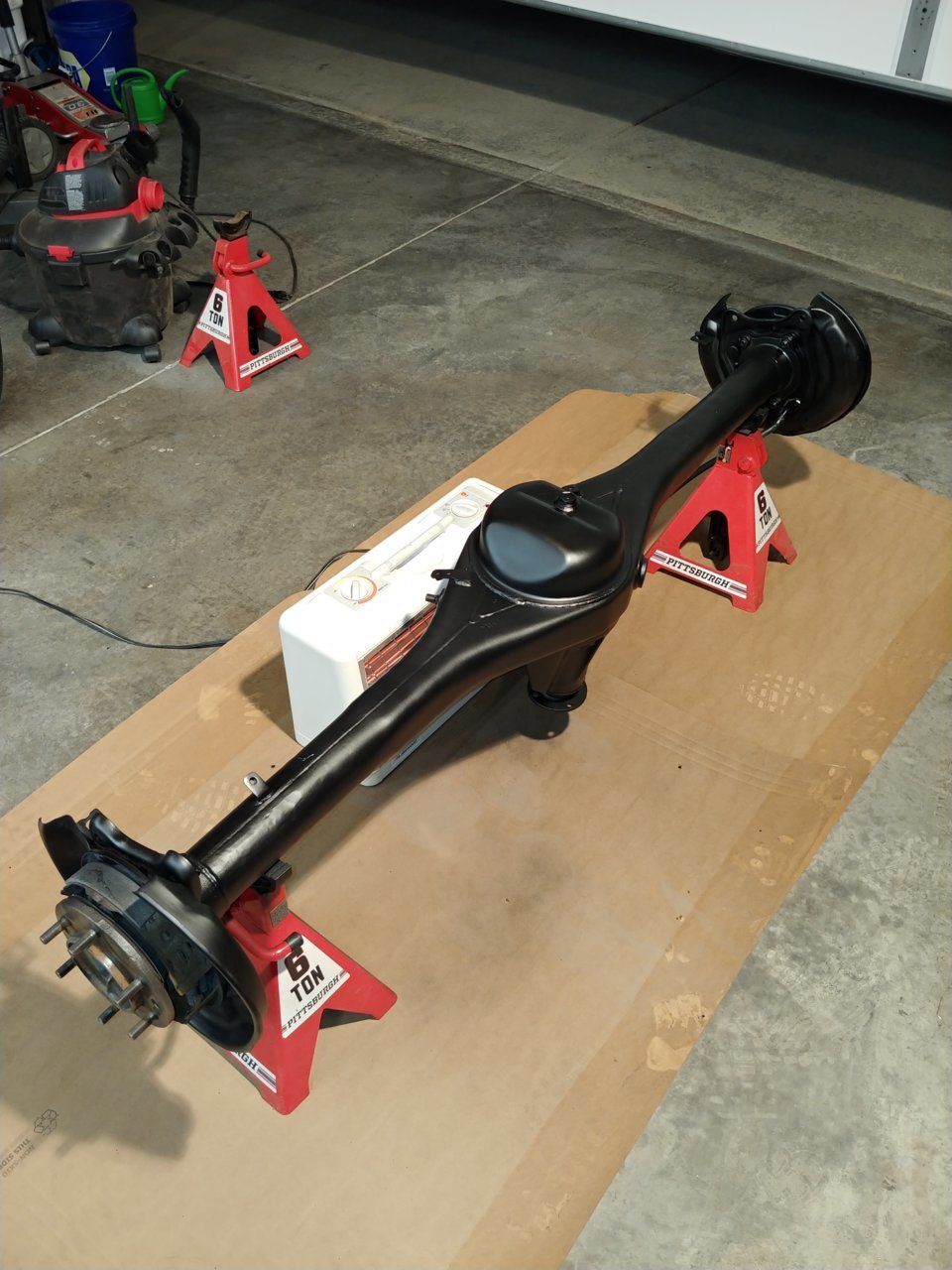

    He must not advertise it. I'm not too concerned though, it's gonna bend axle shafts most likely anyway, and if it bends the tube it'll be between the leafs and the wheel bearing.

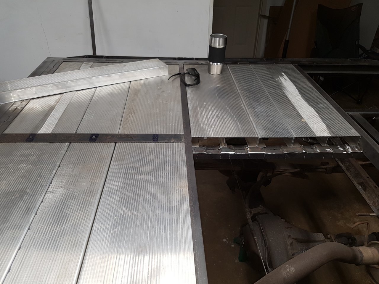

    Working on details and finish welding things. Also, ace wants rediculous amounts of money for stainless metric button head bolts....$3.50 each. Thank goodness for the internet.

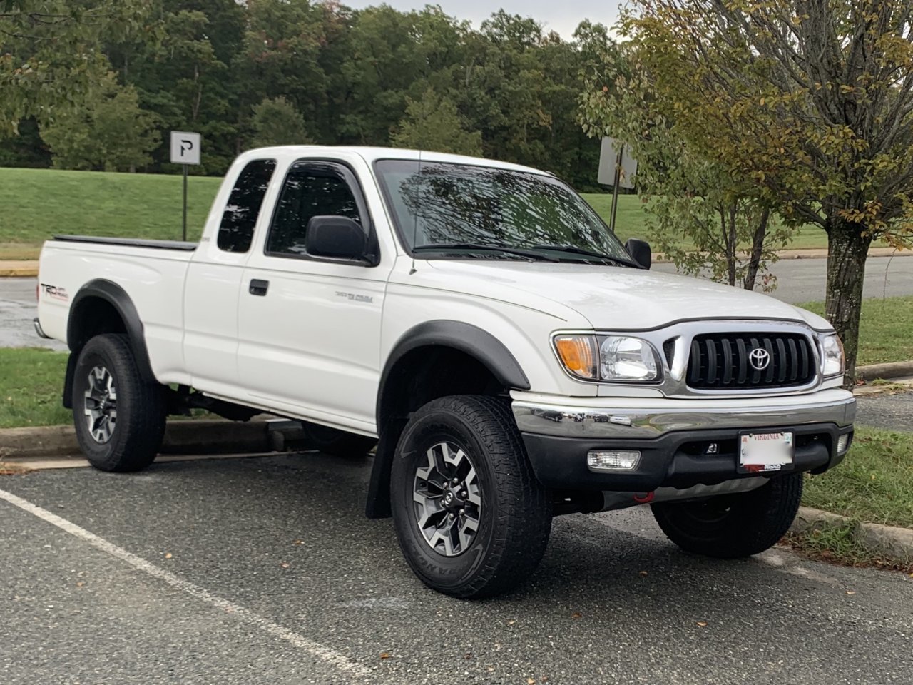

    Cleaned her up a little and solved my persistant P0420 code. Turns out the exhaust seal after the second cat and just before the down stream O2 sensor was leaking. Replaced it, took an extended test drive; no code. I splurged and bought an OEM seal; all in at $14. She's doing well with 281K on the clock.

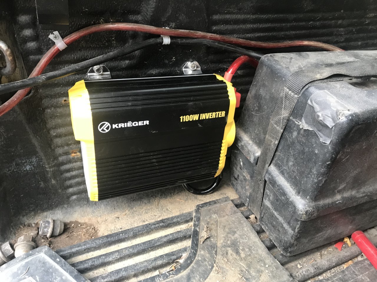

    Swapped out my 500 watt invertor for an 1100, with 2200 peak watts. It was a prime day purchase.
