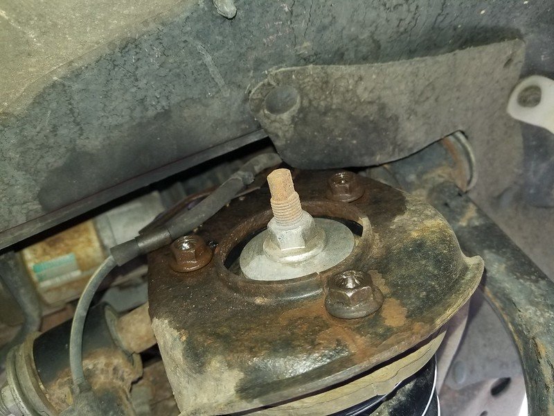

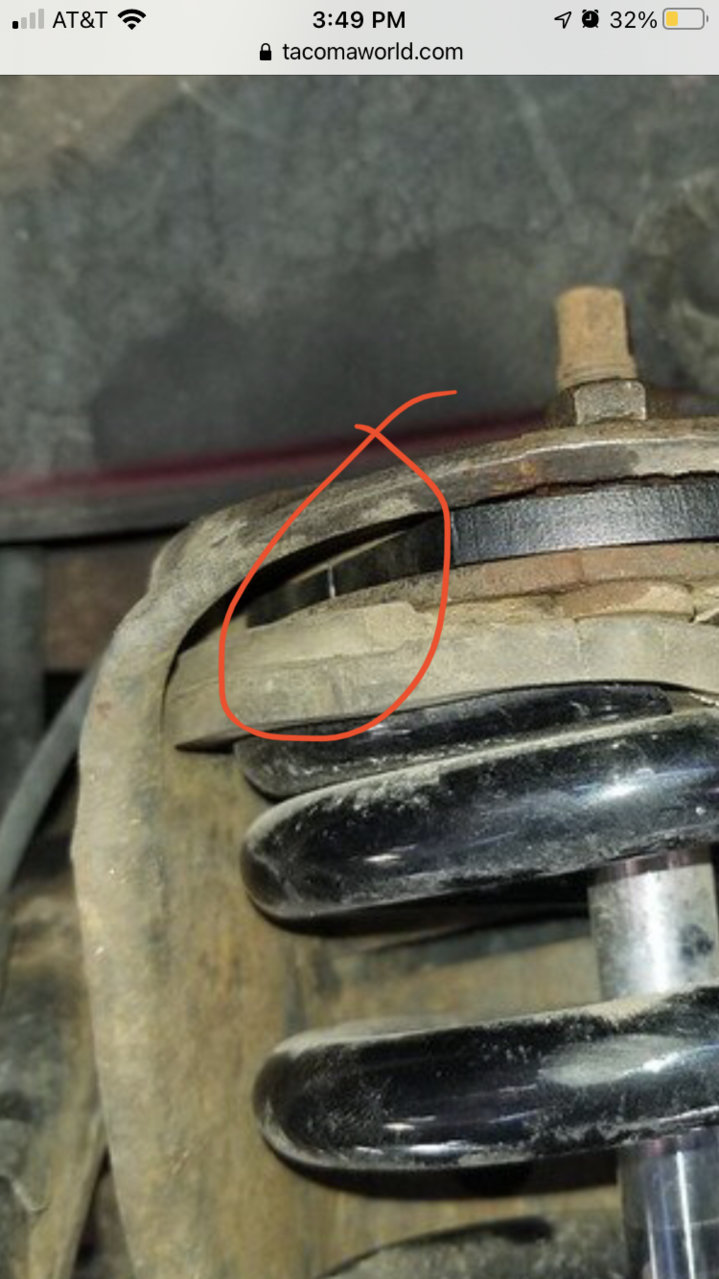

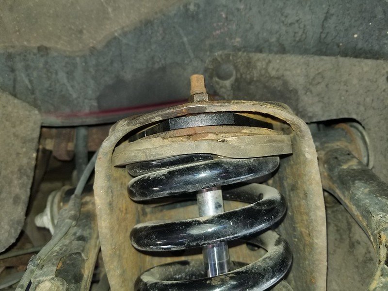

    That last picture looks sketchy asf and that crack doesn’t look like it formed recently to me

    That’s his 1/4” spacer

    yeeeeaaah see that now. Still not right though.

    I mean, that’s where that type of spacer goes, he just needs longer studs. I feel like the shape of the spacer doesn’t help with the stress in the coil bucket.

    Looks like the spacer is triangle shaped with round corners?? Gives a weird optical illusion.

    Looks possibly homemade?
    Definitely going to put a lot more pressure and leverage on those spots with that setup. Would not run.

    I think there's washers on top that's making it not sit on the spacer directly/

    the more you look at it the worse it gets..

    Is the spacer broke too?
    @Mischief
    If you decide to fix the coil bucket, I don’t know what everyone decided the best way to do it is, and still want to run the spacer, I’d look into the OME trim packer thing. I think it’s basically the same thing. But better

    I believe its a triangular shape and thats some sort of casting mark, definitely needs more surface area imo and those studs are way too short

    uh, may want to think again.
    So you push your 1st gen offroad - what cracks next?
    And your studs are way too short for those spacers, you have about half the thread engagement needed for those to torque correctly.

    Shit I did. I saw the crack on the lip but not the full one.
    Also its that damn passenger side again.
    Time to weld it up

    The studs/nuts are fully engaged and I think it would need to crack the steel spacer to get worse so I'll prolly just watch it and see what happens. The crack wasn't there a year ago when those springs were installed. If I have to weld it I will.

    No really. Look at this: So you push your 1st gen offroad - what cracks next?
    I would NOT run that long term. Unless you suddenly want to find yourself without a coil bucket. Which is what happened to us.

    Yeah, I was looking at that link. At least I'm aware of it and can keep an eye on it. That thread is a little disconcerting, a lot of cracks harder to get to than this one. 205,000 miles is a long way
