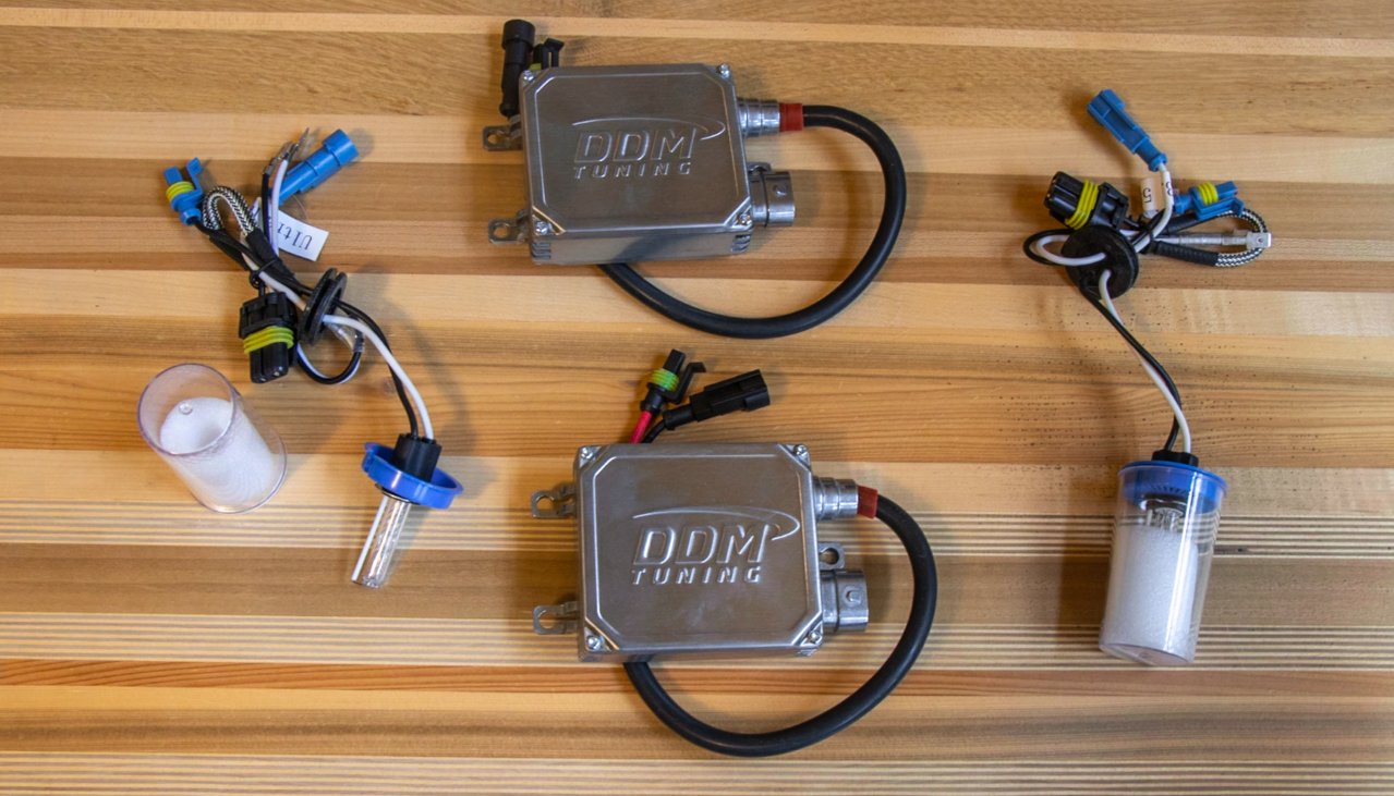

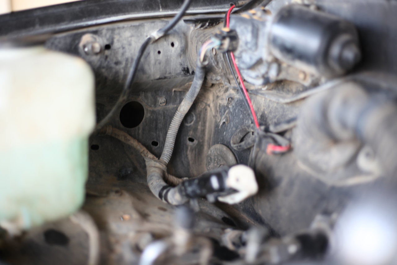

    Interesting. That's why there's a secondary insulator around those wires, huh? Glad I'd sent an email about extensions before just cutting and soldering in my own, hahahahaha. Still might end up going that route - the wiring (gauge) looks simple enough now that I know about the insulation.

    Yeah I made my own. But learned the hard way. Nothing bad will happen your lights just won't fire. When you first turn them on it takes a lot of voltage to get the HID going. I figured it out by turning out all the lights and watching little lighting happen on my bed rack :laugh: A whole roll of E tape latter and all was well.

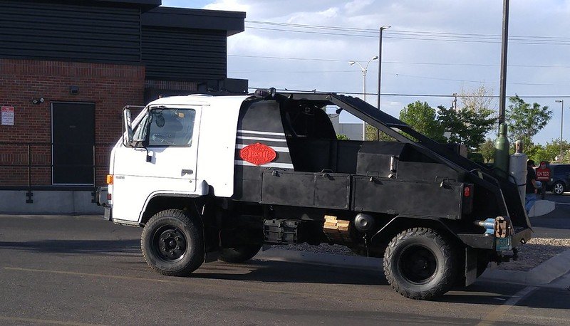

    Yeah, little things can turn into big things in a hurry sometimes. I ordered the plate from @eimkeith so I'll go from there. The pix from your's are pretty spectacular, it looks like it hammered the shit out of itself. I pretty much drive like an old lady but still, there is a crack
    I've been driving junkass trucks for a long time so I pretty much look at them expecting some shit lurking in the shadow's. This is only the second one that has made it over 200,000 miles.
    This was the first, still my favorite but I got tired of riding a tank

    that thing's rad. Curious on what's going on with the backhalf of it. Ramp for loading ATVs or something? Work truck?
