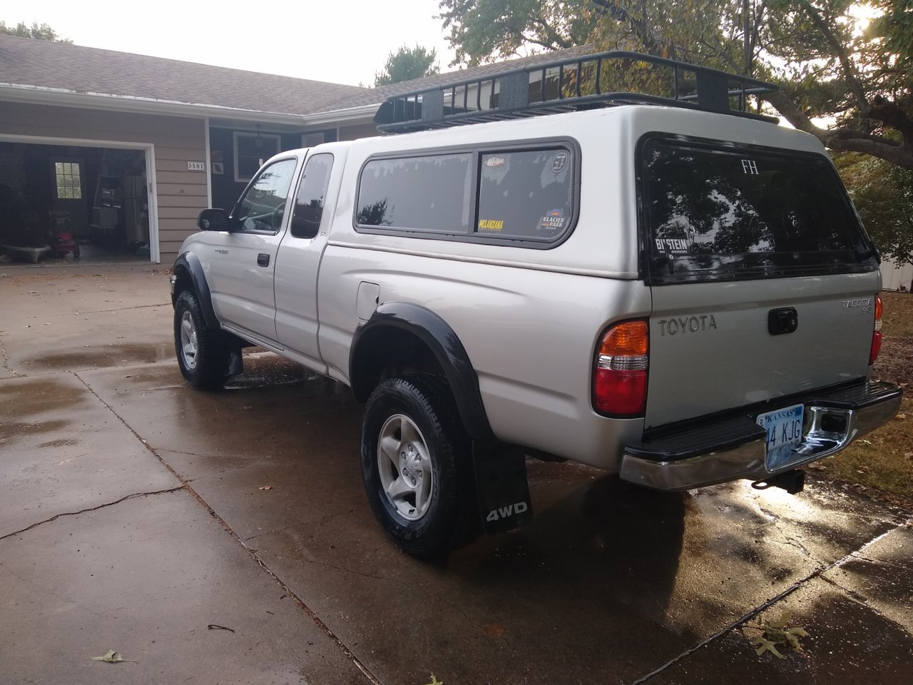

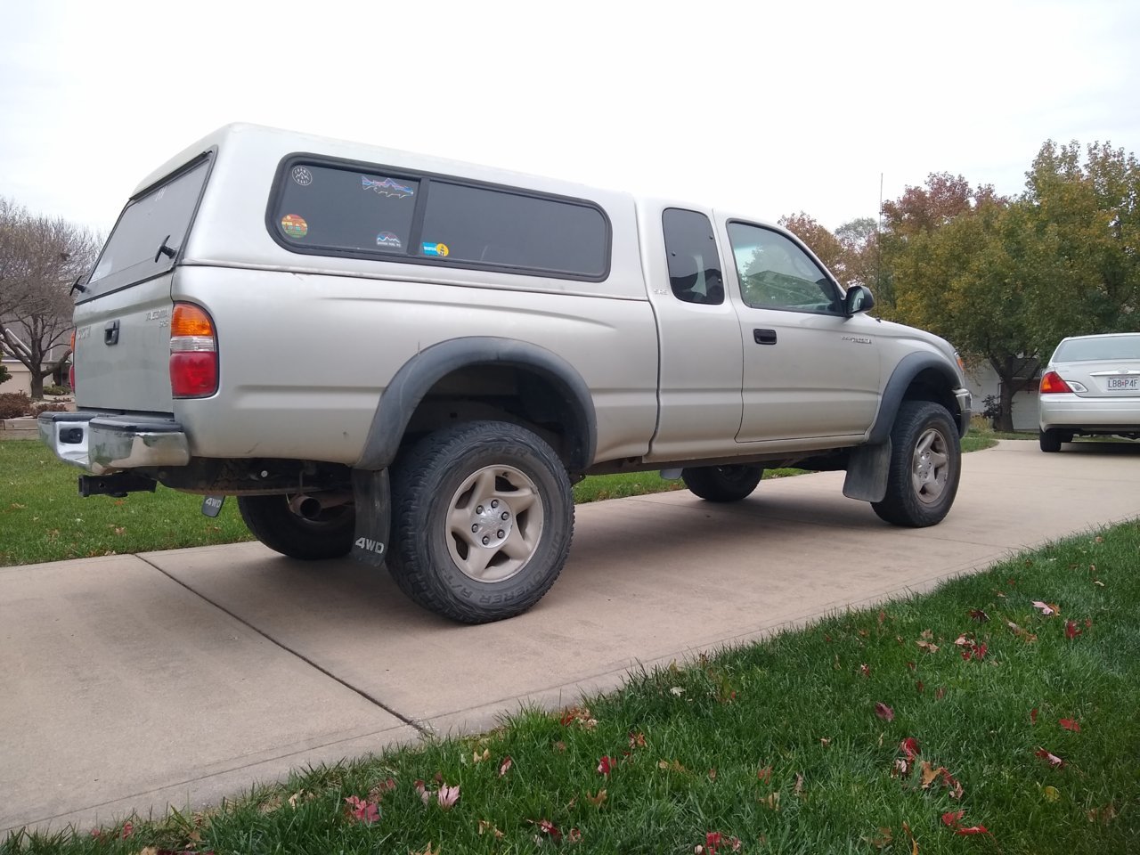

    First time posting here, what's up y'all. This past weekend I put some billies, 881s, and all pro expos under the old truck. It was sitting several inches below stock height beforehand sine I carry 400 lbs in the back full time. The leafs were frowning! I think I gained 4 inches in the back (after taking 1 leaf out of the expos) and 2.5 up front. Got some bed liner on the roof rack as well. It was starting to rust like crazy. Up next is a set of new rubber, those tires are looking tired and tiny!

    Is that a Curt rack? Looks like one that I had. F'n thing rusted up in about 3 years, even with painting it a couple of times.

    It is, picked it up for $50 from a guy a few years ago. Same thing happened here after having a fishing rod holder and canoe up there from time to time. I sanded it all the way down, metal primed, and put probably 3 coats of bed liner on. We'll see what happens I suppose...

    Welcome! what made you remove a leaf from the expo pack? With 400lb of tool weight plus a cap, you may want to consider keeping that leaf. Expos are rated for 500lbs over stock weight. You may decrease the life, something to think about :notsure::notsure:. Also they will settle after a while.

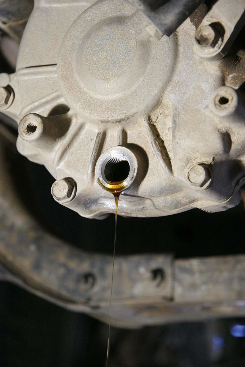

    I am wondering if anyone else has ever had their t-case disengage (on it's own) while in use?
    On a recent adventure, while hauling ass up a steep, winding, well graded dirt road, in 4hi going somewhere around ~40 mph, mine seemed to disengage when I backed out of the throttle a bit going into a corner. I both felt it and heard it. Sounded awful, like gunshot with grinding noises. I thought I had blown up the rear diff or something really serious.
    Immediately pulled over and parked. It seemed to be running fine as a rolled to a stop. Upon inspection, we were unable to find anything wrong. Was bizarre.

    I recall you mentioning your experience when we were all gathered trying to figure out what had just happened to mine.
    I drained my t-case today. No mud in mine.
    This oil has about 20K on it. I would normally not change it for at least double that. But I wanted to confirm its condition based on what your experience was. As you can see, it is still in pretty good shape.
