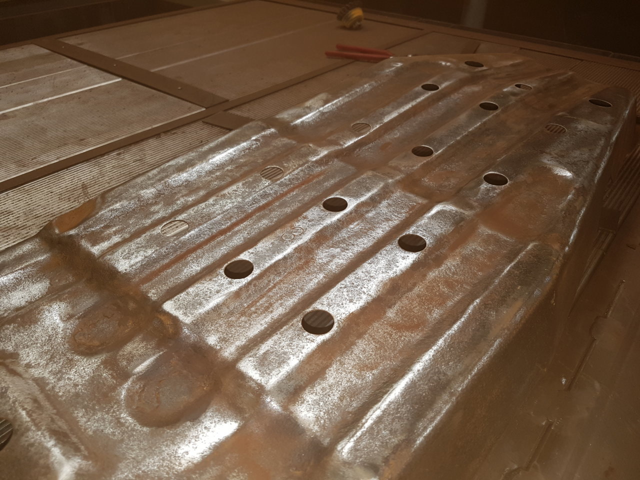

    Cleaned up my gas tank skid, brainstorming ideas for reinforcing it. 20201021_192846.jpg 20201021_202054.jpg 20201021_210005.jpg

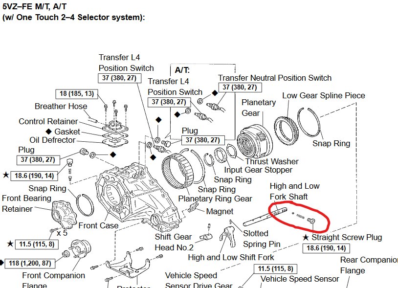

    You can get a stiffer shift spring for the stock case to help remedy popping out of gear between hi and lo range. Should be the same on the push button t-case
    as the J-shift. You just don't have a shift spring for the front drive fork shaft since there's an actuator to engage it instead.
    https://www.marlincrawler.com/transfer-case/parts-upgrade/shifter-parts/tacoma-shift-spring

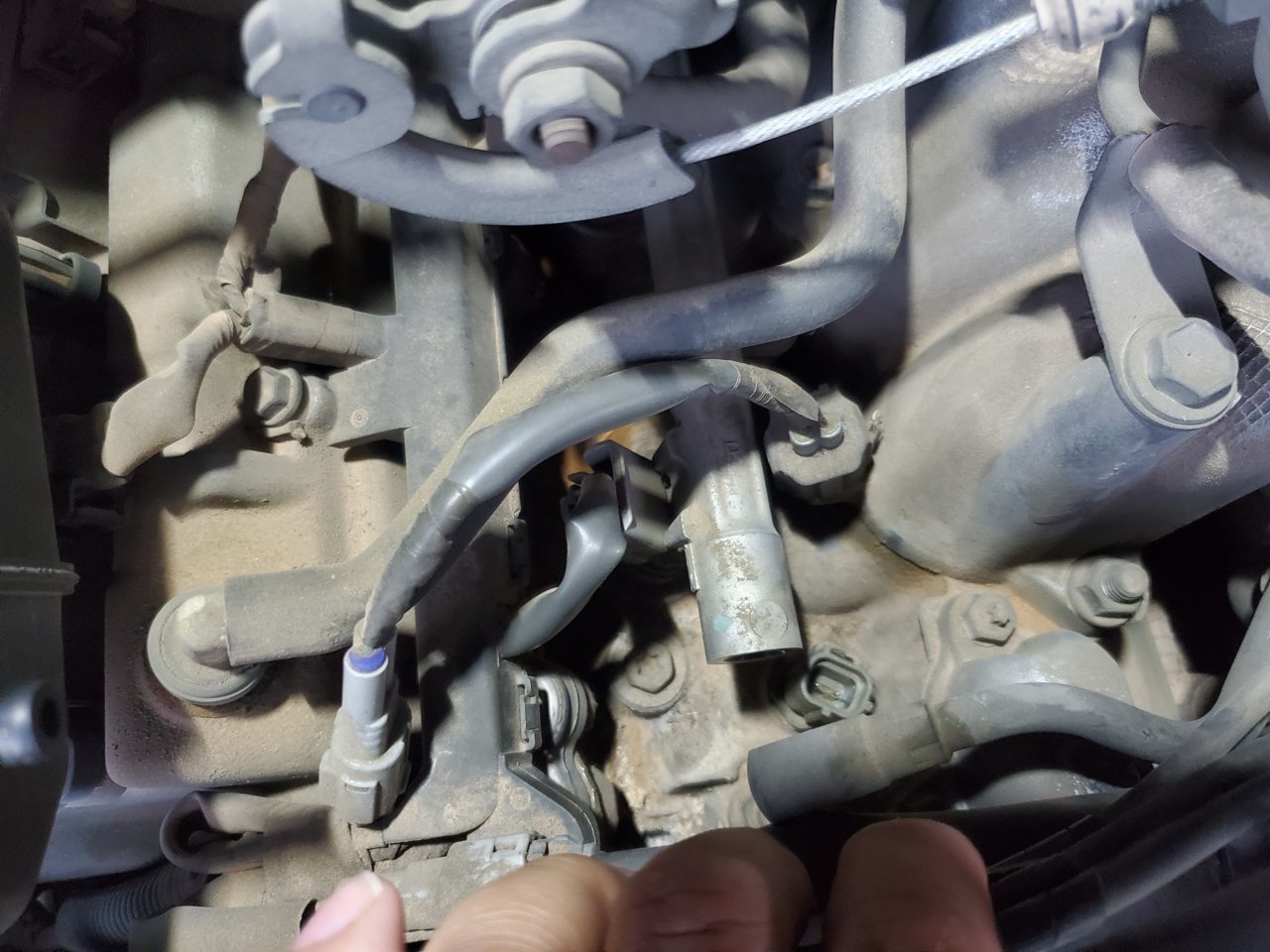

    15hr drive each way, several hours more of driving+wheeling, all over the weekend, and fortunately the only thing that went bad was an engine temperature sensor.
    Looks like the one I had was an original. Not bad for 264k miles.
    When you do this, don't forget the two washers at the bolt on the fuel rail, not to mention the washer on the temp sensor.
