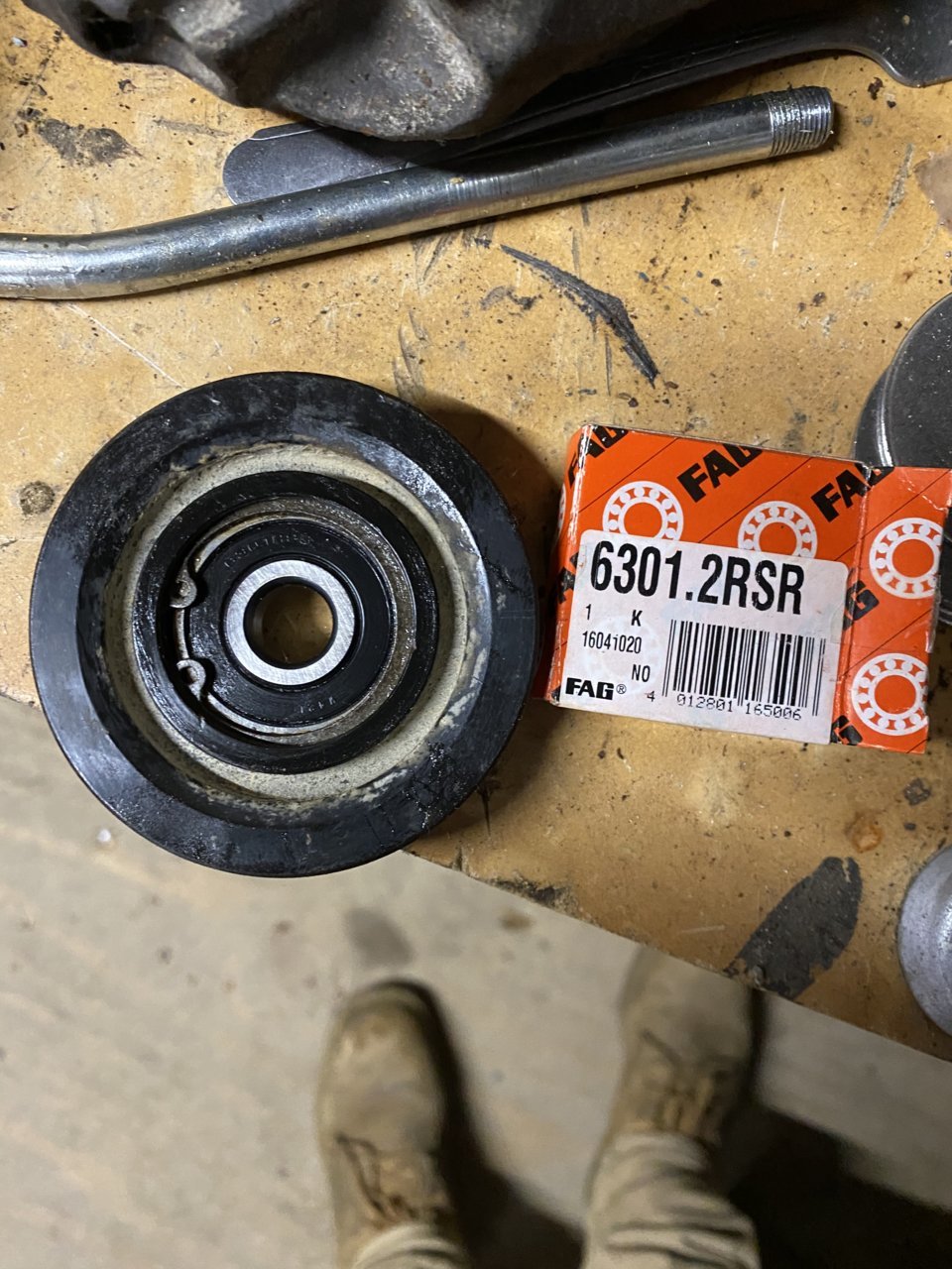

    New idler bearing

    I have a feeling I may need to do this soon. What are the symptoms?
    I'm starting to hear a squeeking coming from the front (seems like) passenger side. It isn't that loud, but I hear it. Hasn't gotten to the point where I've really stood next to the truck or with the hood open to nail it down... yet.

    Mine chirped and grinded pretty badly when it was going out, not all the time but got progressively worse. And would get louder/quieter depending on RPMs
    If you go through a lot of mud, snow, water etc they tend to not last very long
    Also it had wiggle play to it when you moved it by hand, no good

    I had a grinding almost squealing sound coming from the front, had to get underneath to tell it was the idler. Didn’t really have too much play. I had done it recently and used a cheap bearing. Got a nice one this time

    Double checking... looks like this is the one.
    https://www.ebay.com/itm/323447397404
