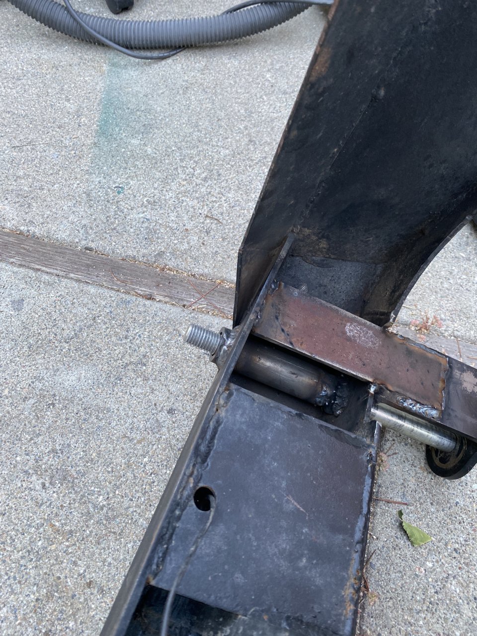

    Last ditch effort to get my swing out slop/sagging fixed. Pretty sure at this point if it’s sagging it’s the bumper itself needing reinforcements.

    Is that 1in plate?

    It's less Tacoma and more mod
    Looks like 1/2, maybe 5/8

    Yea probably just the picture, but looks mad thick

    get a side shot toooo, looks tits tho man. nice n thick

    3/4” bar. Beveled the edges on the bar and the c channel and heated the bar with the torch before welding it in.

    seems beef.
    But I can pretty much guarantee its the bumper flexing be my bet.
    He's showed behind it before, it has no support
    m3bassman likes this.

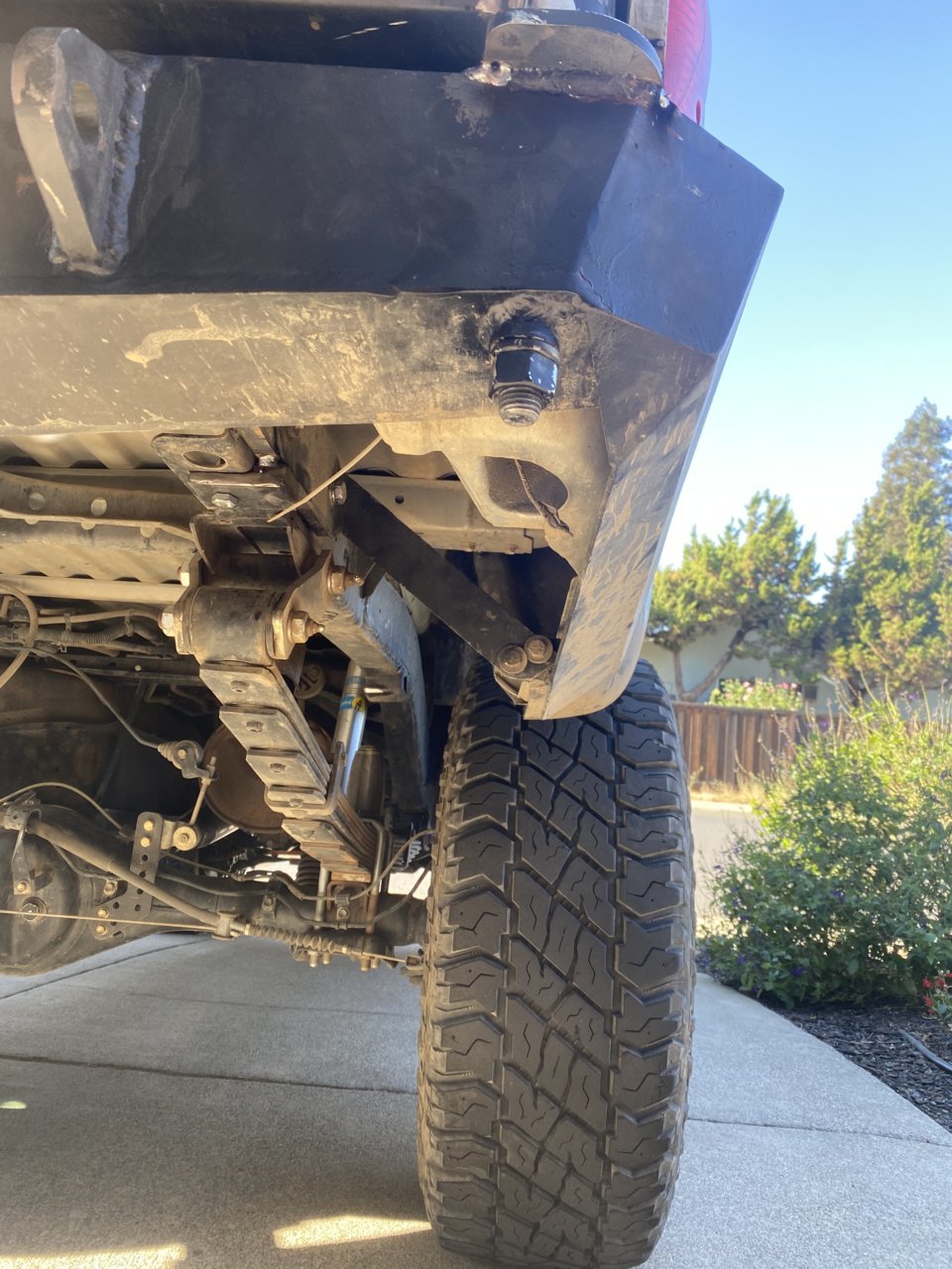

    since the last time I showed it I did welding in more support though. EC1AE749-69D4-4DE8-BCE1-89F1839317ED.jpg
    there is also 1/4” the is perpendicular to the other 1/4” that I welded in first

    That's really not enough, you have a massive lever on a lever on two pieces of c-channel.

    Would boxing the rest of it help? I’m running out of ideas.

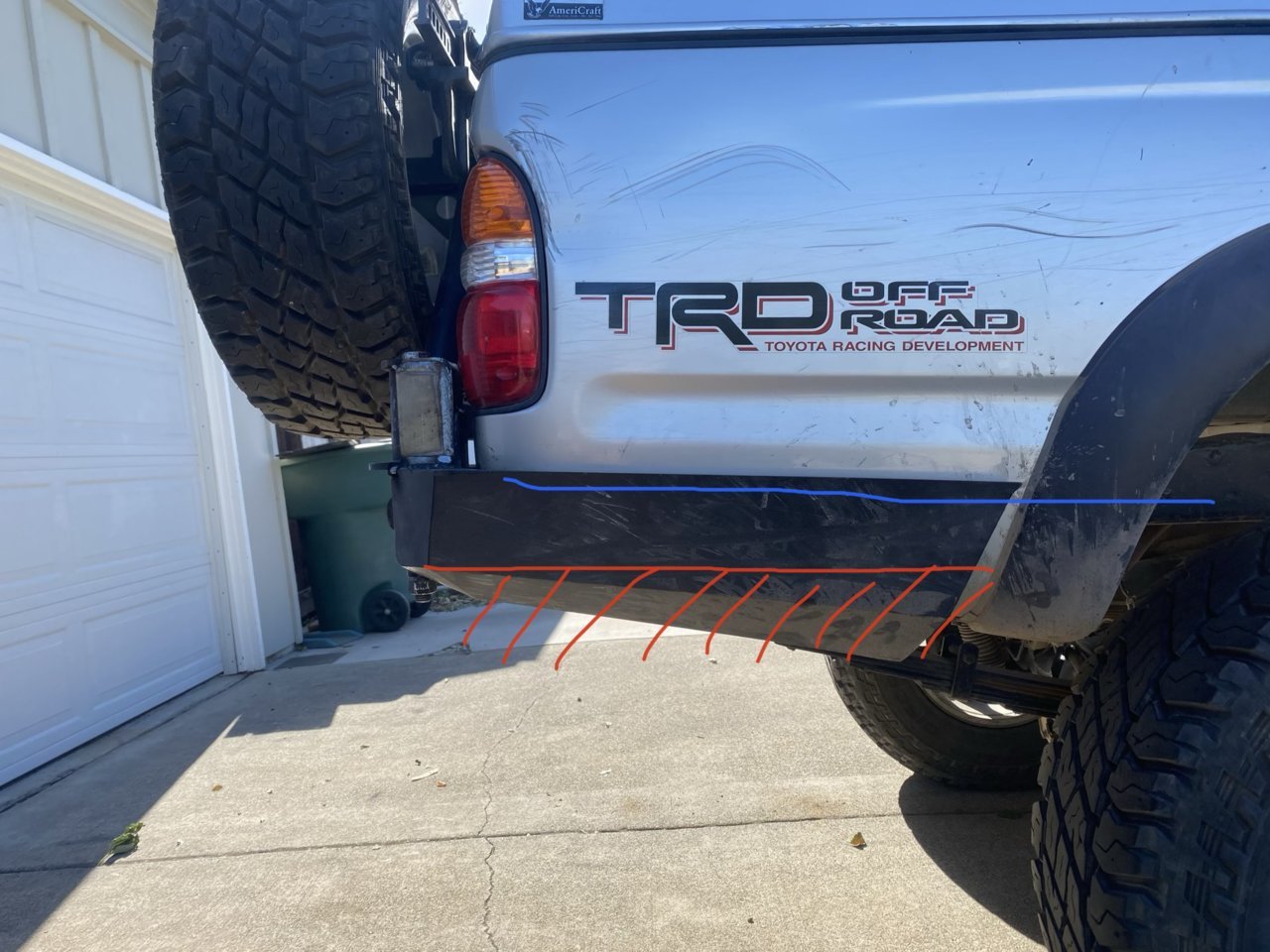

    Was thinking I might cut the bottom of the the bumper sides off. Cut my bed at the blue line and welding a straight support across. ED00B3A0-244B-4195-A183-D0E202B6F42A.jpg
