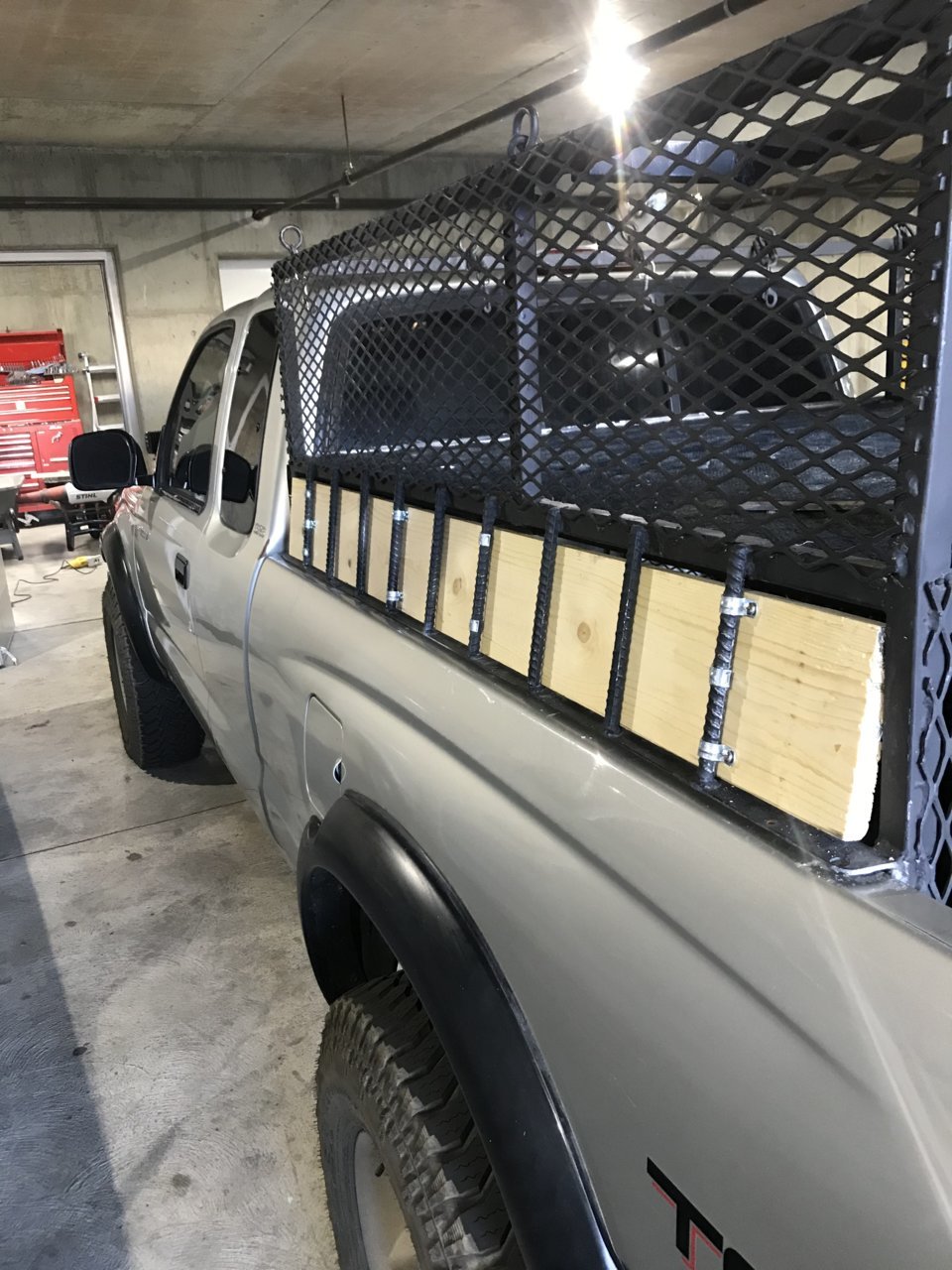

    Yesterday but, winterized the dog box, might drill some 2” holes in the boards, have to decided.
    still need to find something to make new doors out of, replace the front panel, and get some clamps to hold it down.
