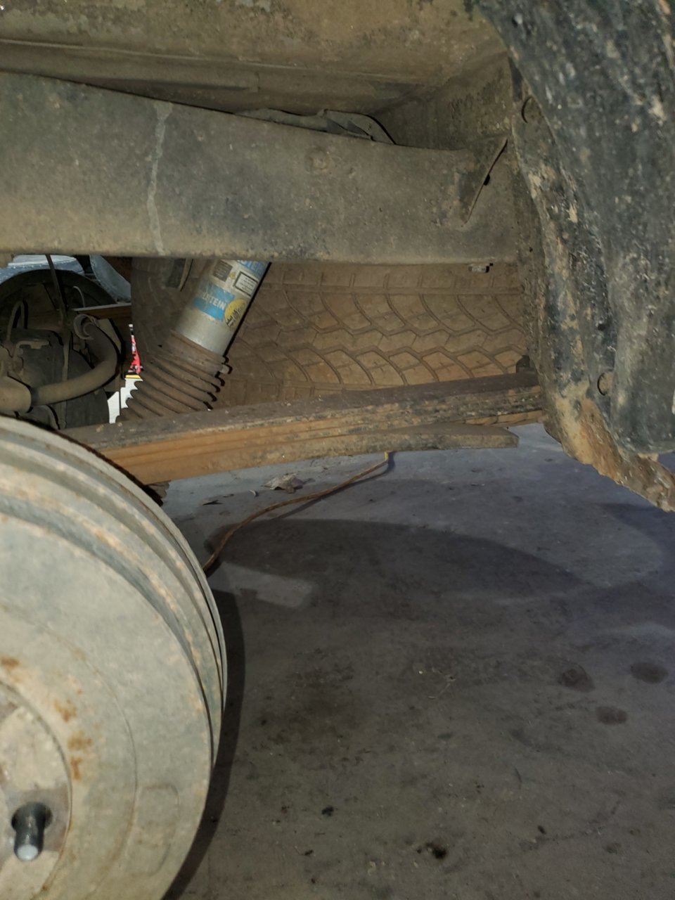

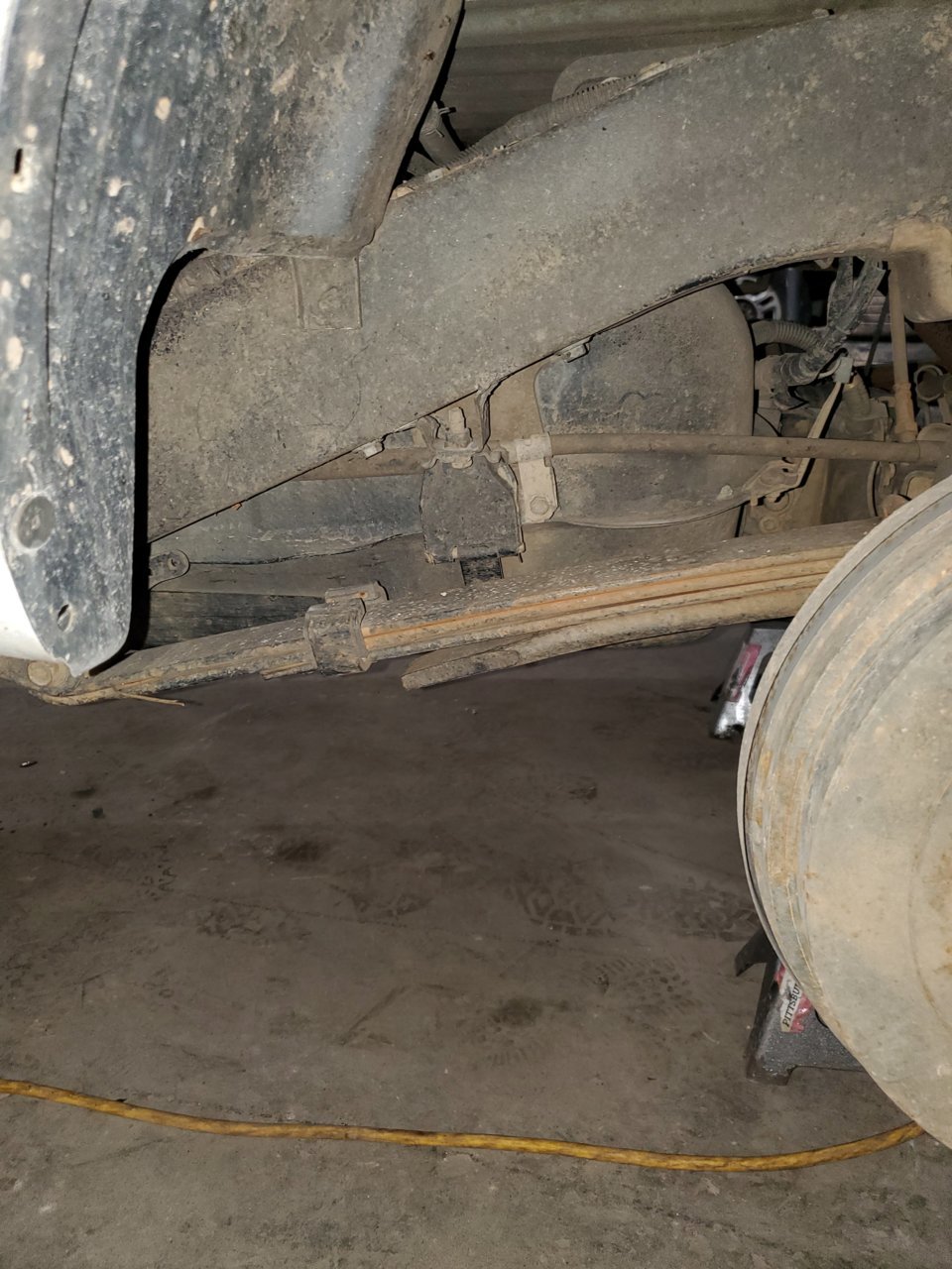

    So far just 2 sets of tires. Just put some cheapo all-terrains on it today. I was running Cooper STT Pros. Went with Travelstar At's this time. On the way home in my new truck(because it was quiet and rode awesome once again) I started hearing a wah wah roaring sound. Like watching one of those wood turning vids and they're working on a log and turning it slow on a lathe..lol its either my rear end or an axle.
    I am also about to order some leaf springs because mine are not a happy face anymore. More of a frown. WHAT IS A GOOD BRAND of leaf springs? I have 5100's on front and back. 0-3" adjustable front coilovers. I'm tired of my truck looking like its squatted.Thanks!20201105_171040.jpg 20201105_171036.jpg

    depends on what you're going for. there are two varieties of Old Man Emu Dakar springs for the first gens, ones with an without an AAL. without an AAL they ride like butter but just don't have the load carrying capacity that the ones with the AAL do. that said, the ones with the AAL don't have the load capacity of the All-pro expo springs or custom springs from Deaver or Alcan. I am running the Dakars with the AAL and have been very happy between their load capacity and ride quality, but overall your choice depends on your needs.
    I think that @eon_blue has run all of these options pretty much (Dakars without AAL, Dakars with AAL, All-pro Expos, and Alcans) so he'd probably have more insight than I do.

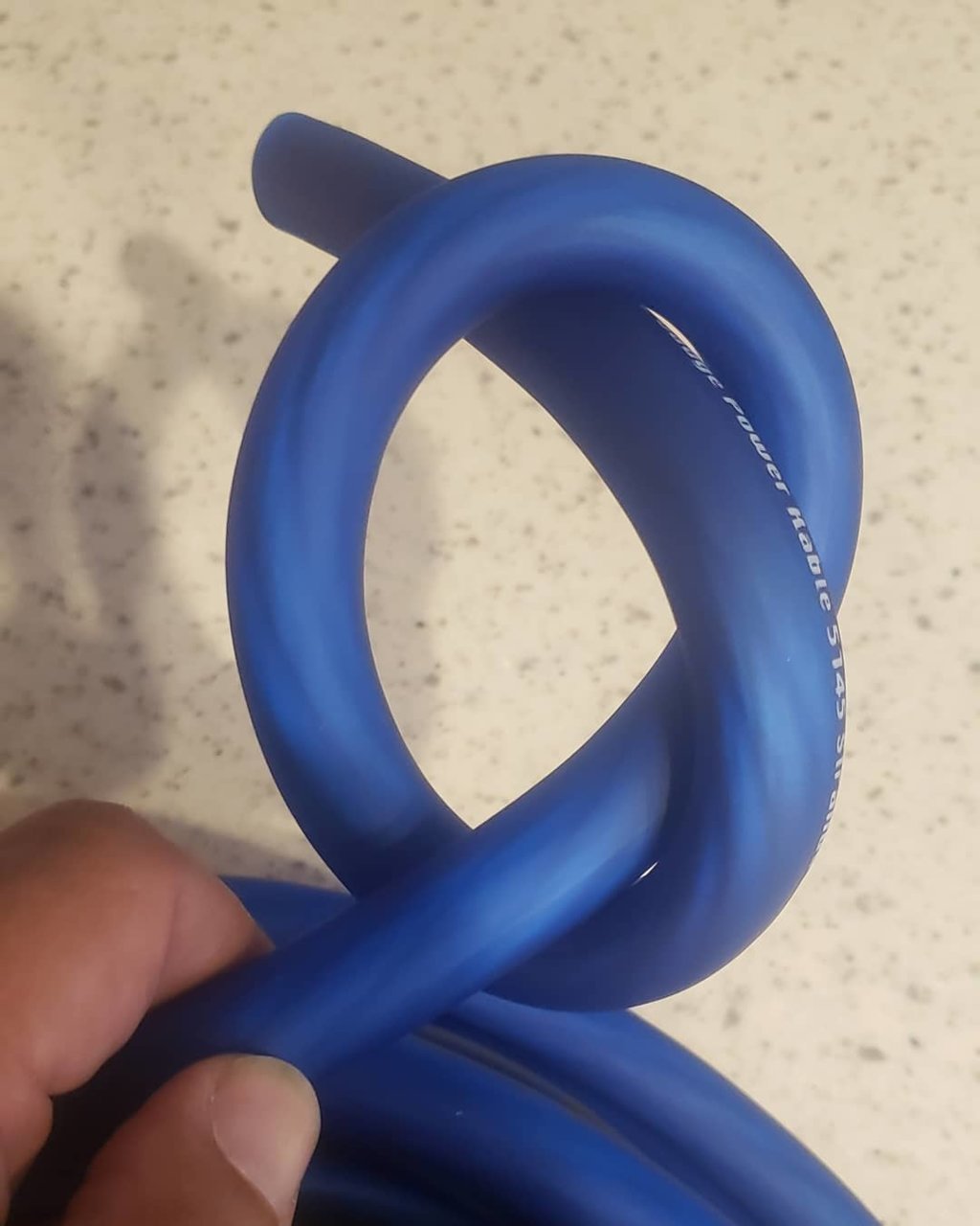

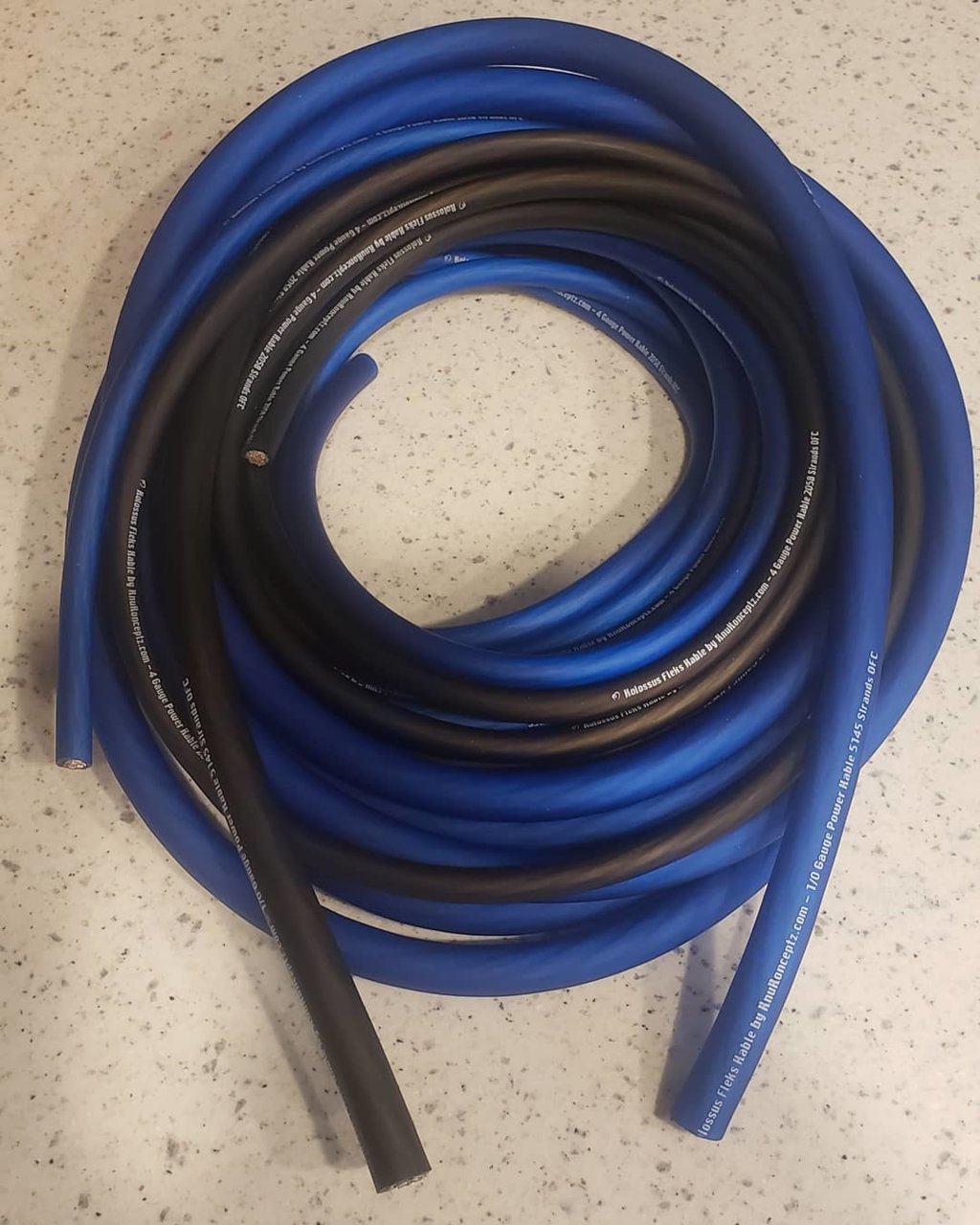

    More stuff arrived for "the winter list." Will be making changes to the mobile audio. :thumbsup:
    This is some of the nicest damn power wire I've ever seen. The know is 1 Gauge wire.

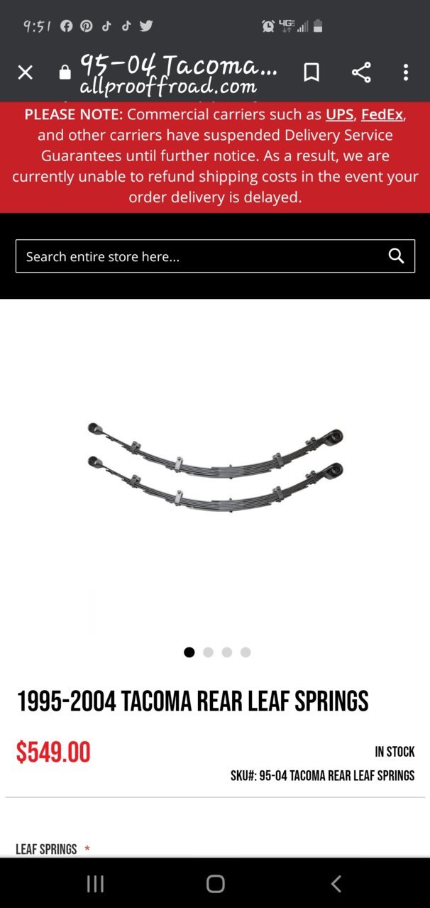

    I am assuming they come as a pair? Didn't specify on the website. They did say they came with bushings..

    You want the AllPro Exeditions. They are rated for a heavier load.
    That's the ones I run... I think the standards would be pretty much useless.

    I'm not sure if they come with bushings. The Expos will be better for carrying a heavy load but if you ride around with them unloaded you'll get a good 4" lift out of them. I don't mind rake personally, I think it looks good on a pickup. My Alcans sit the rear a couple inches higher than the front when unloaded.

    Oh lawd...they're $592 with shipping...lol
