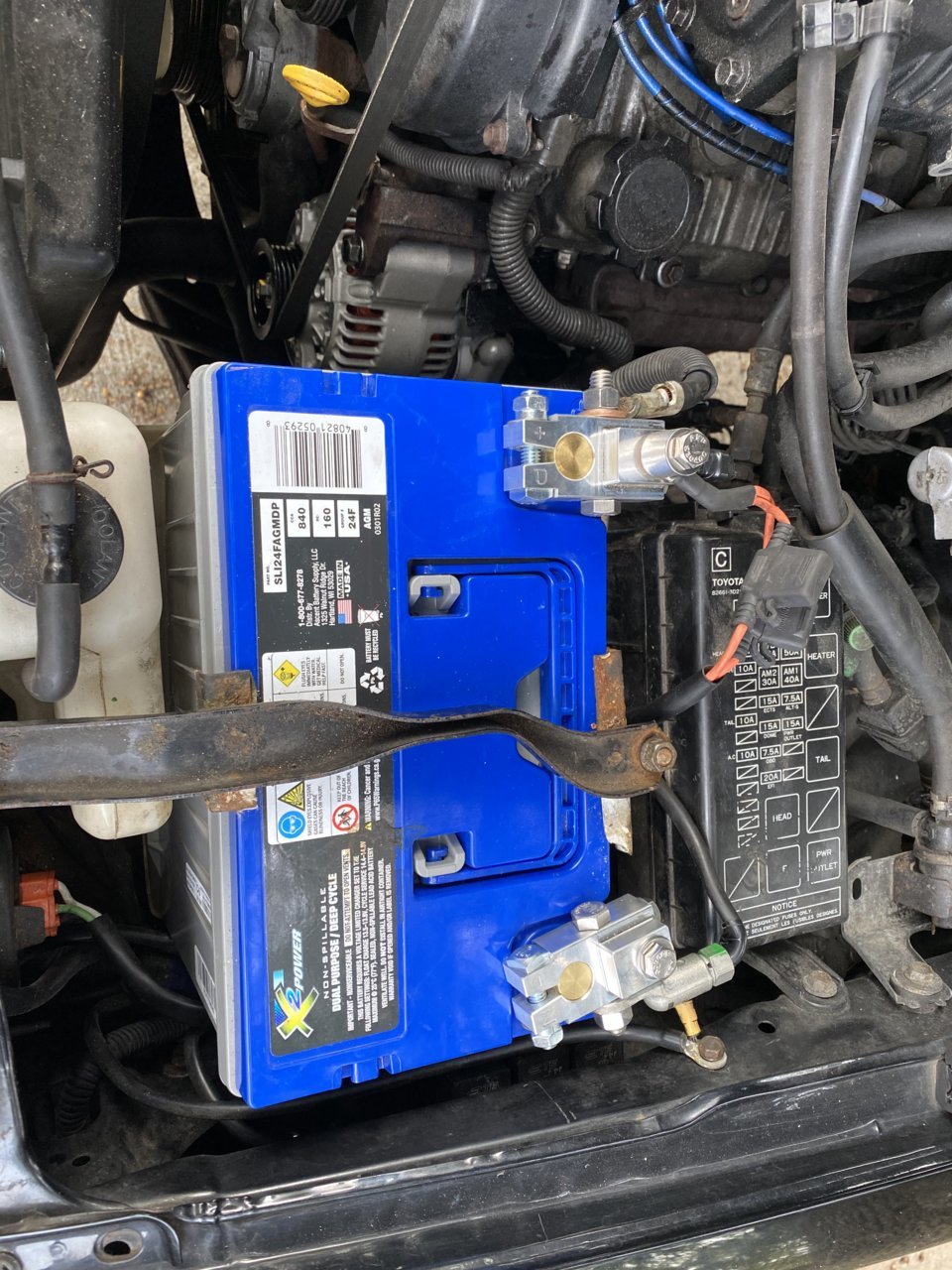

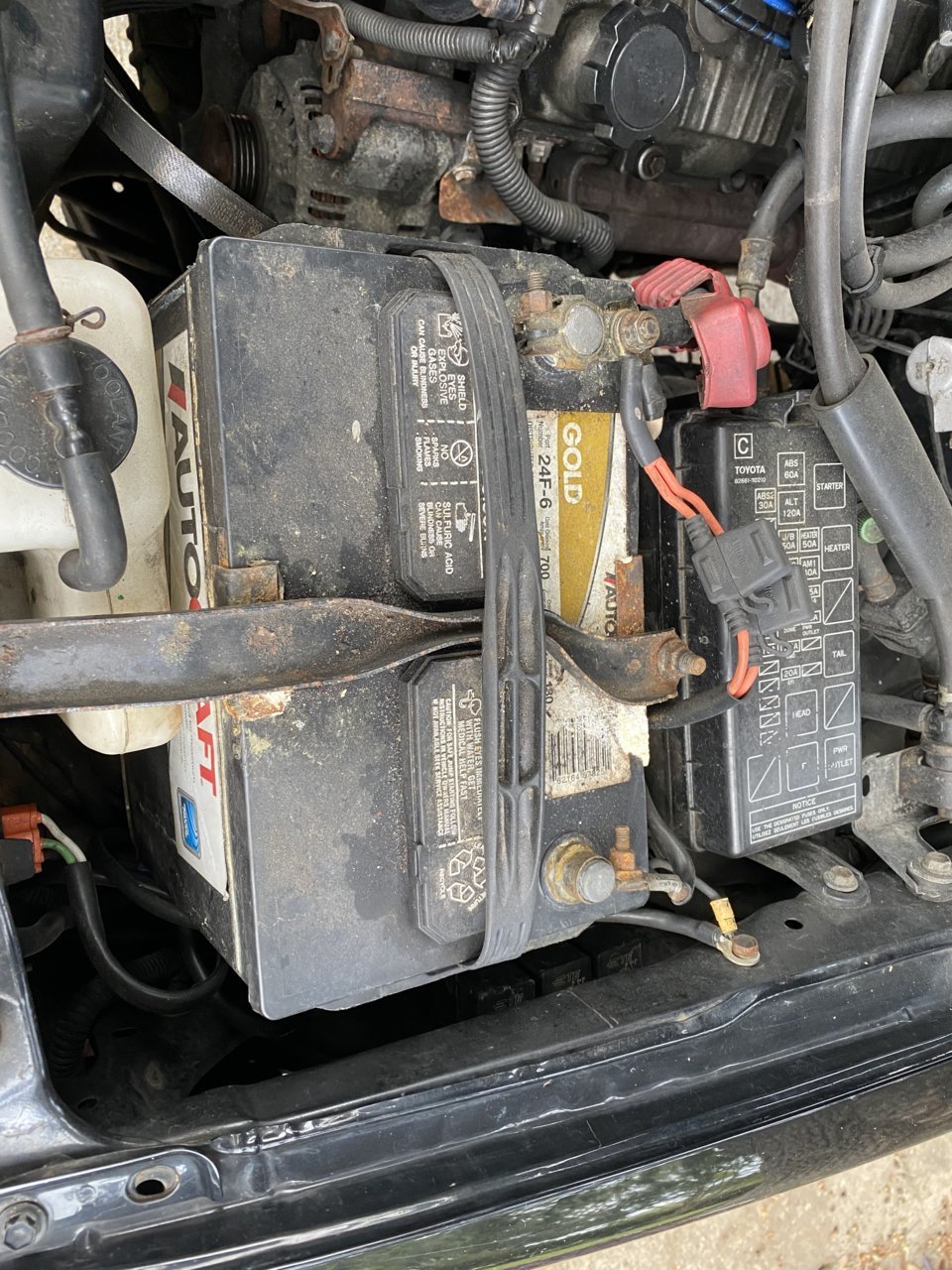

    Well today started great. Replaced the battery, terminals and alternator (sending the original out for a rebuild).

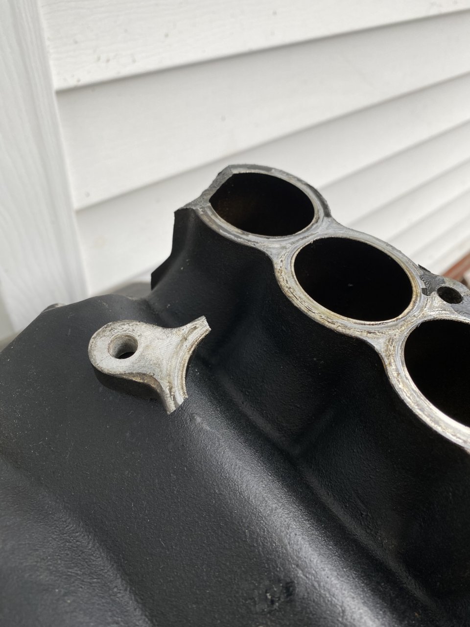

    Then as I pull the SC off to rebuild it and paint it this happens... maybe that diesel swap is going to happen sooner than I thought. I pulled the sc off and this was left behind on the intake. Not sure how to move forward with this.
    Advice?

    A shop that welds heads might be able to fix that up. They'll have to weld it back on and then machine it flat.
    @Speedytech7 Seen anything like this?
    JoeyWales[QUOTED] and Mischief like this.

    oh nooo thats like the worst thing ever... it could be repaired im sure...
    they can repair cylinder heads.. this shouldnt be very hard for a machine shop that knows how..

    I have the weld experience just not the machine, go figure.
    Seriously though, I lifted it off the intake and audibly gasped. There was a fair amount of corrosion built up around that stud. Seemed strange to me.
    ALSO one of the bolts in the intake was stripped out....

    Yeah we fixed similar on cummins all the time. Grind it out, weld it up, machine it flat, send it

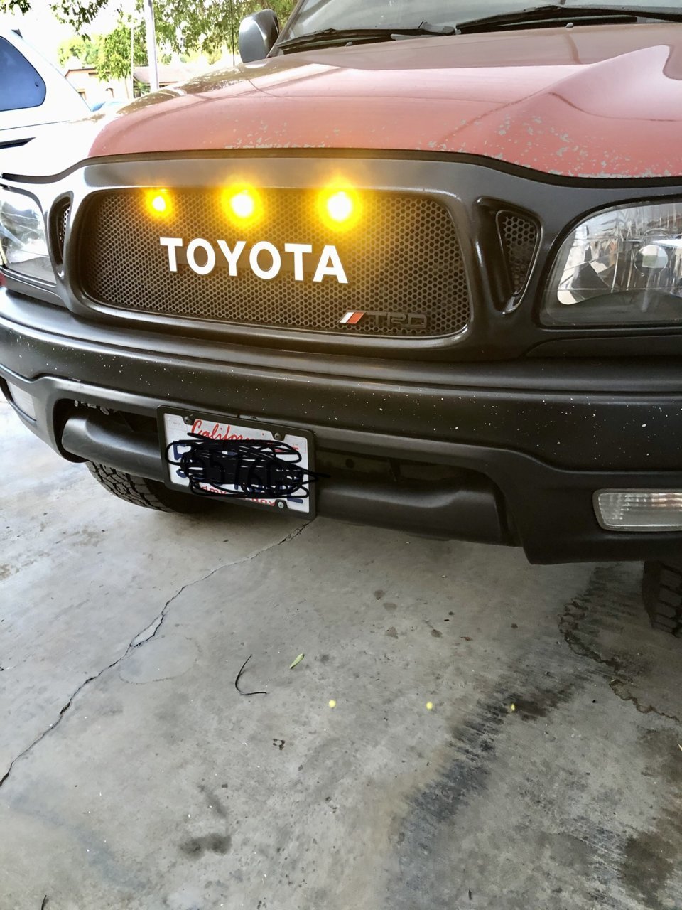

    3D printing new grill badge!!

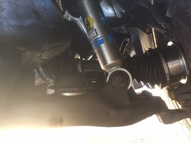

    new cv axles and a couple cans of brake/parts cleaner
