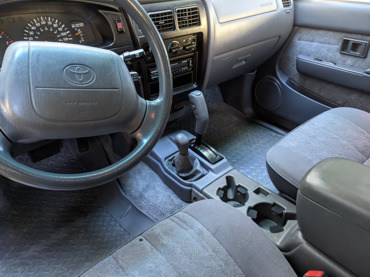

    Finally got the 2001+ center console/cup holder from @Seagull233 installed. The color match is not as close as I was hoping but function > form. PXL_20201109_174335506.jpg PXL_20201109_174341253.jpg PXL_20201109_174347432.jpg

    What did you do for the rear bracket under the console? I went to install mine this weekend and had some issues...

    There really is quite a bit of difference in color between the pre2001 and '01 to '04 gray, isn't there?

    I didn't take any pictures but the console came with the large metal bracket attached to the underside and if you screw in the bolts through the lower storage tray, they go right through the bracket and into the smaller, forward pair of holes. Feels very solid.
    Sure is.. For a minute last night, I was convinced I had actually bought a tan console haha. Although looking today in the sunlight, I feel the 2001+ grey matches the seats and the steering wheel so it's not totally out of place.

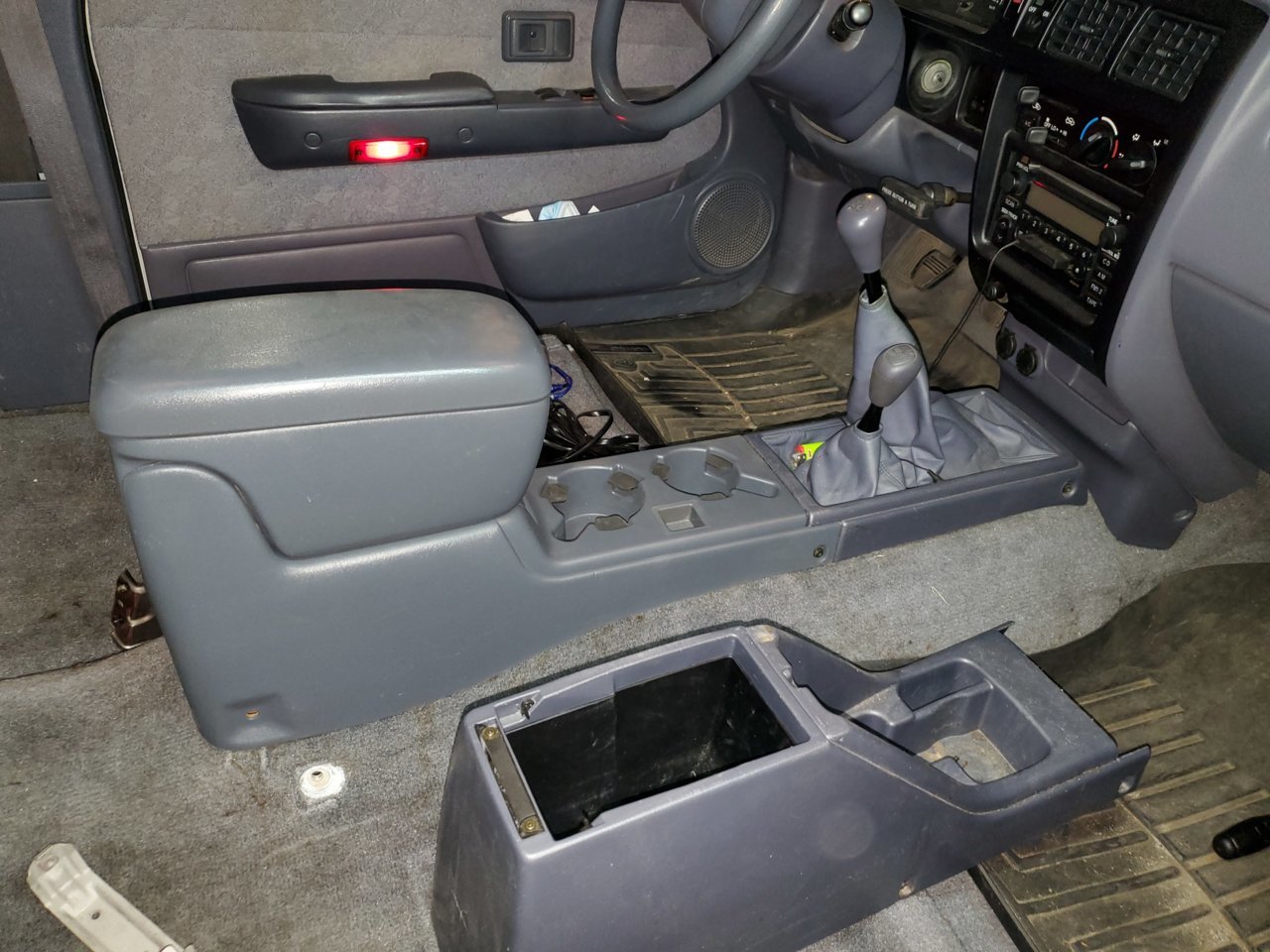

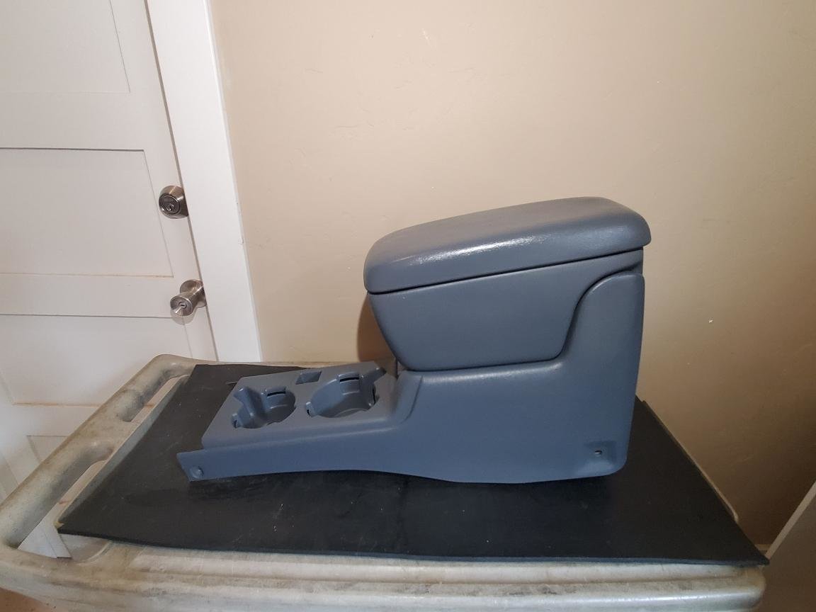

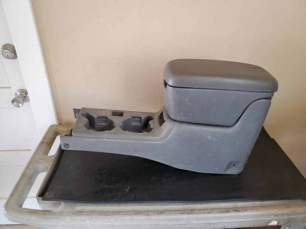

    There is. The older one is blue/gray, the newer one is more charcoal. I ended up painting mine to match better.
    Before paint...
    After paint...
    Will post up more once I figure out how I need to mount it.

    How durable is this supposed to be?

    Looks good! Link to paint you used?

    Got a name on that paint? I would like a headliner but I only ever find tan

    Likely not the most durable. The only color that I could find that actually comes close to matching is from Plastidip. I ended up scuffing all the surfaces really good with scotchbrite, wiping with denatured alcohol and painting using 8ish very thin coats. Adhesion is actually really good and doesn't scrape off easily with the fingernail test. The key to making the dip act as a paint is the thin coats. I expect that it'll last awhile, but will likely need to be touched up every few years.
    https://www.amazon.com/Plasti-Dip-Performix-11221-Fluid_Ounces/dp/B008J20R1S
    It's Plastidip (see link above).

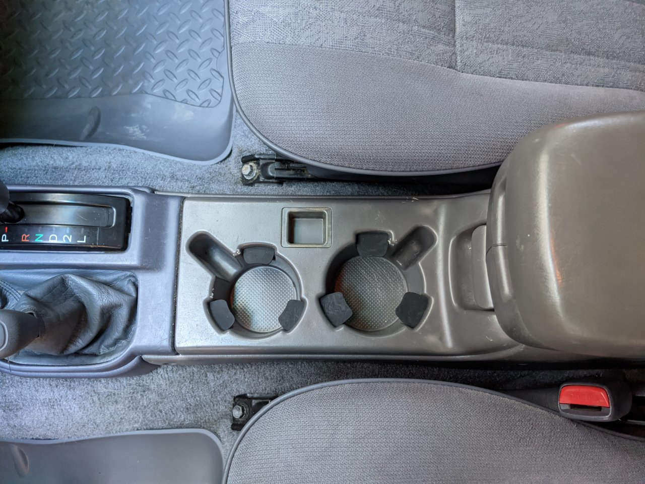

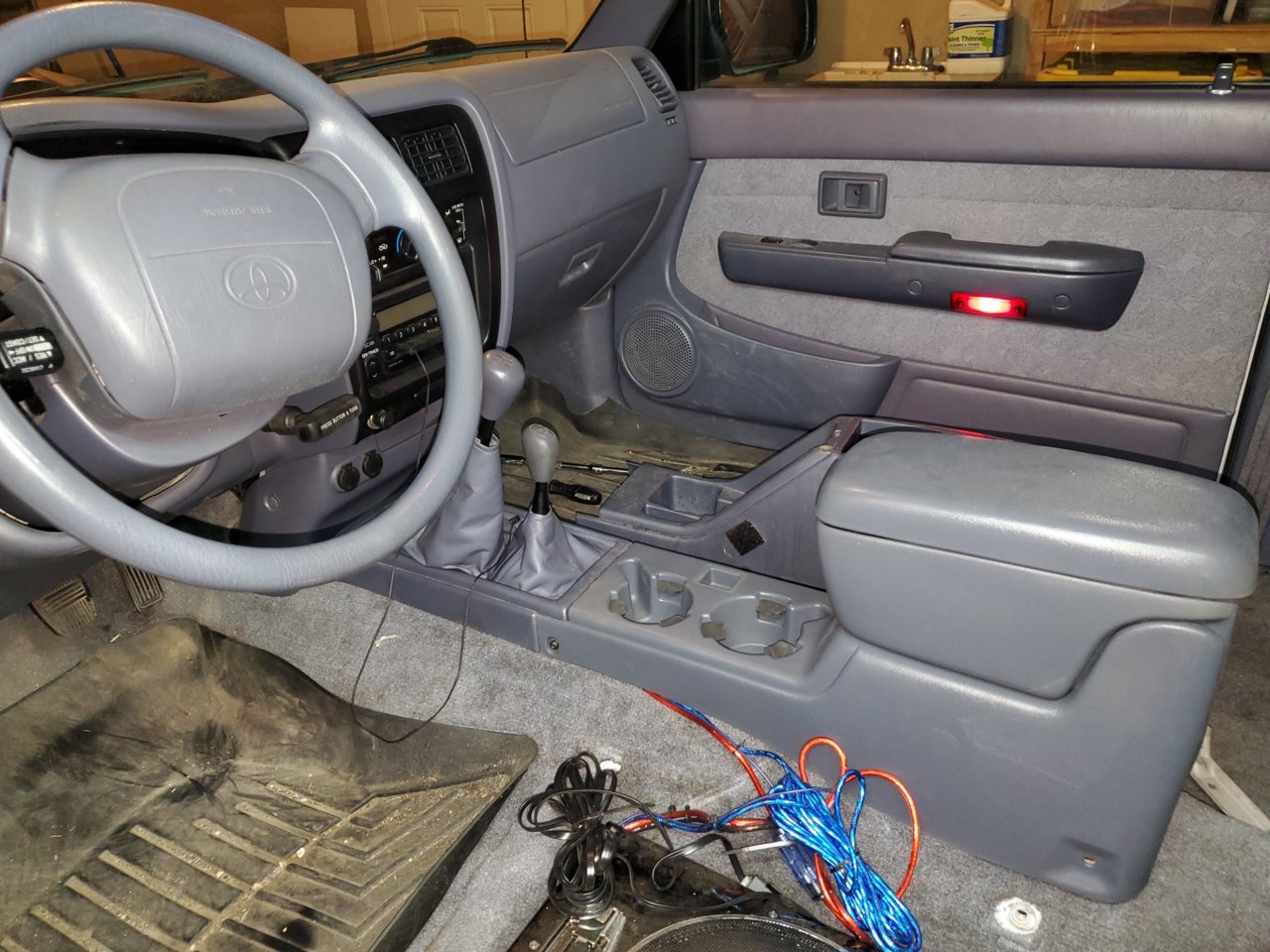

    Got it in. Color is close, but doesn't match perfectly. I'll probably pull the shift boot trim and paint it too to make it less apparent...

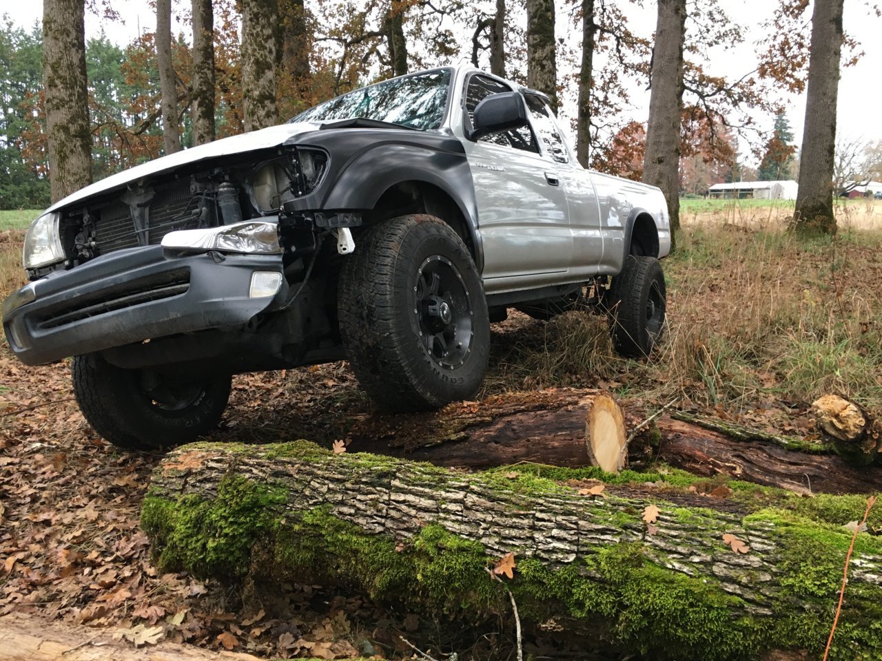

    Finally got it rebuilt and reassembled! (Mostly). Also decided to try out some flexing in the backyard.
