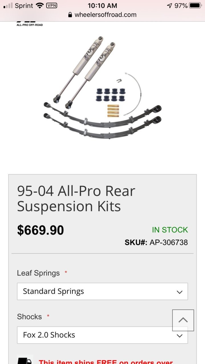

    All Pro leaf springs will give you a lift in the rear, standard ones probably about 3" unloaded.
    If you're looking for replacement leaf springs that don't provide lift, probably should look at General Springs or a company that sells OE replacement leaf packs. All Pro and Dakars are going to give you a lift in the rear

    I'd double check those shocks, those may not be for a lifted application

    I have somewhere between 2.5-3” of lift from my All Pro Standards with a 100lb rear bumper. I’ve been very happy with the ride thus far.

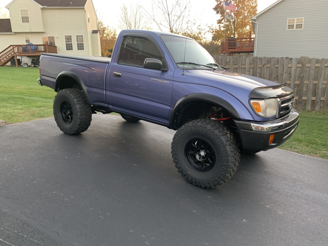

    Just got finished with JBA uca , 1” 4crawler body lift, lean spacers, removed the longer shackles, and installed all pro leaf pack.005E7934-E534-4E22-8250-AC83FB9E4EA8.jpg
