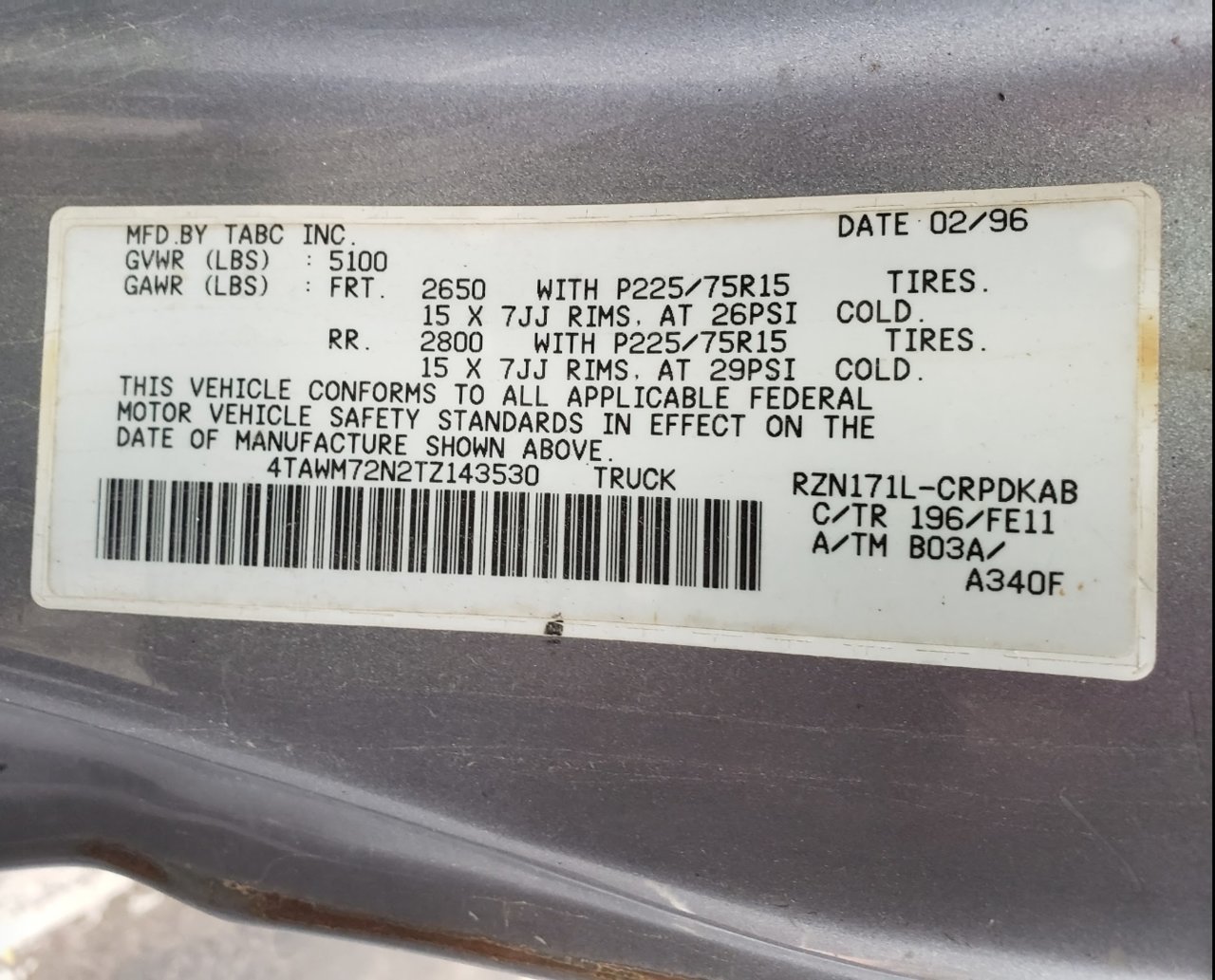

    Do you happen to know, for sure, what the gear ratio your old truck was running? I had Brennen send me a picture of his door jamb. It has a B03A gear code, which is 4.10, but it also says it's an A340F transmission.

    It's 4.10. Everything but the axles was swapped from my old 1995 truck which had 3.58, wasn't gonna keep those haha
