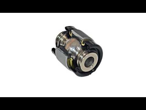

    It's less Tacoma and more mod
    So, what do you think of pressing in a set of SPC's x-axis joints?
    I don't see any reason why you couldn't retro fit these in place, and they're shrouded so less worries about heims in a vulnerable location.
    I'm not quite to that point yet, but eventually I'll trash the bushings MCM gives and need a better option.

    Do they sell them individually and in the right sizes? That would be my only question. Not totally sure how I'd retro fit them. But would try it for sure.

    Ah they have weld in adaptors..interesting..

    They have lots of different sizes and widths in their builder parts catalog. I figure there's one that's close enough. Might have to alter the arms a little bit.

    yeah looking at it now.
    Gonna have to do some measurements when I get home. Looks interesting for sure. Have weld in adaptors.

    well this is a cool idea but not enough options to do it comfortably.
    The 1.5'' weld in sleeves should work but that means you have to use the 1.25'' joint which means you're using a .39'' bolt, which is tiny.
    And they don't even make a 1.5'' joint.
    Then theirs the problem with the width. You'd need to make some custom misalingment spacers to work correctly as well to get them to fit in the mounts right.
    So at this moment, not super likely. But in future as they add more sizes maybe.

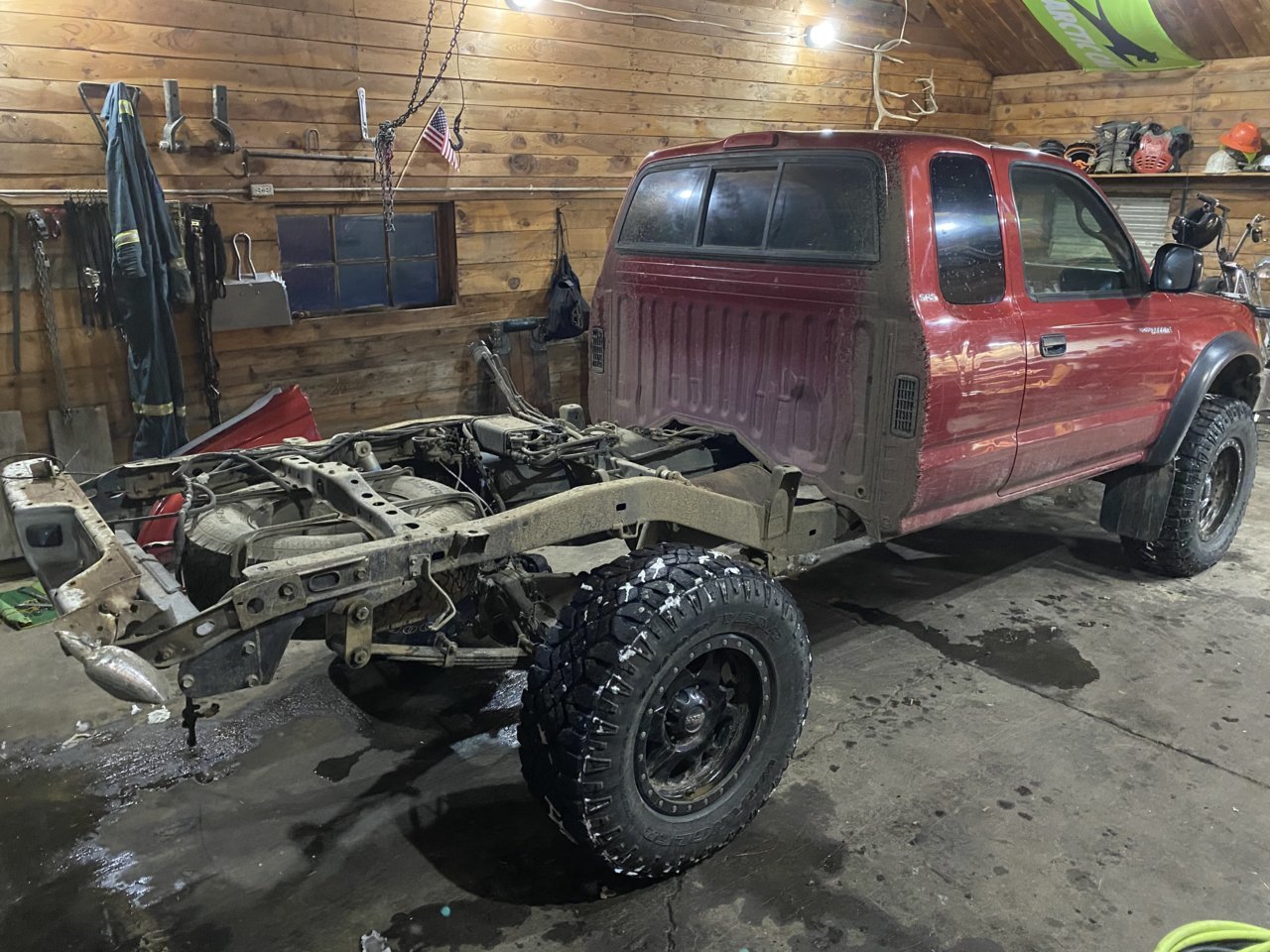

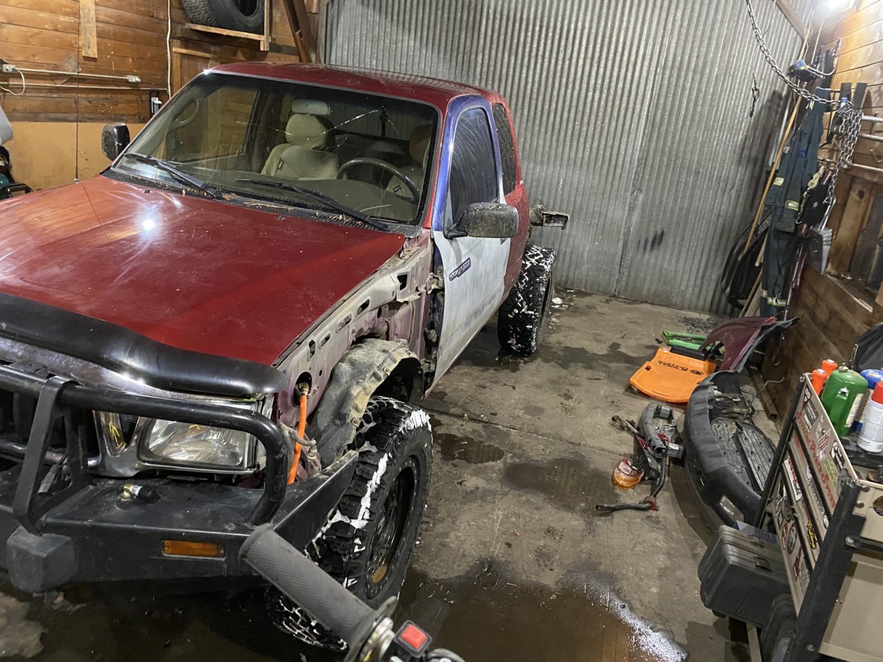

    The 1st Gen: All pro 3” lift (650 lbs coils, expedition rears with bilstiens),Timbren rear bumpstops, ubolt flip, diff drop, carrier bearing drop, 33’s on beadlocks ,ARB Bumper, winch, hand throttle, ARE canopy, roof bars, poly bushings all around minus the body mounts. The 2nd Gen: Leveling kit, roll up tonneau cover. 265/75/16’s
    Got the bed and the fender off last night!14842464-97E7-4D09-8775-7A7042CA7E72.jpg5B2397BF-2442-46AC-9C16-35D6D960C7C7.jpgPulled a couple of measurements and corner to corner from the bed mounts is off by 1.25” Nothing is obviously bent, so planning on putting the bed on, trying to get it aligned with the cab and have someone follow the pickup to see if it runs straight down the road. If it does and everything lines up, I’ll box the frame and leave it, if not, I’ll take it to a shop that can handle the frame repair. Flatbed is still in the plans, just taking it one step at a time.

    Glad to see you are saving it from the crusher.
    Yeah, it deserves better than that. I’ve got way too much time into it to give up on it. I really lost motivation right after it happened. 4 weeks away at work really helped me get excited about it again.
