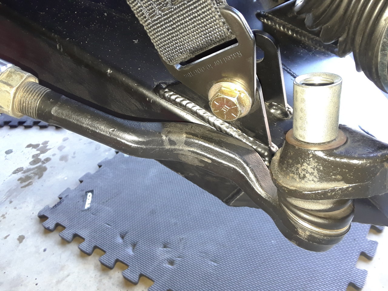

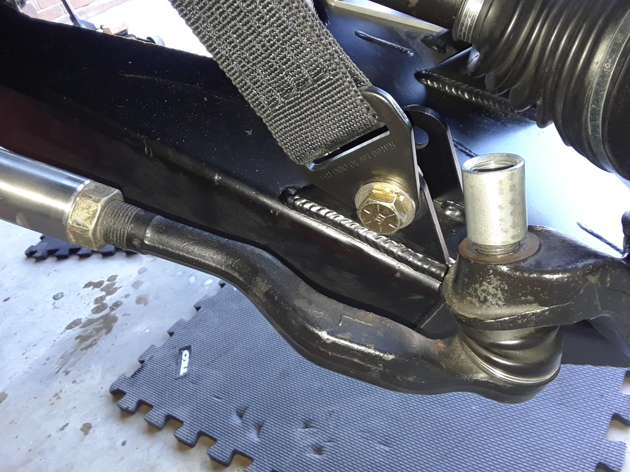

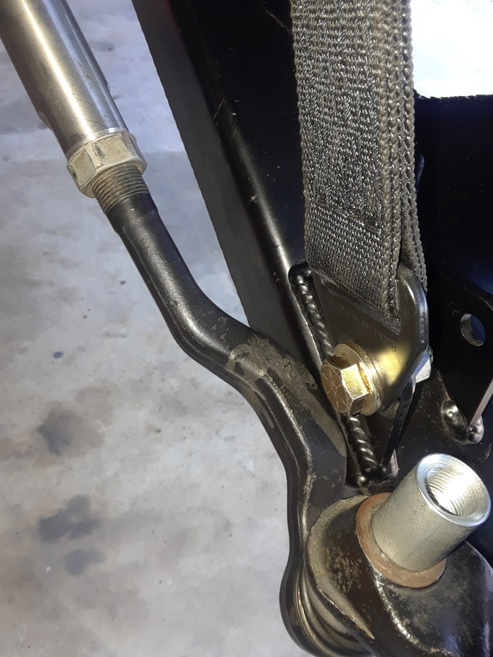

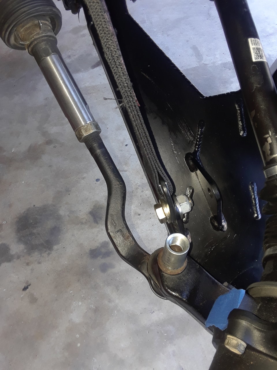

    Different angle. Dont mind that weird nut, its just temporary holding the tie rod.
    Granted these angles are extreme and the CVs aren't happy about it.
    Flipped
    Normal

    with the wrong side on you'll contact the wheel.. unless your running wheels with weird offset/a custom spindle.

    is the other side on yet? you might be turning it past the steering stops.

    other side is on. The steering stops were cut so it does not gouge the LCA. Ill check wheel fitment tomorrow with them flipped.

    The wheels won't fit. I think I tried that as well. That said my lcas show no signs of rubbing from the tie rods

    I accidentally installed mine reverse of what they should be. They only contacted the tire weight and not the wheel itself. I think those wheels were 4" BS

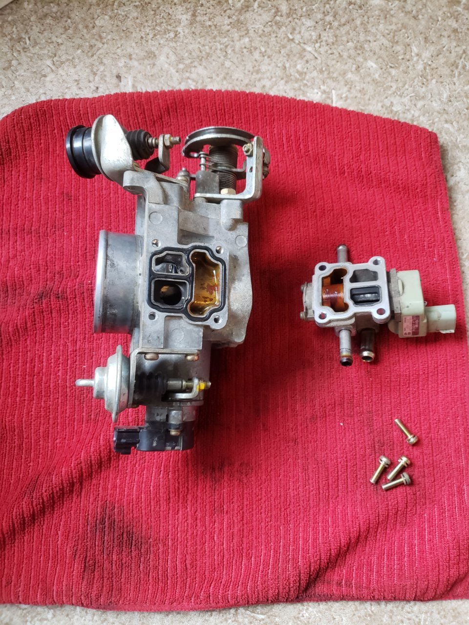

    Today I replaced a stupid failed PCB hose that was causing a whine.. a whine that I mistakenly thought was coming from the throttle bottle. So now I have the new hose and a cleaned out throttle body + new IAC valve gasket I replaced in the first try of fixing the whine. Oh and I flushed the brakes fully today, it was a good day.

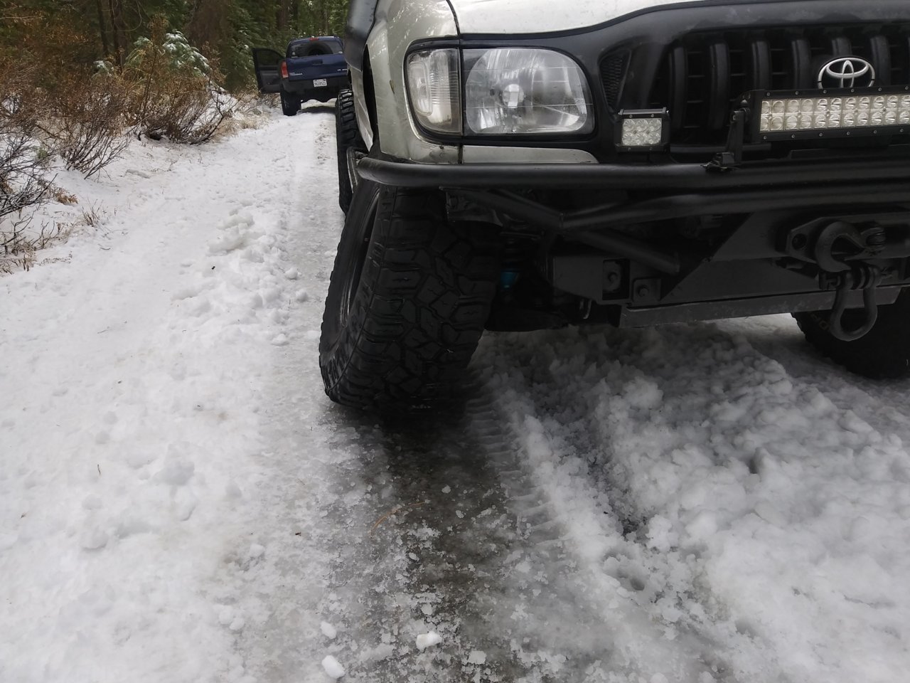

    His spindle split

    Spindle split in half. Whack

    WTF!? How did you manage that? And how'd you get off the trail?
