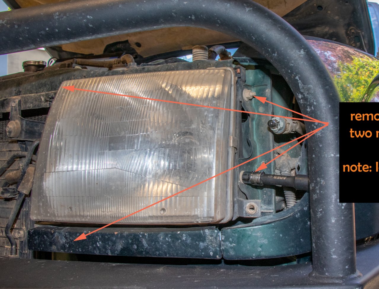

    Interesting. Does the CAPA certification not really mean anything?
    What do you mean - mine still seem (relatively) clear, if a bit dirty in this photo from Sept. ...and if it's the optics behind the plastic that are the key bit, ... I don't follow.
    Also, I noticed on RockAuto, this other "style" of headlight, which has some sort of aparatus "in front" of the bulb. It's 2x the cost of the TYC's, but might it be better, light and beam pattern wise?
    https://www.rockauto.com/en/moreinfo.php?pk=705430&cc=1364723&jsn=892

    Dude you're lenes are shit. You can barely see the bulbs haha
    here is my truck with one new lens and one original.
    [​IMG]Memorial Day 2018-33.jpg by Monte Nickles Photos, on Flickr
    That is an additonal cap for the H4 bulb. Remember the light from the bulb is actually coming from the long part not the tip. It don't mean it's better though.
    The plan to buy some cheaper lights, then swap the lens is the best idea honestly.

    LOL, I guess I'm just used to seeing all the pictures of everyone's "yellowed as shit" lenses from UV, so mine didn't seem so bad. But yeah, I guess they are like your "not new" one.
    How hard is it to swap the lens? Is there a writeup somewhere?
    I wonder if it would just be better to pay the $350 for two new assemblies. I mean, it's been 20 years on the originals, and I spend $250 on LBJs every year anyway.

    No write up but you'd basically follow a retro fit write up so look at a few of those. Basically you just heat up the head lights in the oven to soften the glue, then pry them off. Get some new glue for when you put it back together.
    Not a hard task, take some time due to baking is all.

    Capa is better. But still not up to Toyota specs. But anything is better than yellow headlights
