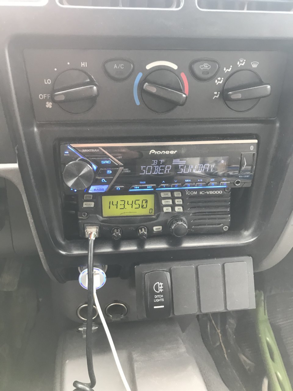

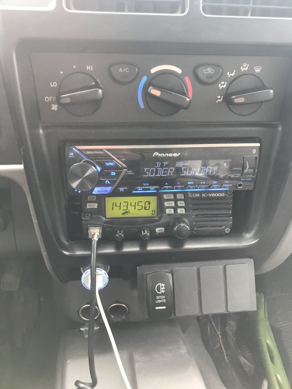

    Since y’all’s are still on headlights n shit
    something I noticed this morning with the fancy shroud LEDS , doesn’t seem to affect anything, but funny it picks up the headlights and not 8 bulbs in my ditch lights.

    You talking about the radio? Thats cheap filtering in the electronics of those lights. Same thing to my dust light, when on it makes my CB useless.

    Yea, they don’t seem to affect much with the Ham, the headlights or ditches. But the ditches would make a mess of my stereo in my other truck

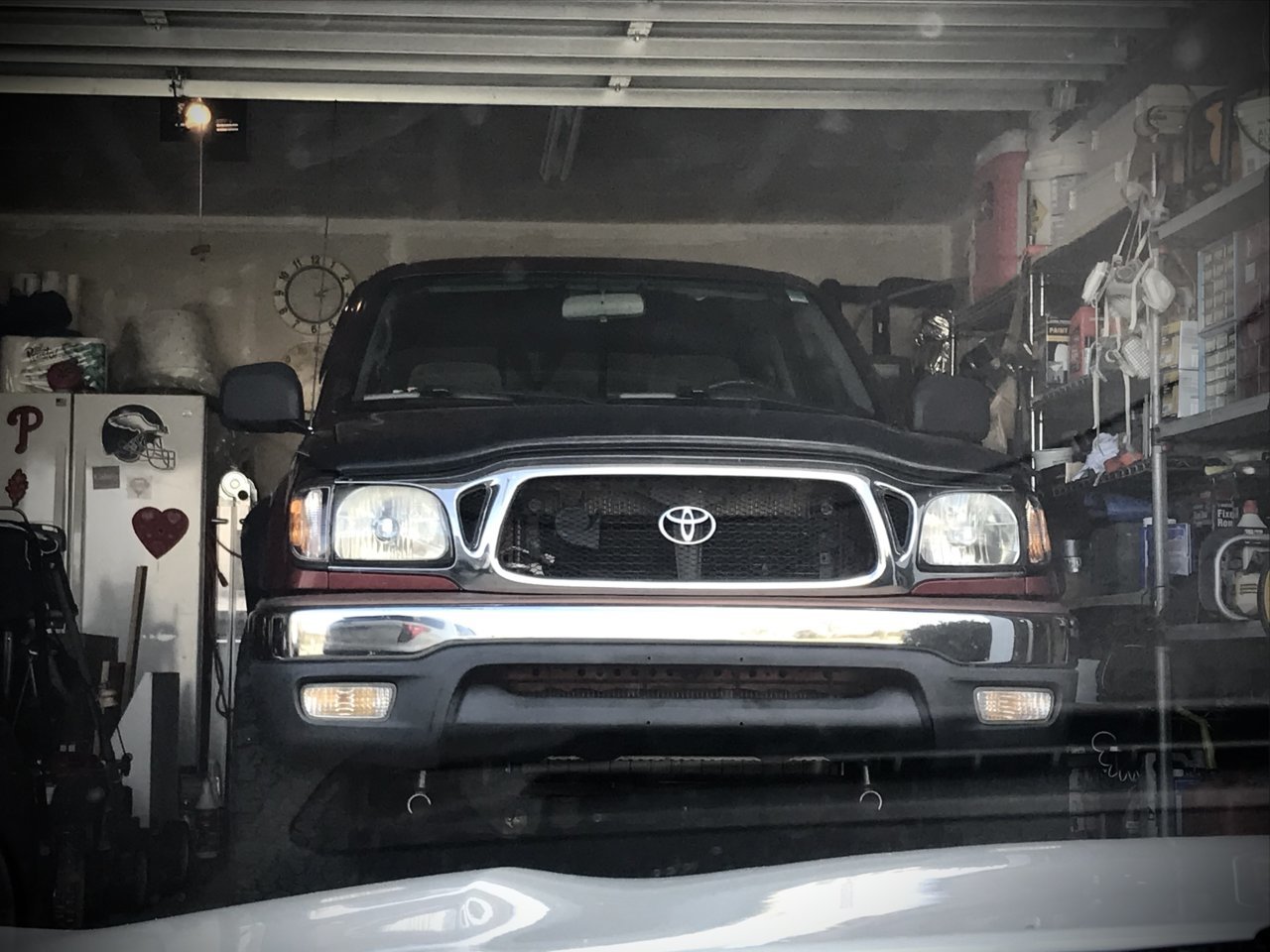

    Did a satoshi mod to the grill today. Keep the original symbol instead of the typical Toyota lettering.

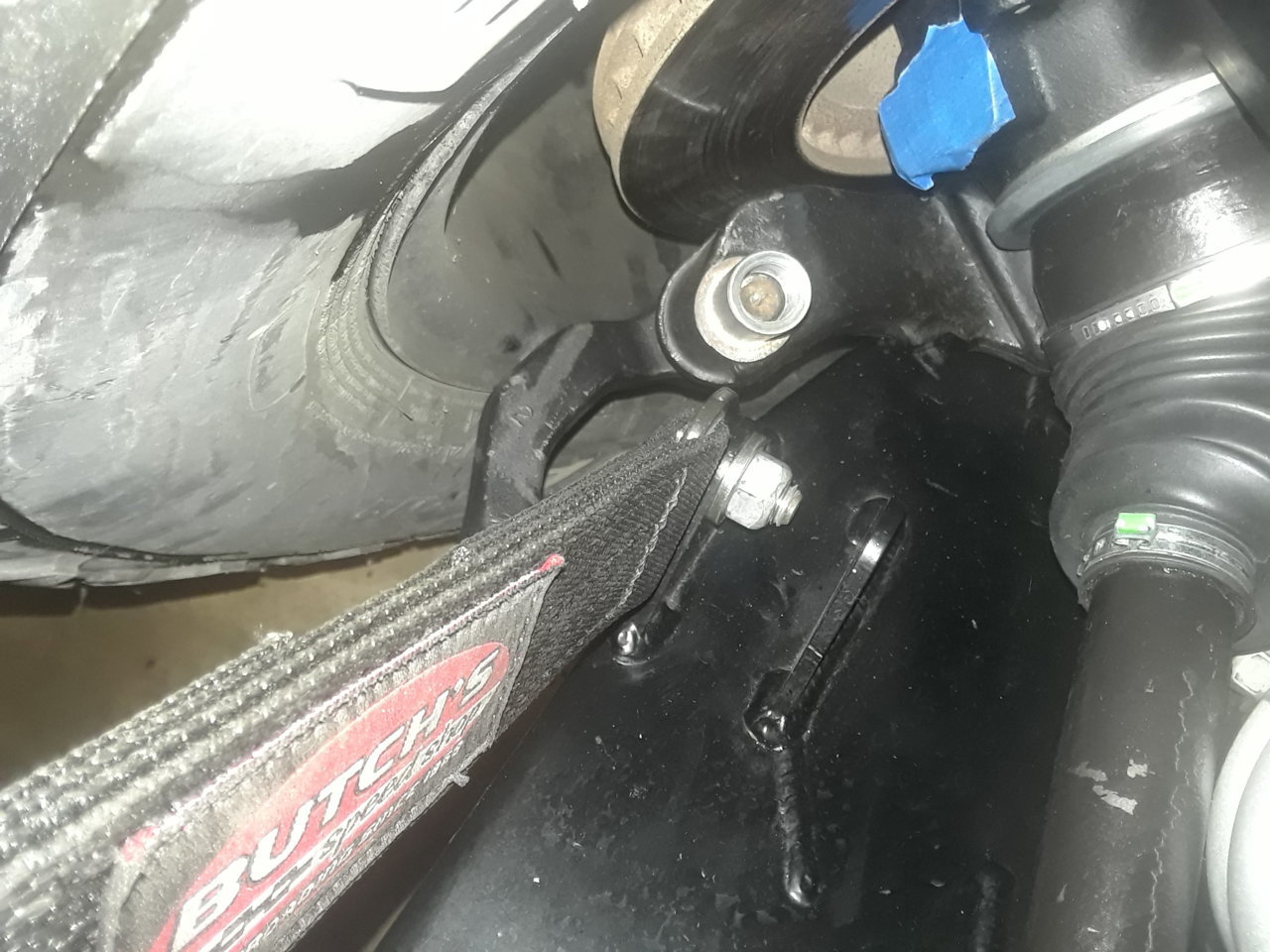

    I guess it depends on tire width and wheel back spacing. I'm currently running 16 inch steelies so this might not work if I upgrade to alloys.

    Man, that looks great. Never a big fan of the Toyota lettering.
    Excellent choice.

    I like the Toyota lettering on the 1995.5 - 2000 front ends, but I don't think it matches up well with the 01-04 front. The Toyota emblem looks better on the later model front end

    Thanks! I don’t think I have seen a 01-04 that has the satoshi mod and just Toyota symbol. They all go lettering.
