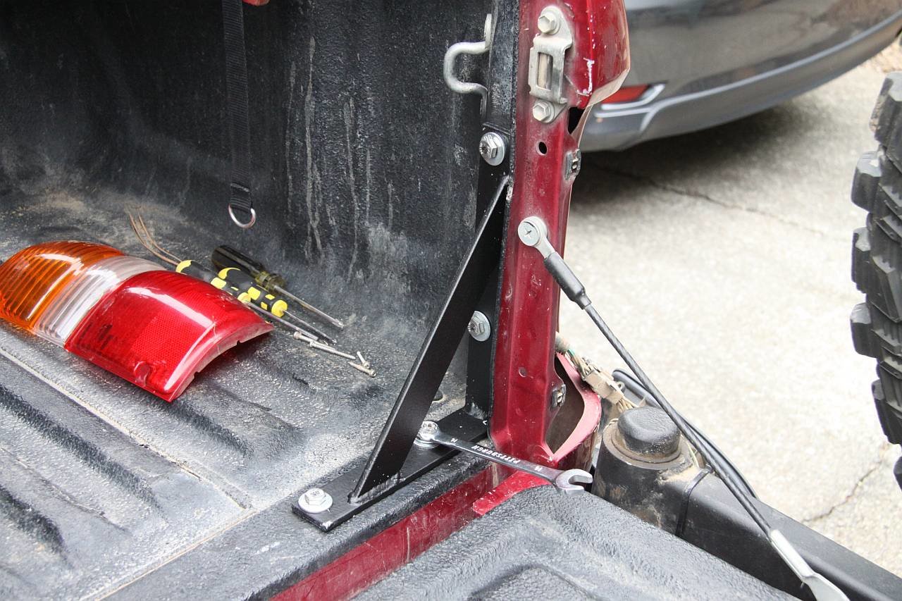

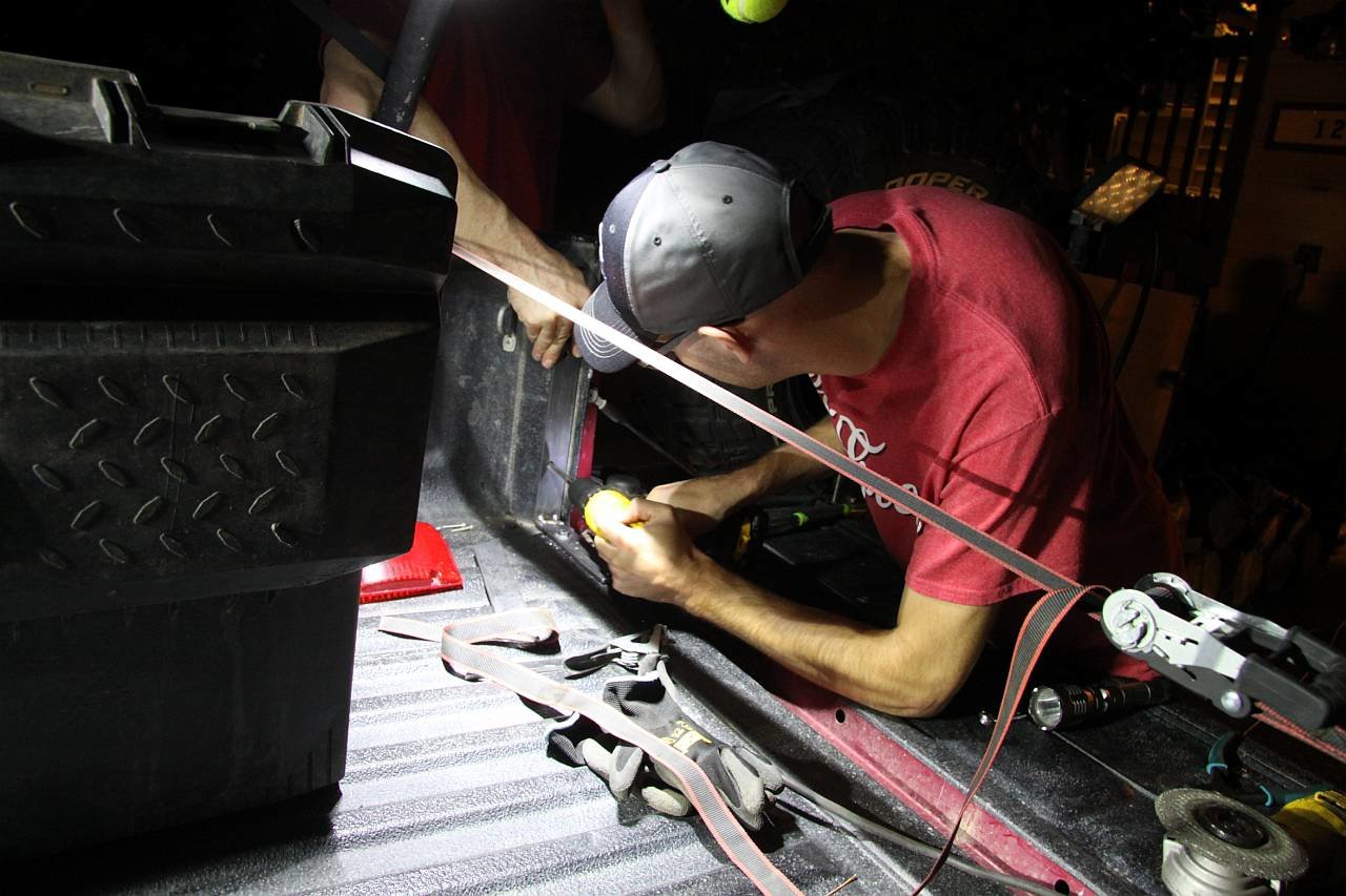

    just make your own if you can. Super easy, took me like 3 hours ish? As as was packing the truck up that same day haha

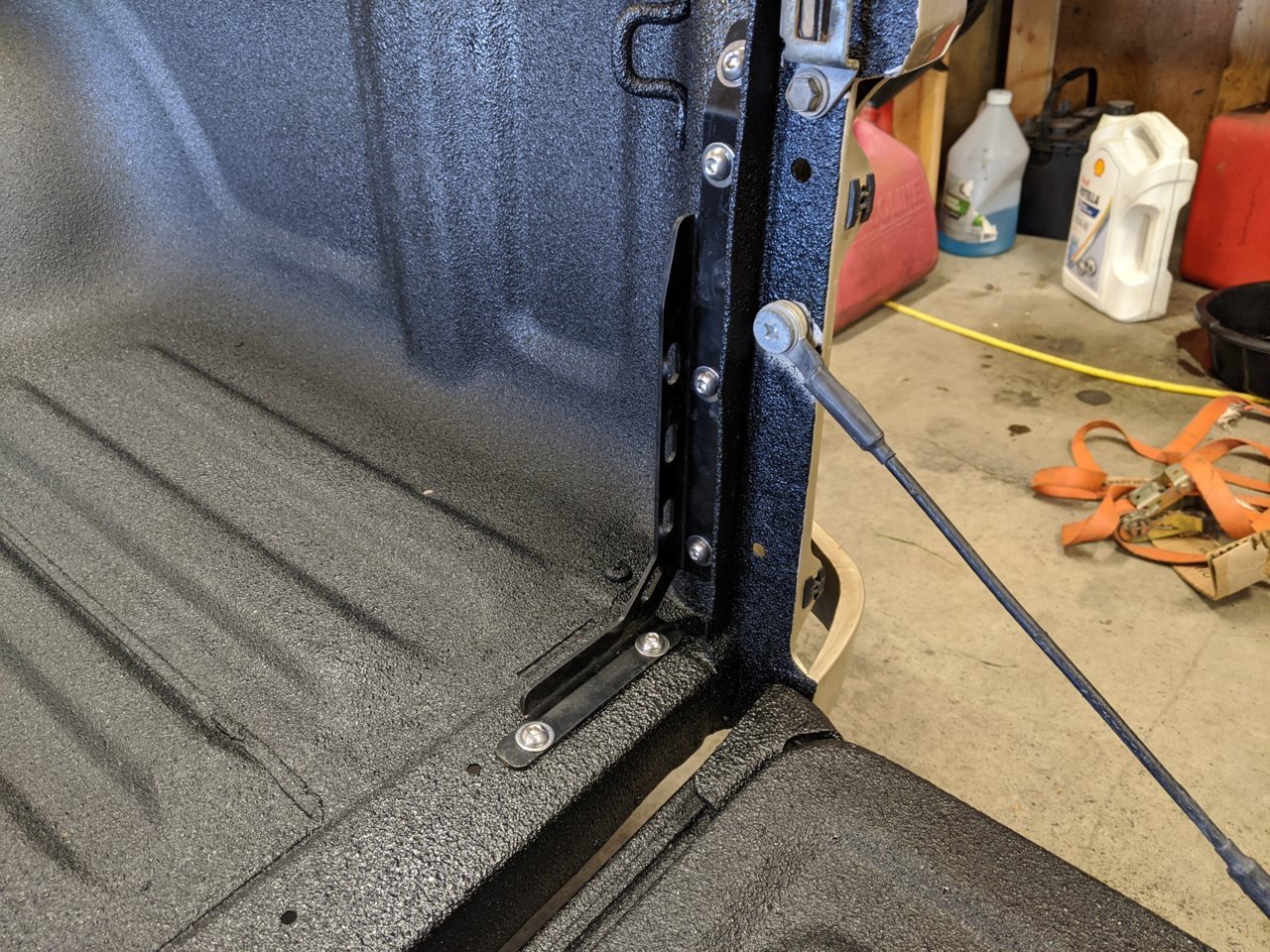

    To keep the bed from spreading. If you look at your tail gate some aren't straight gapped anymore. More common with bed rack installs.
    Mine was splitting right at the bed rails just past the tail lights. Welded it up this summer.
    No have to drill them yourself.
    Yeah mine has washers. But I wouldn't mind doing a long piece of steel under there.

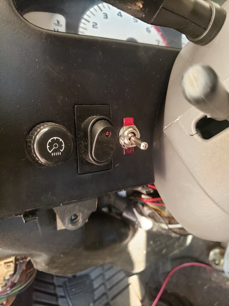

    Installed a switch to enable/disable the DRL module on my 01
    Old timey switch on the right.

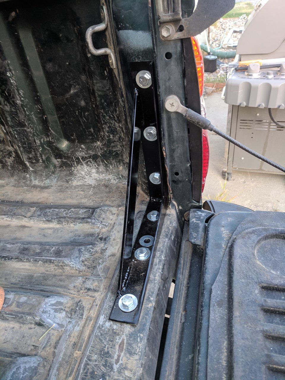

    I just added the Rago, I got them on sale and with them powder coated and the hardware it was a pretty good deal. Although I could have made it cheaper as I’m sure I have enough scrap metal laying around. I was being lazy haha84DA97E6-15DA-450A-AAFC-32F4B799435F.jpg
