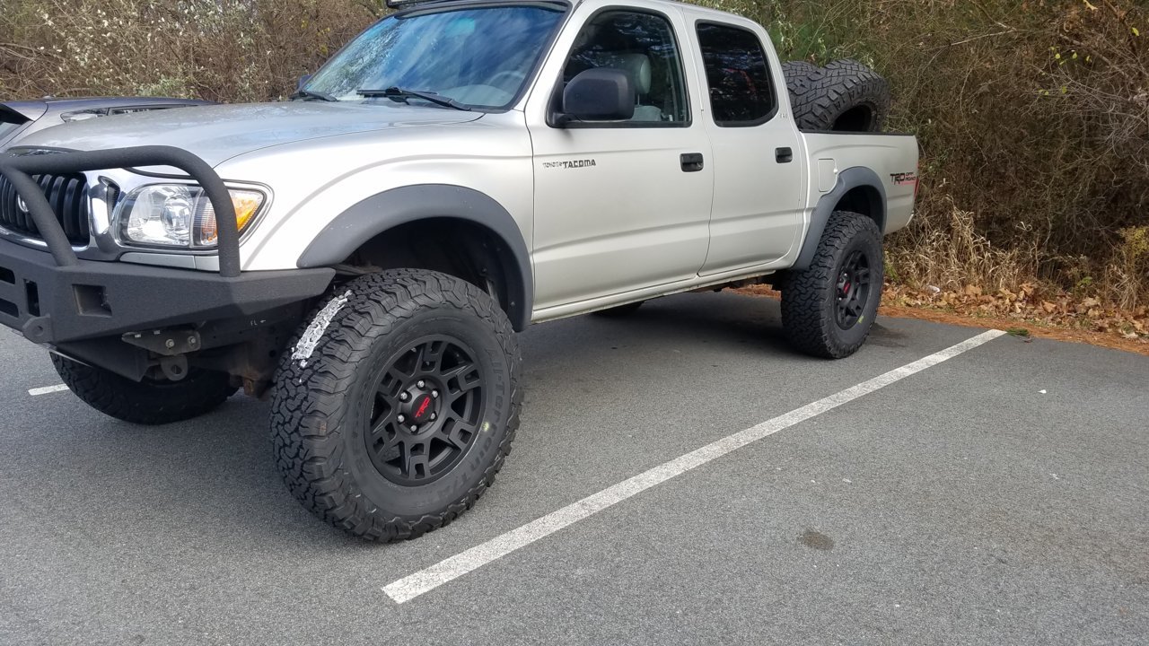

    Been quite some time since I've popped in here. Hope everyone has had a safe thanksgiving.
    Just replaced my tires from duratracs to k02s. Swapped to new TRD rims as well. Need to sell the old rims. They are a bit banged up. Curious what you guys think they are even worth before i start making for sale thread(s)? Thanks

    I'd post them for $400 and probably take $300 if it's the right person. Did you notice a difference in the backspacing between the two sets of wheels?

    Thanks. I'm thinking of going ~$350 ->$300, since there are quite a few knicks and blemishes that are not easily visible in that photo (I have other photos that I'll post in a sale thread).
    To answer your question, I didn't take backspacing measurements of both rims. But I know the offset of the FJ trail teams are 15mm. The TRD rims have an offset of 4mm. Leads me to believe the backspacing is different between both wheels. Unfortunately there are a few other differences in my setup, so its not a clean/direct comparison once installed on the truck. Duratracs were 265/75/R16. The new KO2s are 285/70R17. Overall stance is wider now. I do get minor rubbing of the tires when turning full lock. I have spidertrax 1.5 wheel spacers and ~2.75" lift. Surprisingly this only happens in reverse and not when in drive. Not entirely sure why...
