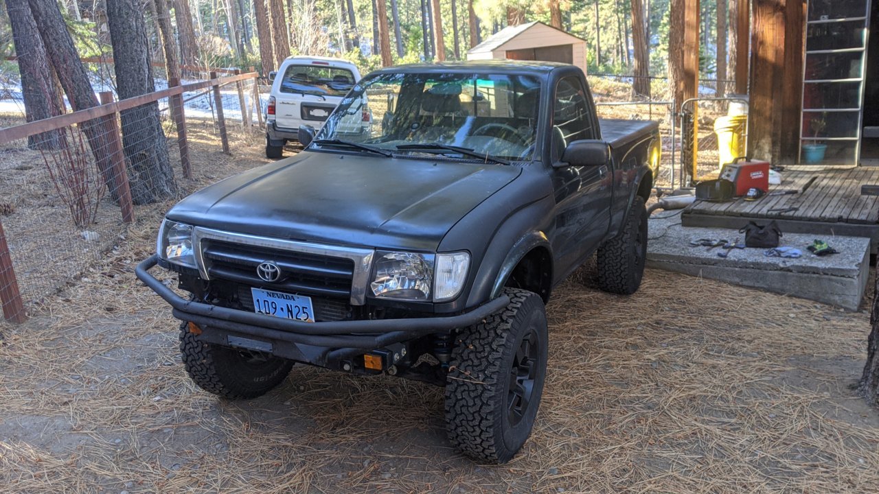

    I'm running 600lbs springs with tg low profile bumper but a regular cab 4 cylinder. I'd say you need at least 650lbs springs.

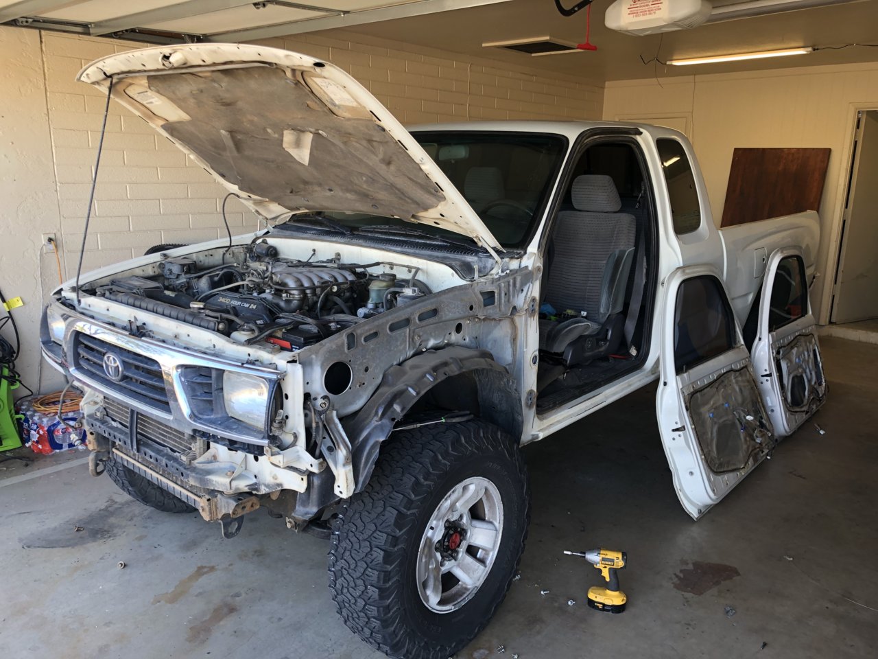

    Replacing some elk damaged fenders and door, as well as replacing a cheap aftermarket chrome bumper. Took a long time to find OEM driver side parts. White is a different shade but close enough for now. Having the dent in the cab popped as best I can tomorrow. Eventually will have it painted. Next up is a front bumper build...
