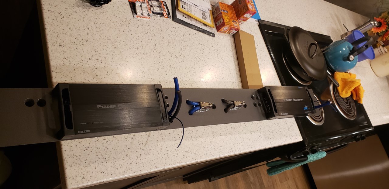

    Brought the party inside... ran some of the power ground and remote wires and mocked up the amps... my wife LOVES IT when my projects come in to the kitchen counter </sarcasm

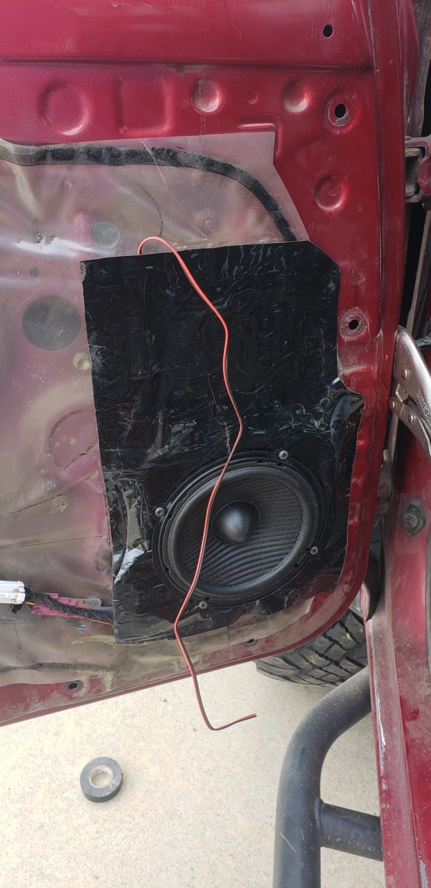

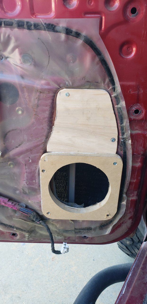

    Had to make adapters for the front speakers.
    The adapter is isolated from the sheet metal with bituthene.
    Then the speaker is sealed with bituthene.
    I ran sound deadener inside the door behind the speaker. Cross over for the componants is mounted in the bottom of the door.
