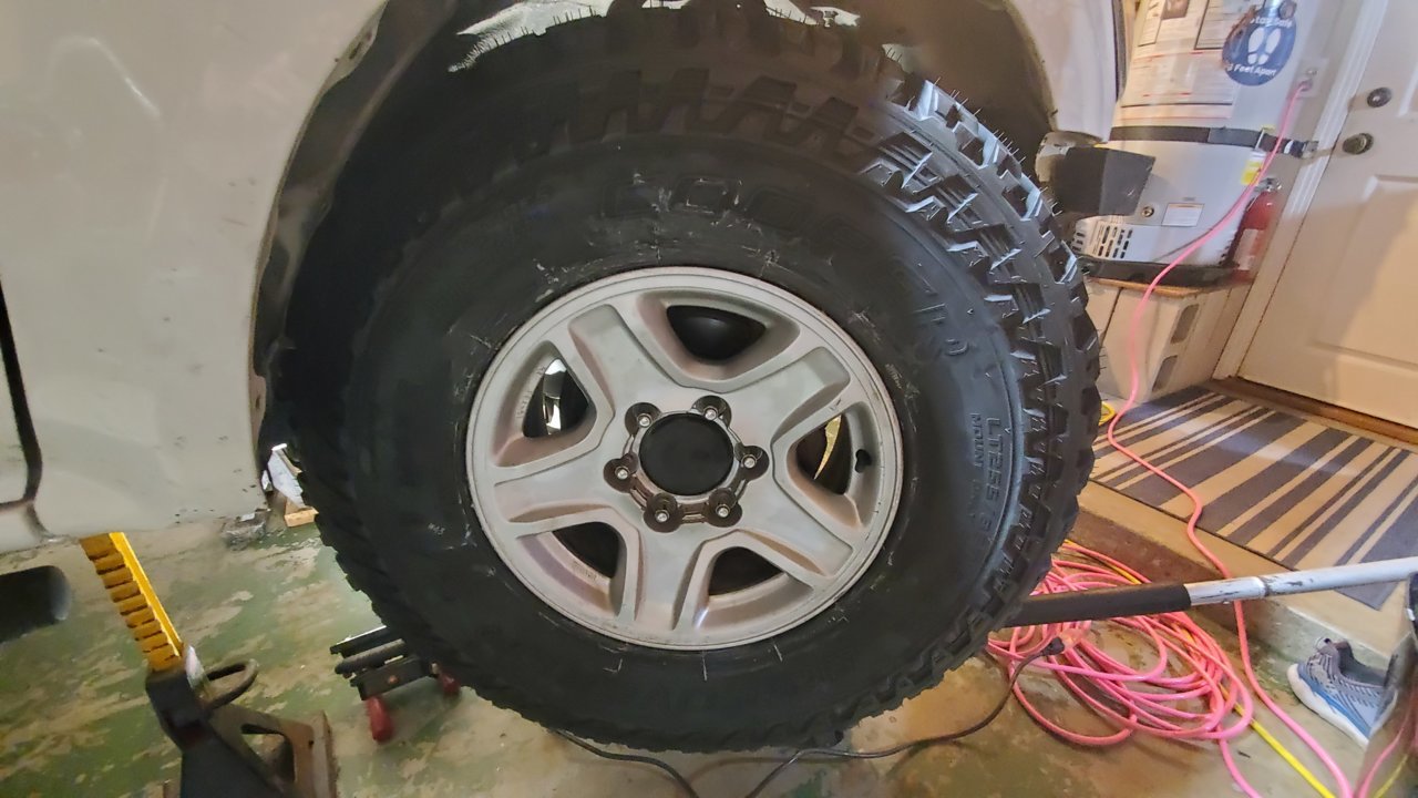

    Finally got some 33s on her.
    Lots of hammering involved, but luckily no cutting!

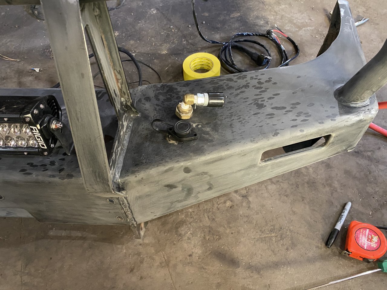

    Not very exciting, but I got my ungodly amount of electrical stuff organized today and decided to restart working on my bussman fuse box/switch panel project. Thus far, I’ve installed my switches into their holes and drank 4 beers trying to decide how I’m going to wire the switches and the LED’s. I bought dpst switches from otrattw and want to be able to have a constant 12v power supply for all 5 and a power supply for 4 of the switches that comes from my brights circuit and one power supply coming from my reverse lights.
    My big indecision has come from how I want the independent led’s to work. Thinking I’m going to have the bottom led that will illuminate the writing work and dim with my gauge cluster and my top led’s illuminate when the accessory is actively on.
    the first from the left spot will be for a spot beam light. Not sure if it will be pods or a bar yet. Unsure of what will go between the ditch and rear lights and also unsure of what will go in the #6 hole. That won’t be connected to a relay on the bussman box though, since there are only 5 relay locations.

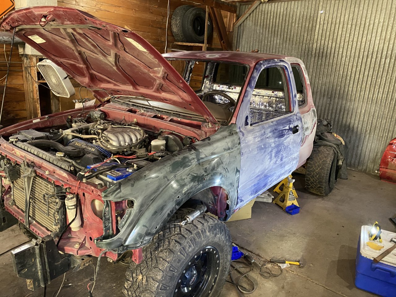

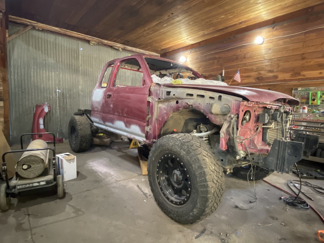

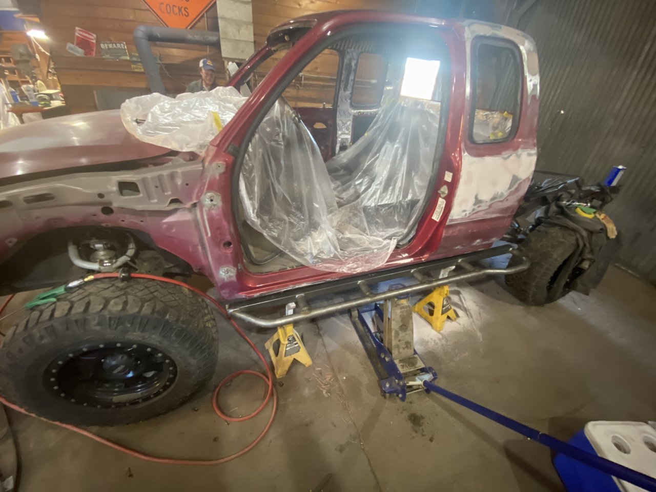

    Also, I don’t think that I’ve posted much of my progress on my repair recently, so here are a few photosA29693E4-8B1E-4582-BC5B-6BEBB00B0C93.jpg8AB4EEEE-4C98-45F8-924D-5440C05AF559.jpga straight door and a straight fender!CE8D6A1E-8834-4762-AD73-698418D42F69.jpgdrilled the holes for the winch remote relocation since the solenoid will now be under the hood to make room for the 20” rigid894E27E3-B13A-4399-8102-4D88E6223769.jpgthe 20” rigid in driving beam pattern465F6B32-CDAE-4A04-AE3F-1EA848984434.jpgmy buddy Joel trying to fix 9 years of no armor and poor driving6EF20F89-9C41-487B-A005-43343F1A40F4.jpgmy attempt at body workBACBB6C9-CE55-40EF-8945-7F8A077142F7.jpg 4x innovation rocksliders!7DDA5C9A-3326-4505-B874-856EDDFDC575.jpgebay” snorkel
