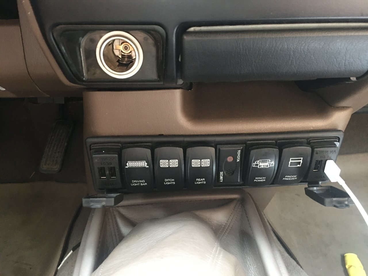

    @turbodb has some in his build that he prefers since they put out less EMI

    I've been through a few of these; here's my feedback:
    All of these fit perfectly in the cig lighter position or 12v accessory position. All charge USB well. #2 is the best IMO, but the most expensive.

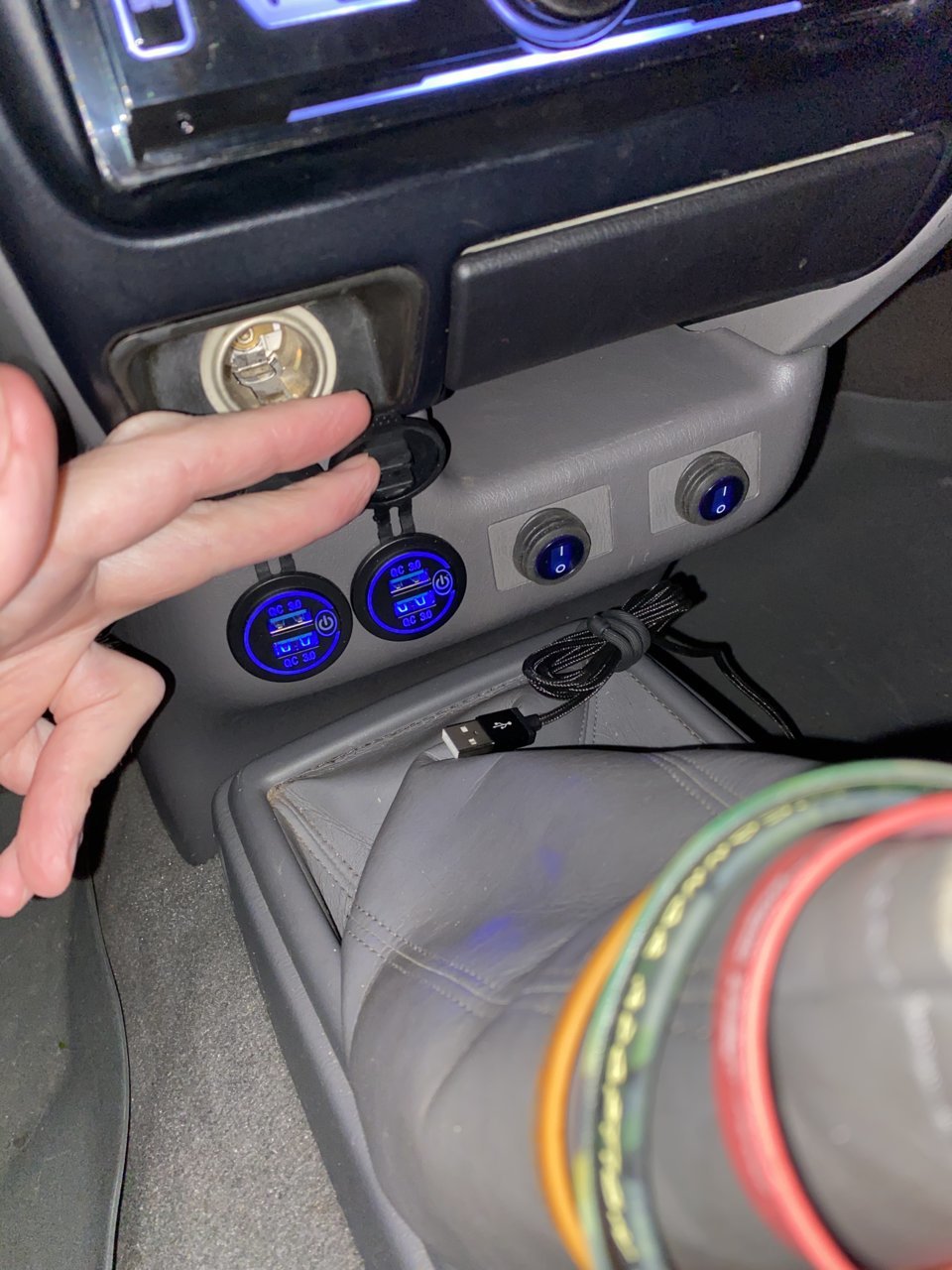

    very simple mod.
    Go to Amazon- get these.
    [2 Pack] 12V USB Outlet, Quick... https://www.amazon.com/dp/B089SNPYFL?ref=ppx_pop_mob_ap_share
    grab your dremel.
    Remove lower console and disconnect the power outlets.
    The connectors are L shaped, gray plastic connectors.
    Cut the gray plastic away revealing spades, one gold, one silver.
    I used shrink wrap and insulated them.
    Modify the two existing holes from the outlets using your dremel. You may have to sand down or remove some of the plastic from the back of the panel as well to accommodate.
    These USBs have a gold and a silver spade on the back.
    Install the USBs and then plug them in using the existing spades from the truck- gold to gold, silver to silver.
    Reattach the panel in the truck and you’re done. 1/2 hour at most.
    Clean and simple, no cutting, splicing or soldering.

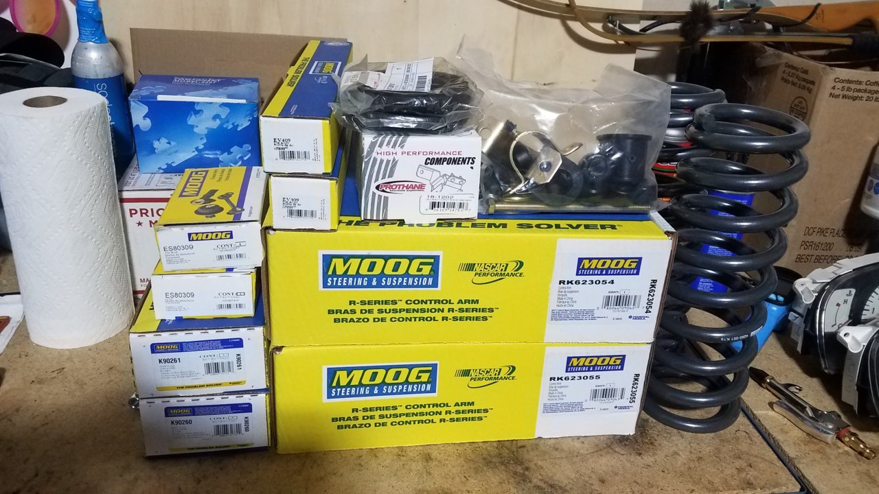

    This should be fun! Front end rebuild and Belltech 2/3 lowering kit.

    Aaaaah shit
    Edit: that lower control arm bolt is tight AF

    Probably gonna have to exchange that socket for a sawzall blade

    Nope, jack handle cheater bar FTW!
    The strut rod bolt is torqued to over 200 ft lbs so I definitely needed it for that too.
