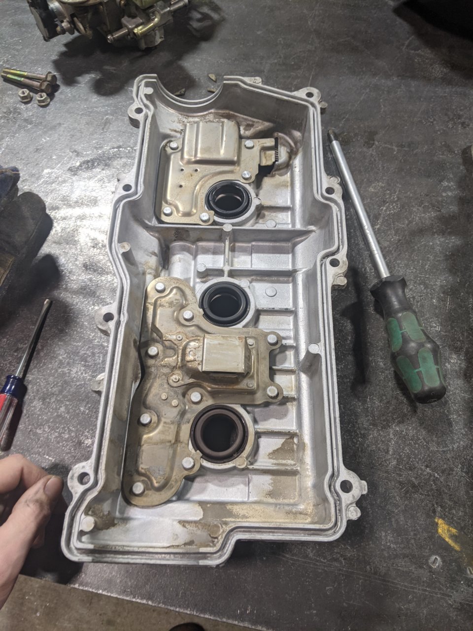

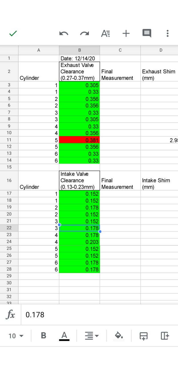

    Anyone have a 3.010 valve shim they wouldn't mind dropping in an envelop and mailing? Came so close to not needing to adjust anything!
    Parts washer at work is the shit! PXL_20201214_154445706.jpg PXL_20201214_194132135.jpg

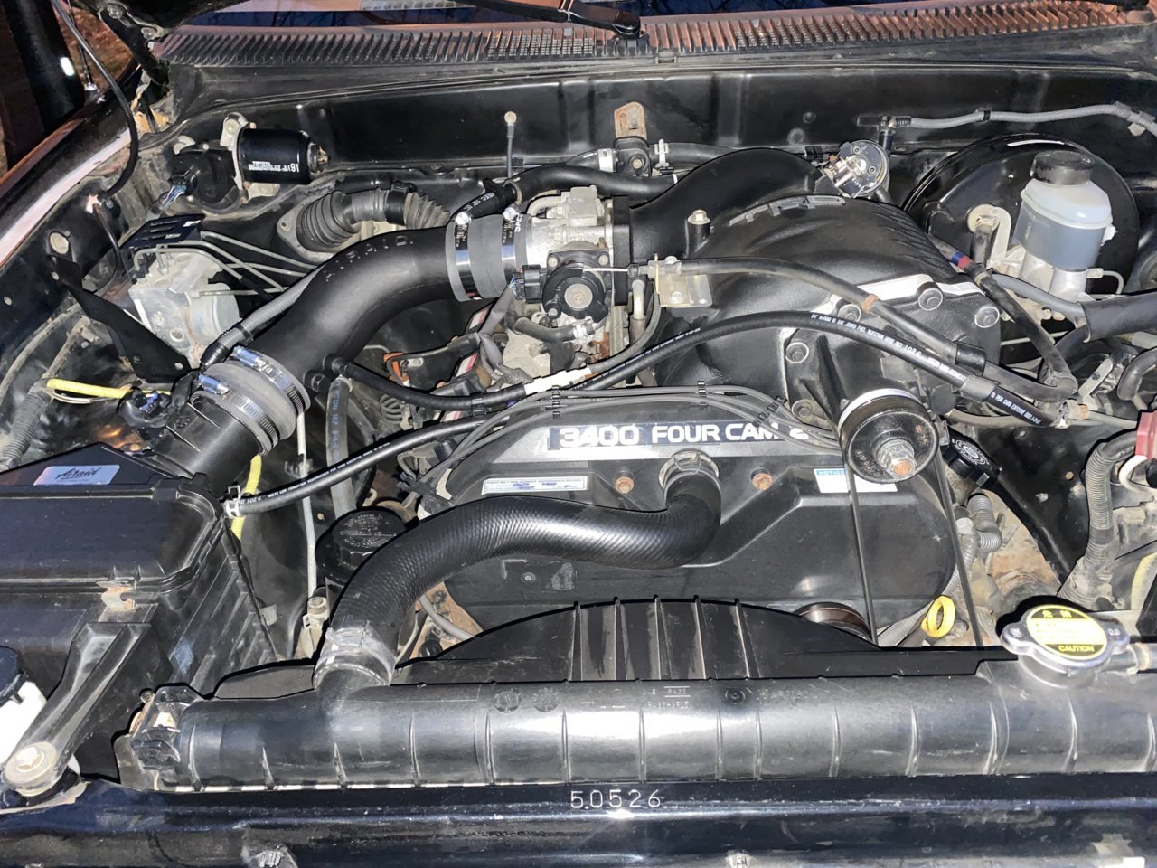

    I changed my valve covers and put everything back together with an annoing high idle.. turns out this was my problem. Can you see it??20201214_125633.jpg

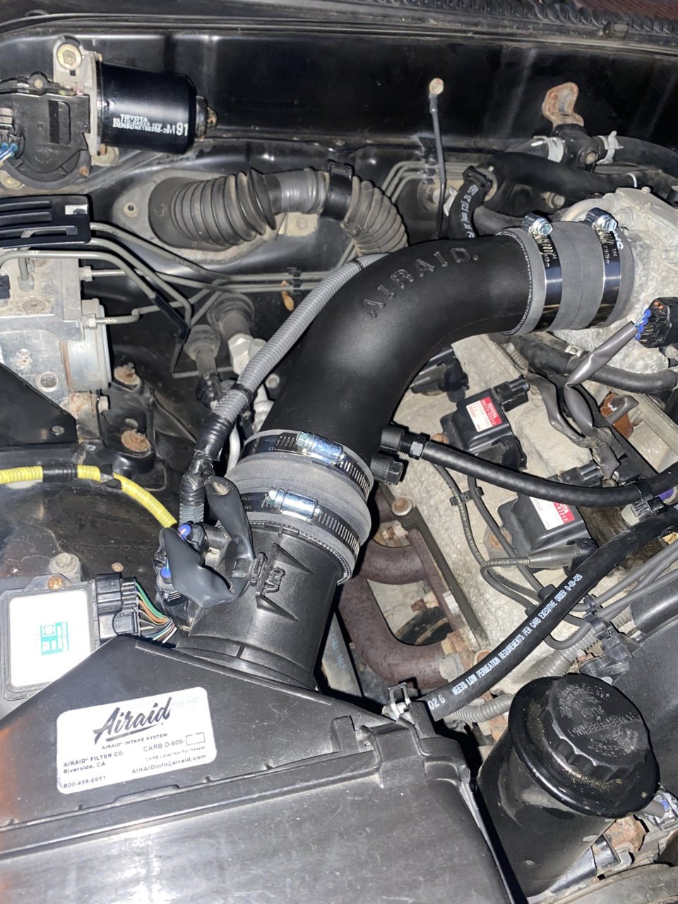

    EA2D558E-A0B3-4438-A276-63518DD57634.jpg Had to give in and buy this intake tube. Nevertheless it looks decent.

    I see a barb with no hose and a hose with a crack. :notsure:

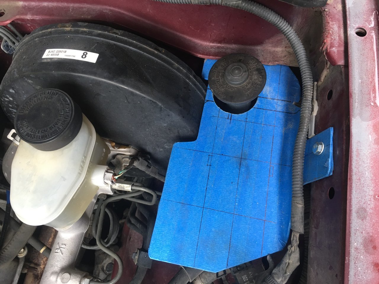

    There’s a fab business in Idaho saying he’s gonna weld up an see aux tank for that location this winter sometime. I’ll send you a link when I see it if you want.

    @Reh5108 in your pic that you posted, it looks like the one vacuum hose needs to be moved onto the one down below. I know that my truck has an open one on top of the engine, but I'm only guessing.
