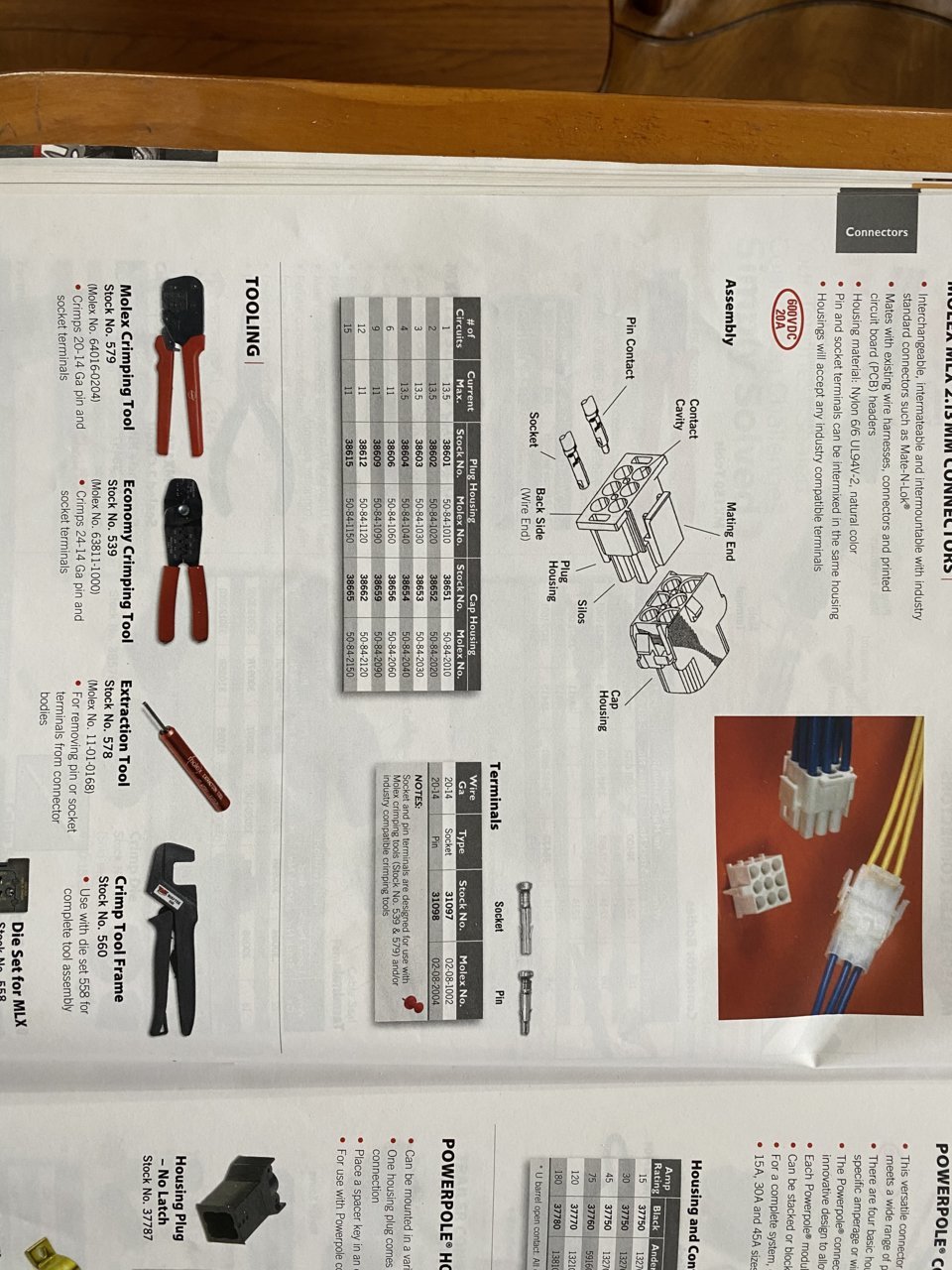

    I used the molex 2.13 series connectors for the harness end, but there are endless options. That series is a little bit bulkier, but will handle up to 13 amps in clusters of 4 terminals or less and up to 11 amps in clusters from 5 to 15, And the pins are universal between 14 and 22 Gage. just going to attach a picture from the Waytek wire catalog since there are a lot of options for that particular series, but I recommend buying stuff like that from Mouser since they don’t have order minimums.C33001E1-D9C1-4365-A395-96F39DE24B57.jpg I’d go on Waytek wire and get a catalog from them though. I use their catalog to get the manufacturer part numbers and then type them into mouser because the mouser site is a little difficult to use otherwise. I’d also recommend looking at Waytek wire if you plan on ordering in bulk because they are cheaper, but most of their stuff does have order minimums.

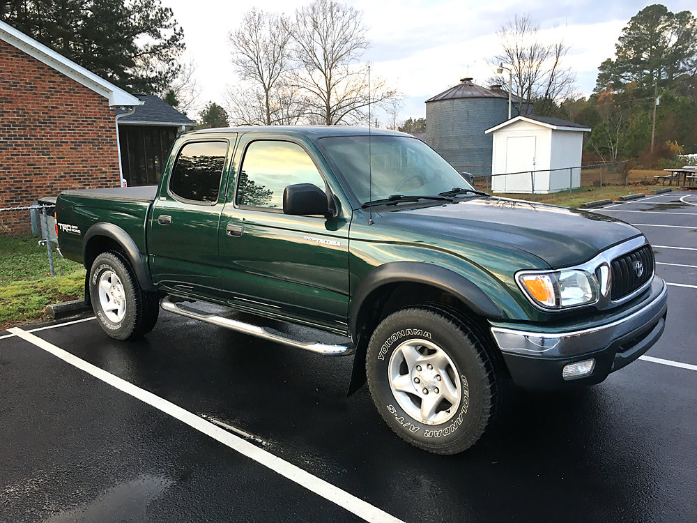

    Gave her a well deserved bath & spray wax.

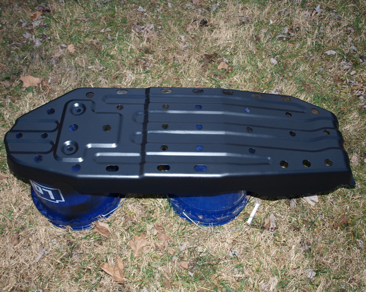

    I've currently got my bed removed and the gas tank dropped. Have been cleaning and painting stuff while I wait for more gas tank parts to arrive. Painted the tank skid today:

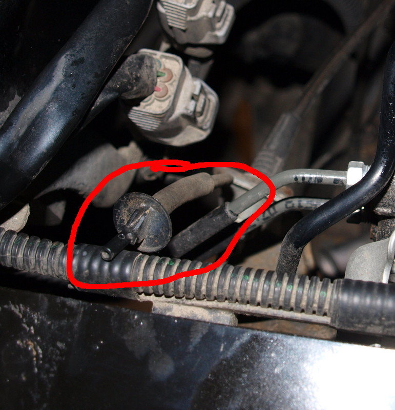

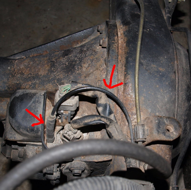

    Can anyone tell me what this wire/cable is for, and if it should be plugged into something by the frame? It seems to be part of the diff lock wiring harness, but my searching skills are failing me.

    Breather for the elocker actuator. Looks exactly how it shoud. :thumbsup:
