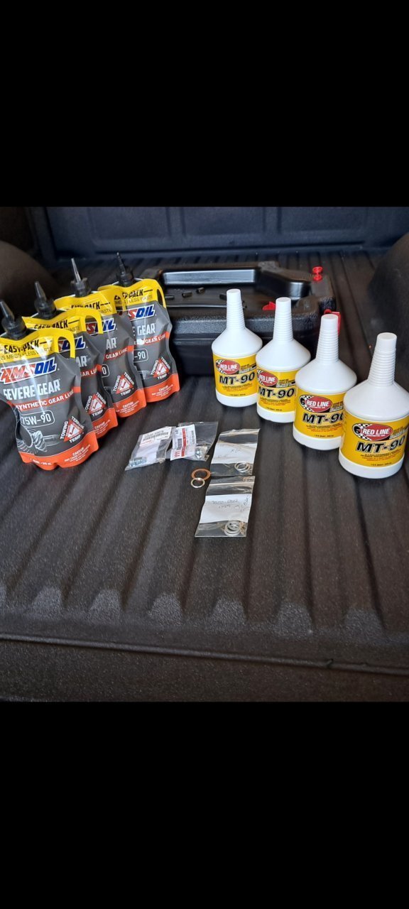

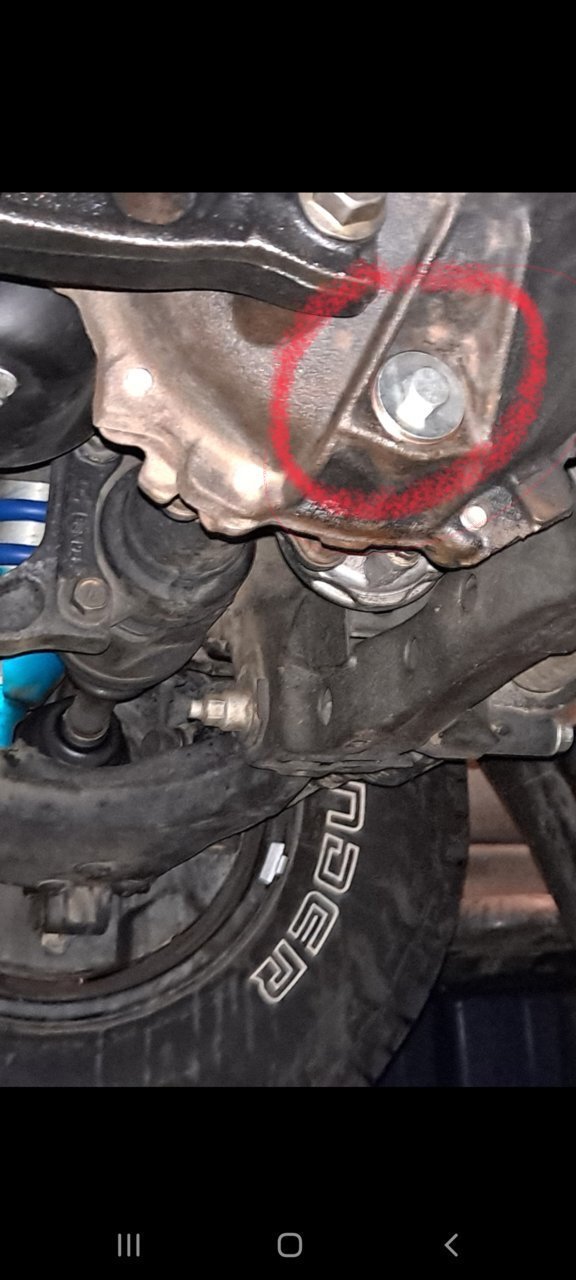

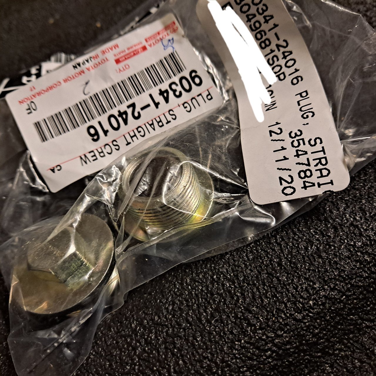

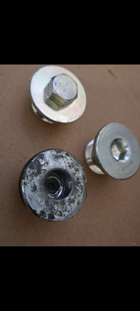

    So this should have been an hour job at the most,
    The Amsoil oil bags made this a super clean easy job, just pours in as you tip the bag upside down.
    I ended using the used Amsoil bag and filled them up with the redline and was so simple.
    Bye bye hand pumping the oil into the diffs and transmission.
    Rear differential was easy,
    Transmission was easy
    Tcase was easy,

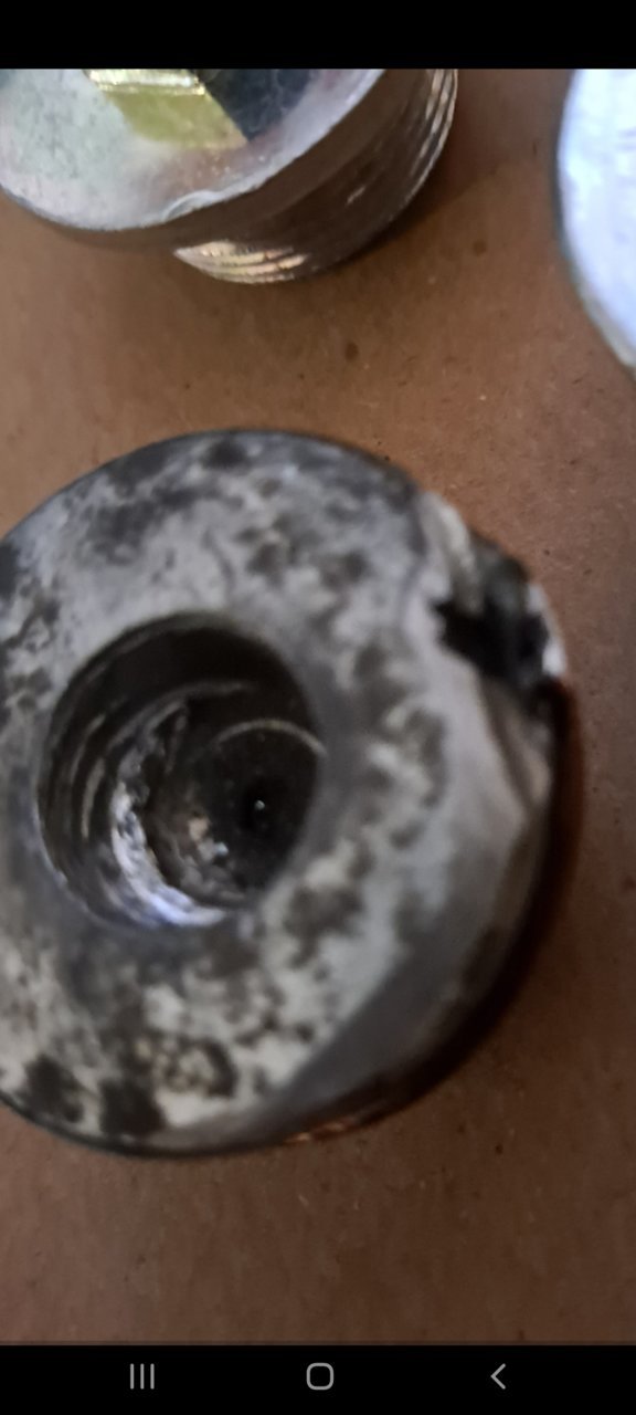

    Then we had that lower front drain bolt.
    It would not budge,
    Heat didn’t work,
    Pounding on it with a hammer for shock didn’t work,
    Used a 1/2” drive with the Allen key type head,didn’t work,
    It stripped it completely,
    Then tried a 55 torque bit and that stripped it even more.
    Tried drilling into it to use a reverse threaded nut removal tool.
    That didn’t work either.
    What ended up working was a large chisel that I used to cut into the drain plug
    and then used the other side that I grinded flat to use as an impact and a 5 pound hammer.
    WHY WHY would toyota use an Allen type insert key for this plug.
    Lexus makes the exact same drain plug with a bolt style head,
    The top plug on my truck is a different size than the drain plug.
    I think some are the same size top and bottom depending on the year
    Order a Lexus lower drain plug and don’t spend hours trying to remove the old stock drain plug.

    4 quarts redline MT90 were for the transmission and Tcase,
    4 quarts of Amsoil sever gear for the front and rear differential,
    The front crush washers are different than the transmission and Tcase and rear differential.
    You will need 8 crush washers total
    And at least one Lexus drain plug with the nut style headi

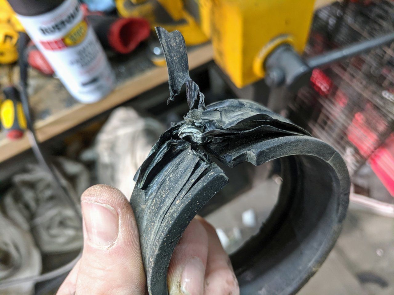

    The PO on my truck did the same thing.
    I got a tube off Amazon, $30 and done. Super easy repair.
