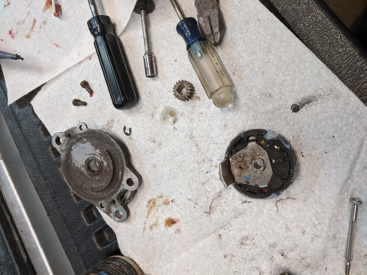

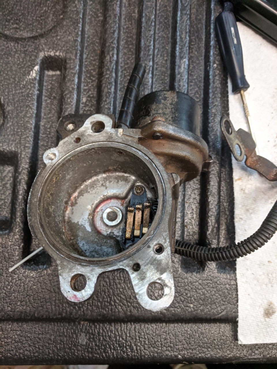

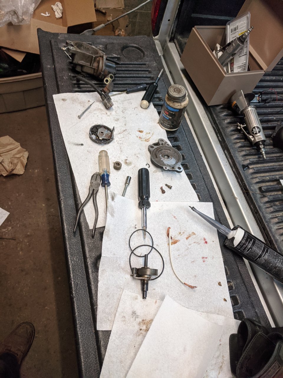

    took apart / cleaned & re-lubed and sealed my e-locker (it wasn't working) Now it does!
    Two things of note:
    - there are two small ball bearings on each end of the motor shaft, be sure you don't lose them.
    - the motor bushings could be frustrating to people as they can be a big hassle is to hold the brushes in place as you're putting things back together. I used a paperclip (but you could use a ziptie like this thread to hold things together) https://www.pirate4x4.com/threads/e-locker-actuator-rebuild.698966/
    This thread helps give a good overview of rebuilding one that is in worse shape than mine.
    https://forum.ih8mud.com/threads/locker-actuator-rebuild.551069/
    This thread was huge to help with making sure I had things back in the right alignment as i was putting things back together: (shout out to @nmiller08 thanks!)
    https://www.tacomaworld.com/threads/e-locker-actuator-motor-install.466058/
    my repair is not nearly as clean as the ones in a few of these threads, the o-rings in mine were kinda shot so I ended up resealing with 3m right stuff form in place gasket which is awesome and also means it may never come apart again but I think it should work for awhile.
    Oh, for those whose e-locker have given up the ghost:
    Toyota Tacoma, Part # 41450-35010

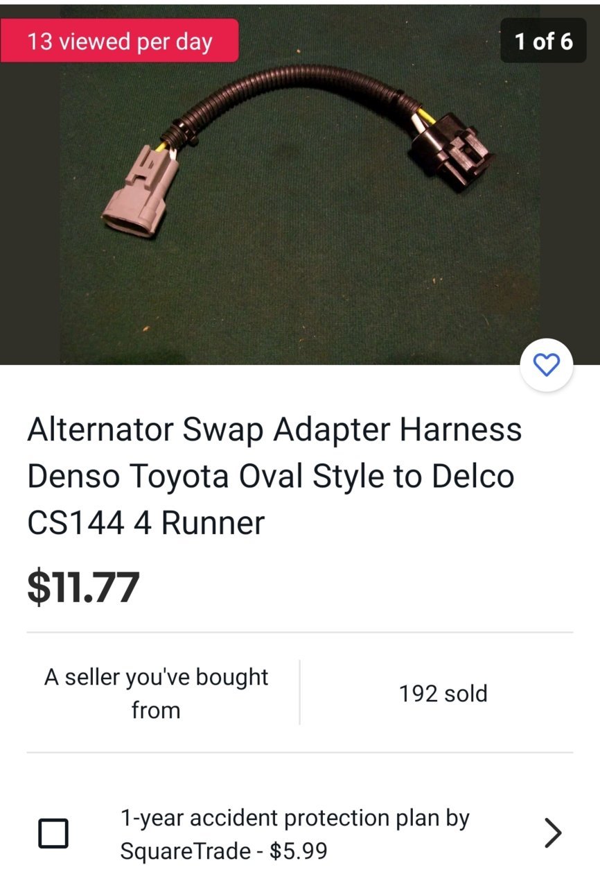

    Finally getting around to doing the Big 3 wire upgrade, and Cadillac Alternator. I'll be doing the A/C Idler bearing while I'm at it.

    Thanks for the reminder. I'm going to put my old S10 alternator in my Tacoma while I'm at the front end in the next month or two (next big projects: timing belt, and replace the LF inner and outer fender, radiator header, hood, radiator, etc, from a parking lot incident).... and then start a SAS......
