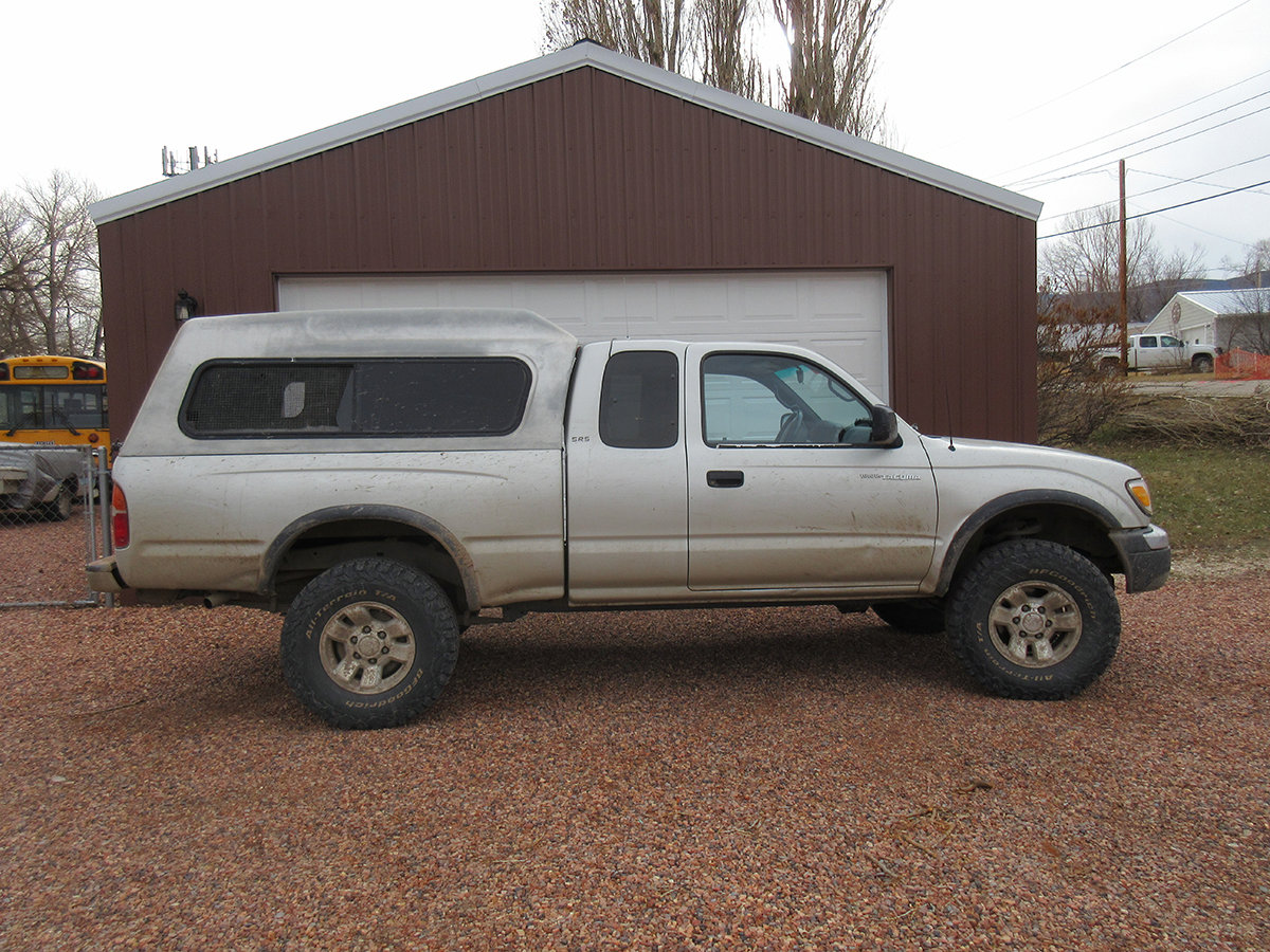

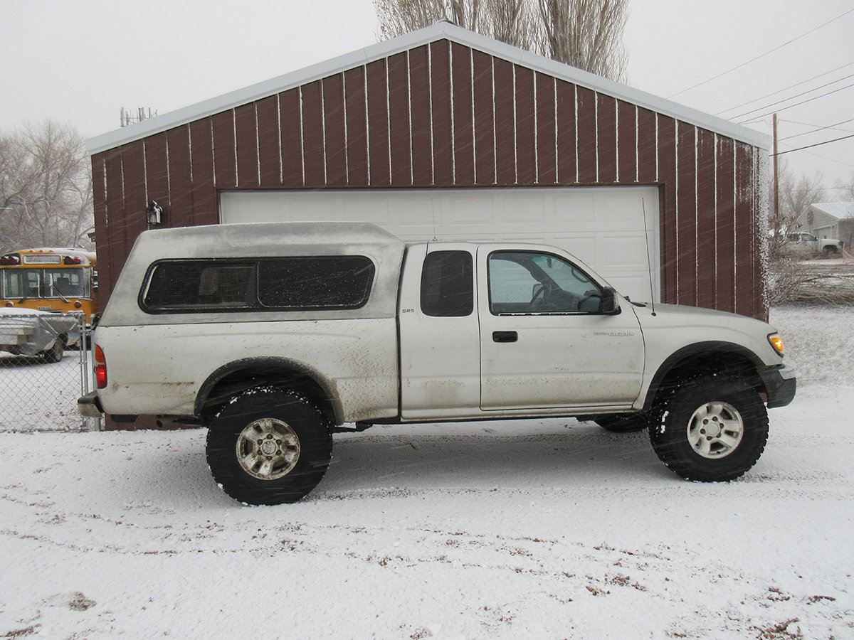

    I upgraded to 33's
    Before:
    After: (and just in time for the snow)
    They really don't look very different in these photos, but in person is does. That extra inch of ground clearance will come in handy.

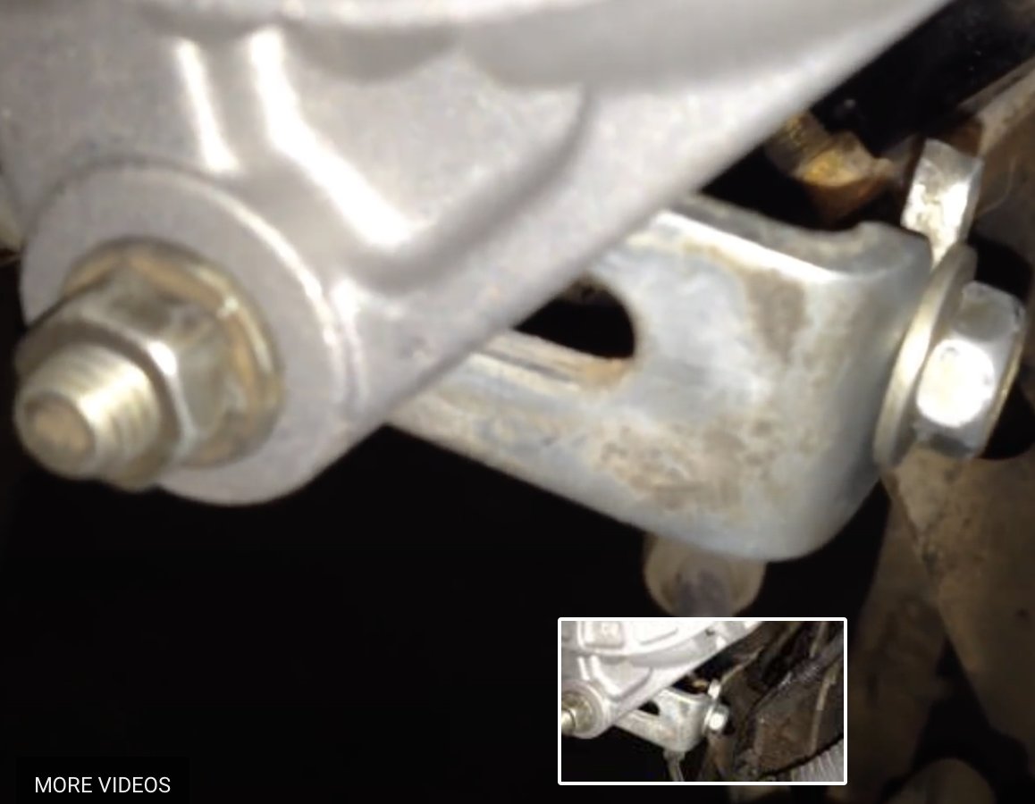

    I broke an alternator bolt today. Any one know how to source a set of these?
    Note: this is not my blurry ass picture... I borrowed from the google

    you sure you broke it and didn't just un do it all the way?
    or did you not loosen the to alternator bolts to allow it to move and actually torqued the head off?

    The long tension adjustment bolt is fine. The square "nut" and its associated threaded stud need to be replaced. I was torquing the alternator back down and it felt soft and just snapped.

    I think you can get that from toyota but it'll likely be the whole bracket just to get the bolt.
    Or cruise the part outs on here or junk yards

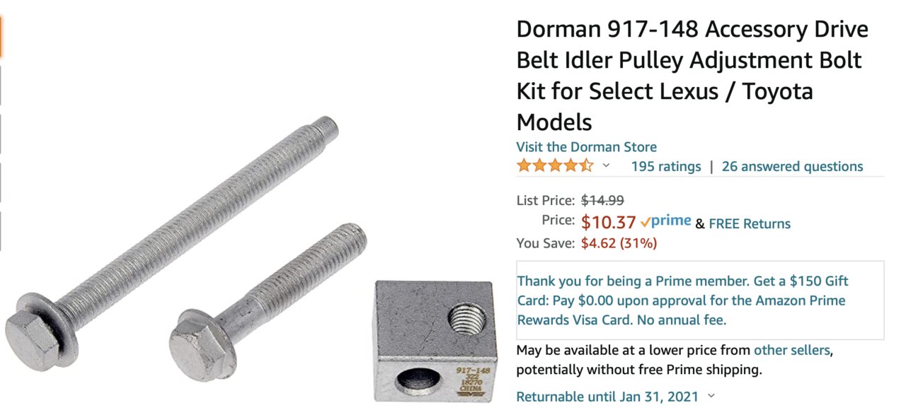

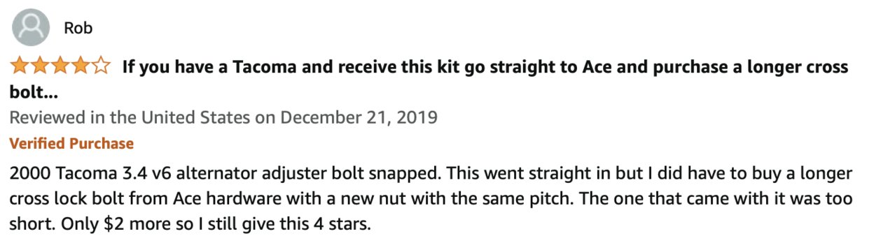

    A dude on Amazon says that this worked for him. They have these in stock at my local auto zone. I guess I will give this a shot. Based on his comment it sounds like I'll need a longer locking bolt. Worth a shot? maybe. Screen Shot 2020-12-23 at 12.00.02 AM.jpgScreen Shot 2020-12-23 at 12.00.21 AM.jpg
