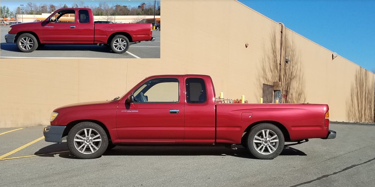

    FINALLY FINISHED putting the suspension back together!! All new MOOG parts - ball joints, inner and outer tie rods, poly sway bar bushings and end links, Belltech lowering springs up front and 3" blocks out back. It's not a huge difference but I think it looks much better and sits level. Rides and handles so much better too!
    Interestingly, the outer tie rod ends were still really tight. I could barely move by hand. The inners were shot. 3 of the 4 ball joints were decent but 1 of the uppers was toast.
    First time using a cut off wheel too. Stupid sway bar end links... That was exciting!

    Looks great, nice stance!

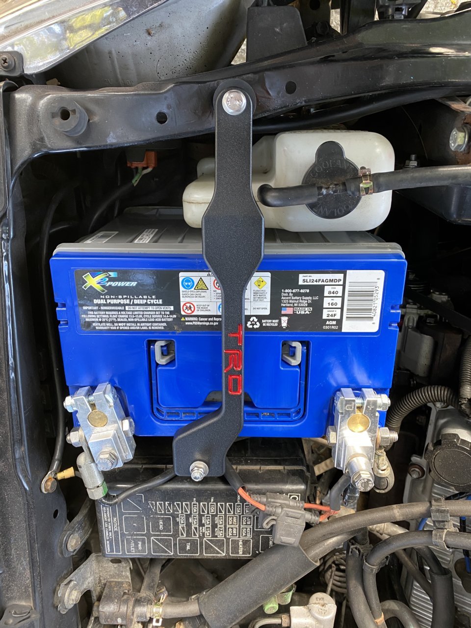

    Replaced one more eye sore. Battery tie down which I loathed with a passion. Thanks @Coupe! It looks great!

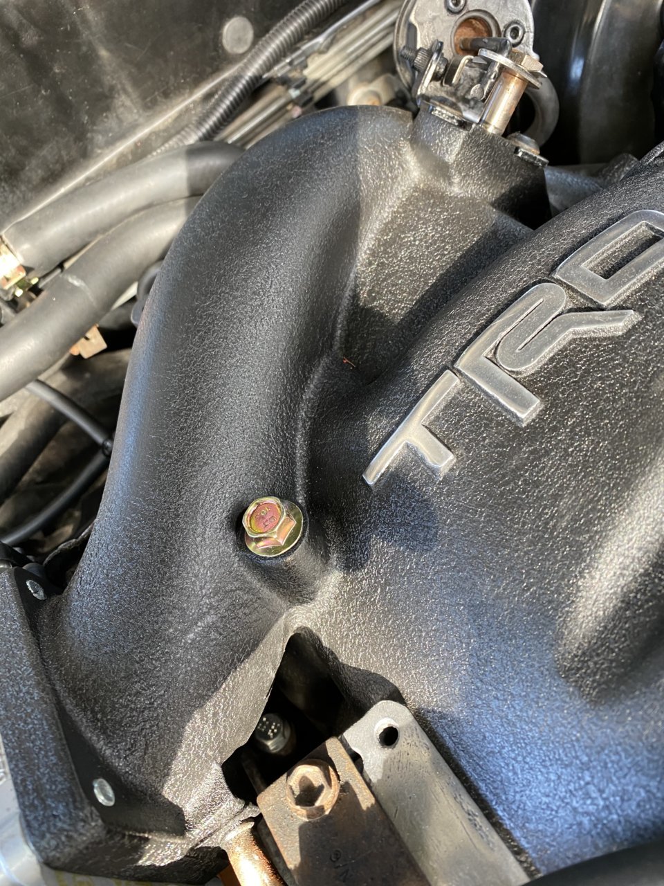

    Also replaced the long sc bolt which has been missing for 5 years, oops.

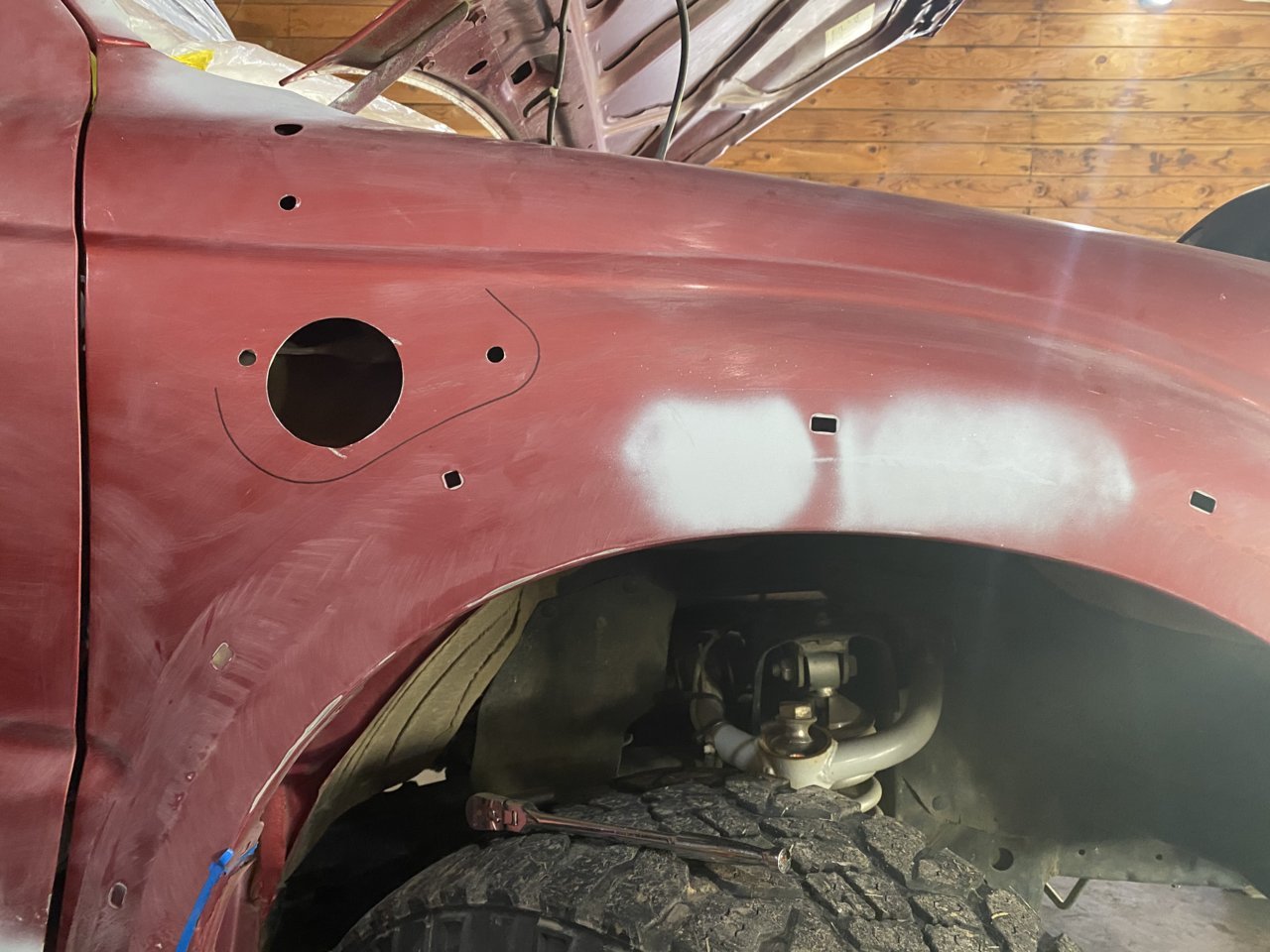

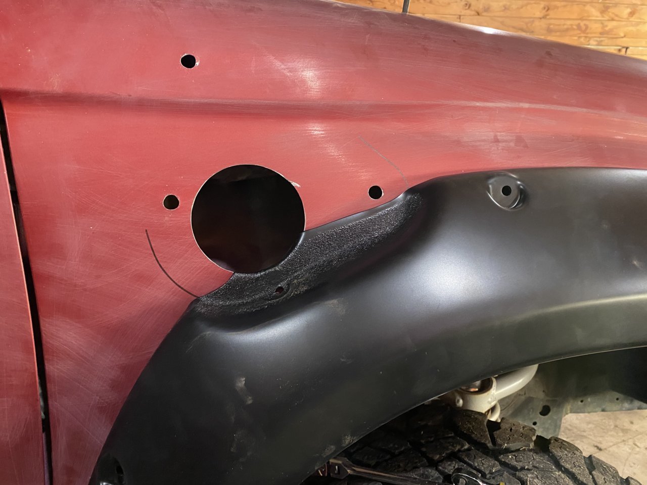

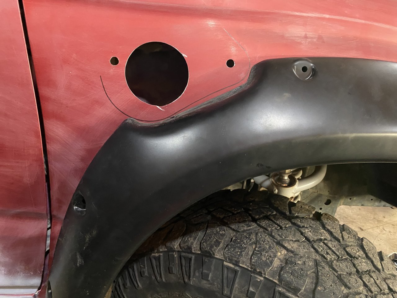

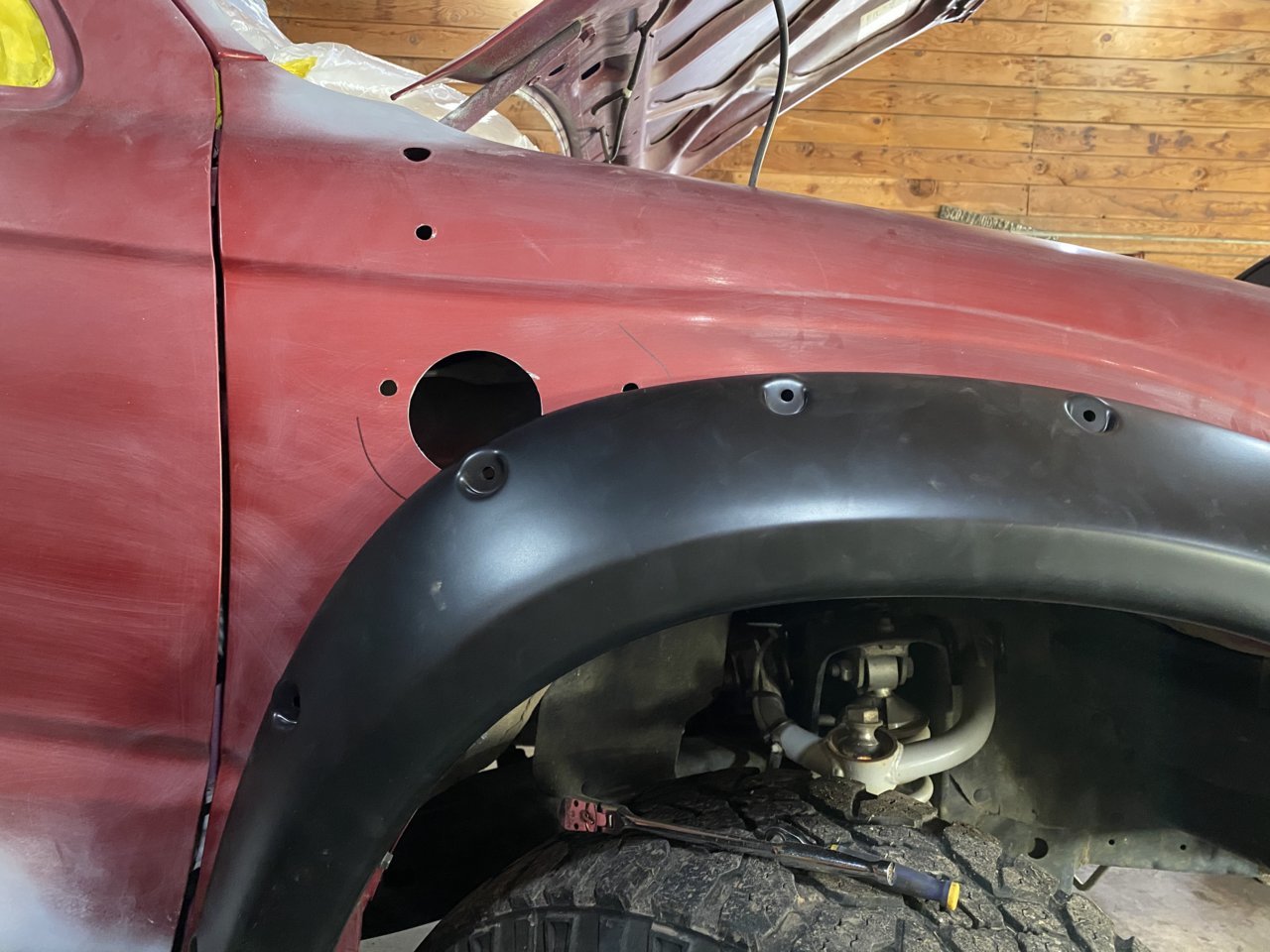

    Cut the fenders for bushwhackers today. Had to modify the passenger one for the snorkel. Turned out ok. Didn’t get a pic of the final product, but it’s a little bit better than that last picture.B416E6C0-A812-4717-B6DF-2C15C17DAC9D.jpgAA013E03-78D9-4AFA-8956-CB2D8BA28F18.jpgD06245E9-0372-4F72-BEC5-C1477DDD3C52.jpgCC538ED2-976D-460E-A042-207128D66177.jpg

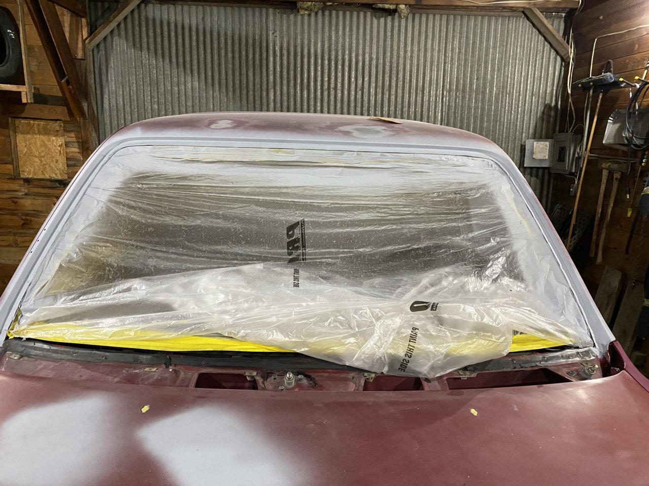

    There was a bit of rust around the windshield underneath the gasket material. Got that all taken care of and am going to paint that tonight.66BFA42E-906D-4424-9047-A35D5132C376.jpghopefully shooting raptor on Sunday!

    How did you contour the plastic so cleanly like that. Looks good!

    Took a heat gun and got the plastic hot, took the snorkel and pressed it in. Did a little bit of trimming and then heated it again, used bucking bars to mold the corners how I wanted and kept trimming. Did that about a dozen times before I was happy with it. Took me a good chunk of the day.

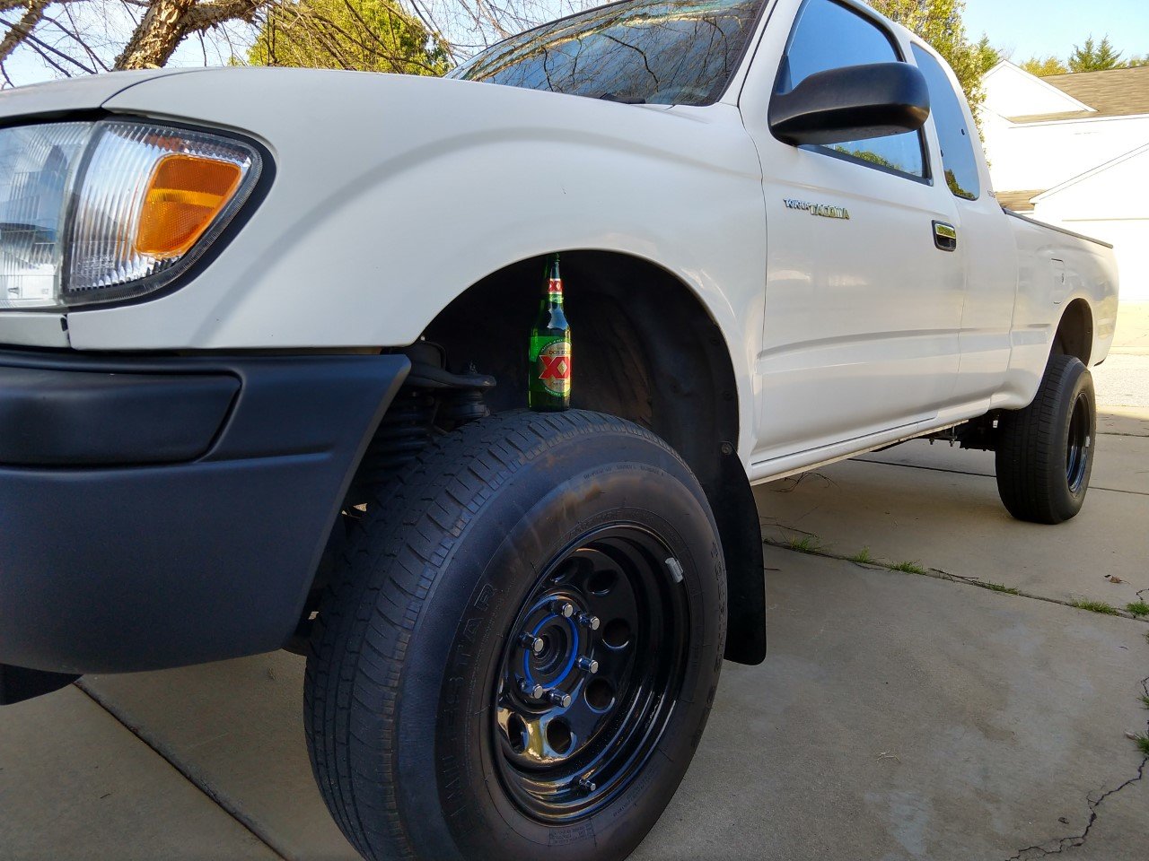

    2.5" lift, new struts/joints/inner/outer...ext shocks for rear at 210k

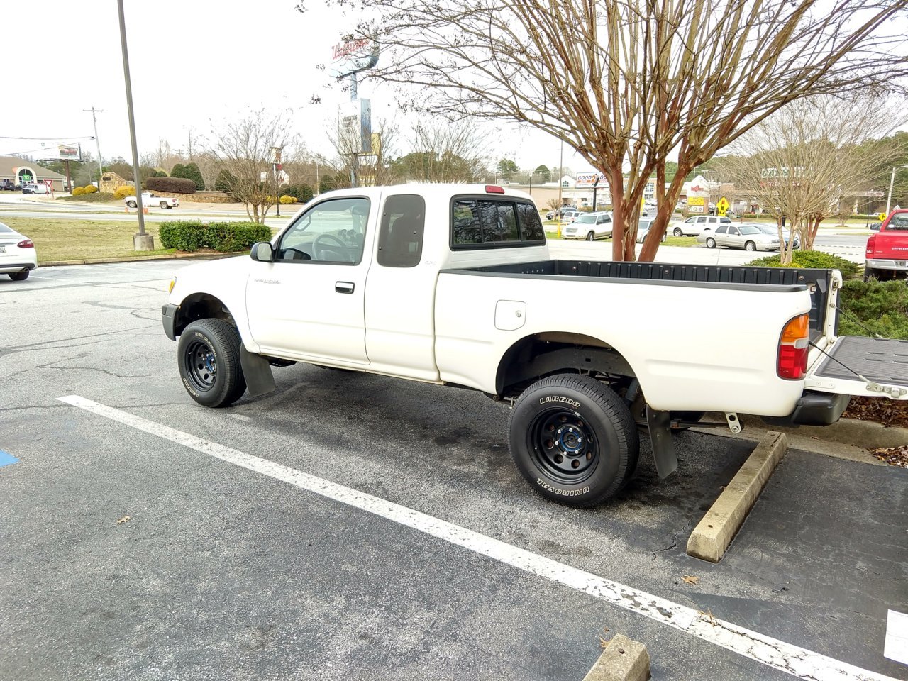

    daily driver...love it! (blacked out front bumper and rear chrome with flat black plasi-dip, just did full grill) will add grill pic later, with bar light, removed those goofy blue plastic "blue centering rings" etc..
